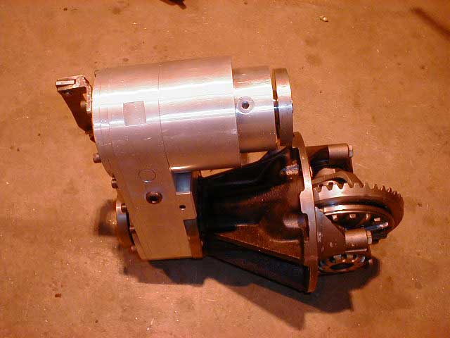

This Icecool E350 6x6 is on a setup as i told you with USA 6x6 transfer box bolted directly to the nose of the first rear axle. This setup can be made with a disconect, that is what they are doing in UK on the landy 6x6;)
Sorry, got it in my mind you were talking about this:
But yes the USA 6x6 thing is an option, but with more unsprung weight and some machine work.
I know this 9"..through shaft system but that is not what i was talking about.
Unsprung weight won't be that bad, especially when we talk of 38+ tires, unsprung weight doesn't count that much anymore:grinpimp:, we are not on a race car.
Some more, inlcuding the UK style for landrover with a disconect most rear axle
i am interested in the following ( attached below ) 6x6 wheeler accessories. please let me know how to contact you. urgently. looking forward to your reply.
^center diff between the two rear axles.
