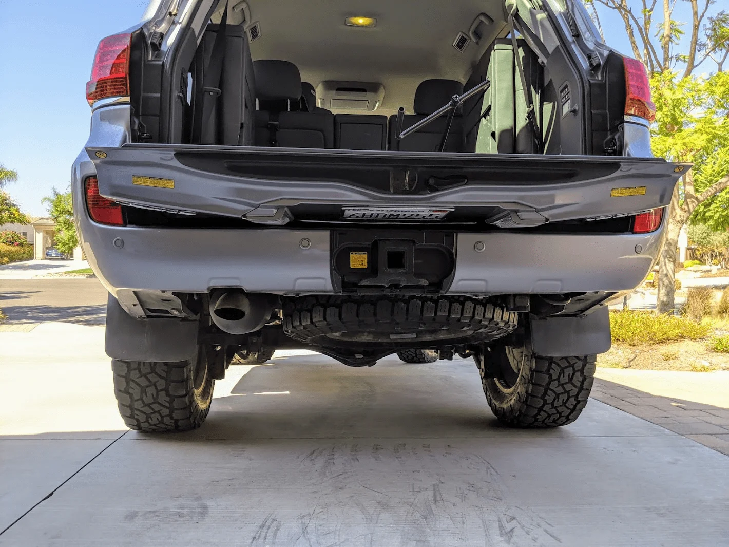

A bit hard to see here, but this is where I have my Hopkins receiver installed. You can make it out just to the right of the spare tire tucked in there.
IIRC, there's two existing bolts there but you may have to oval out a couple holes on the bracket.
Importantly, note that the Hopkins harness plugs into the stock wiring at the plug near the exhaust. Not at the corner nearest where the plug is located, even though it will plug right in. Outputs will be mis-mapped plugging into the wrong location.

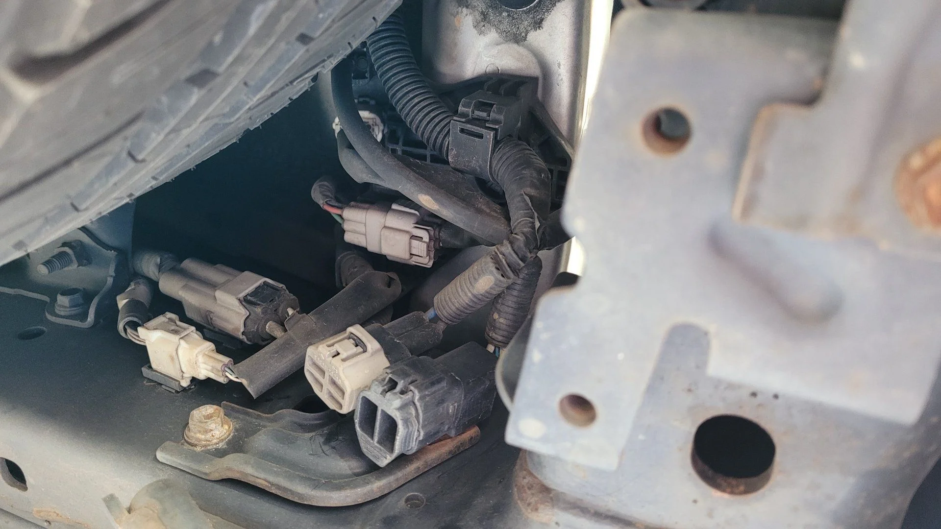

When you get a chance can you post a pic of the harness location you are talking about? You are talking about this spot right? This is rear passenger side.

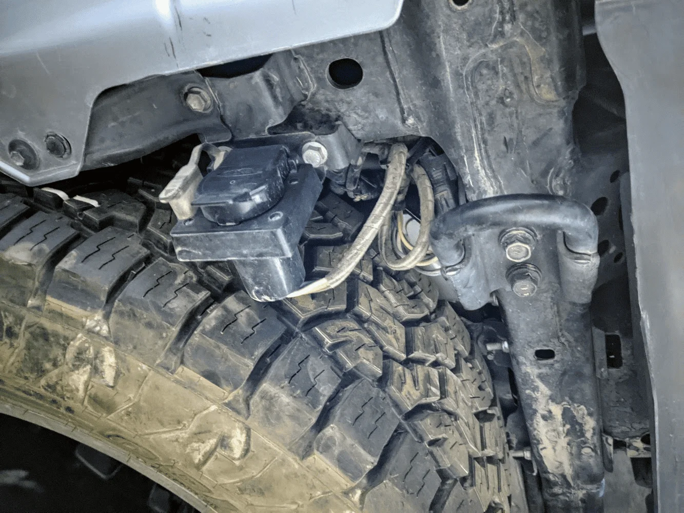

Here is where i tucked mine up. After i did the rear bumper it was the low hanging fruit. This spot is a bit of a pain you kinda gotta lay on the ground to plug in, but its so far forward it has kept it out of harms way on all trails I've encountered
Nope, not those. Unless Hopkins made a change. That is where it *should* plug in as the factory one does, but Hopkins did it differently. It plugs in upstream on that harness near the exhaust where it uses the same connectors, but with differently configured pinouts.

Just took this pic to help you locate the plug bracket
Ok. So it mounts same place just further up the frame towards the front.
