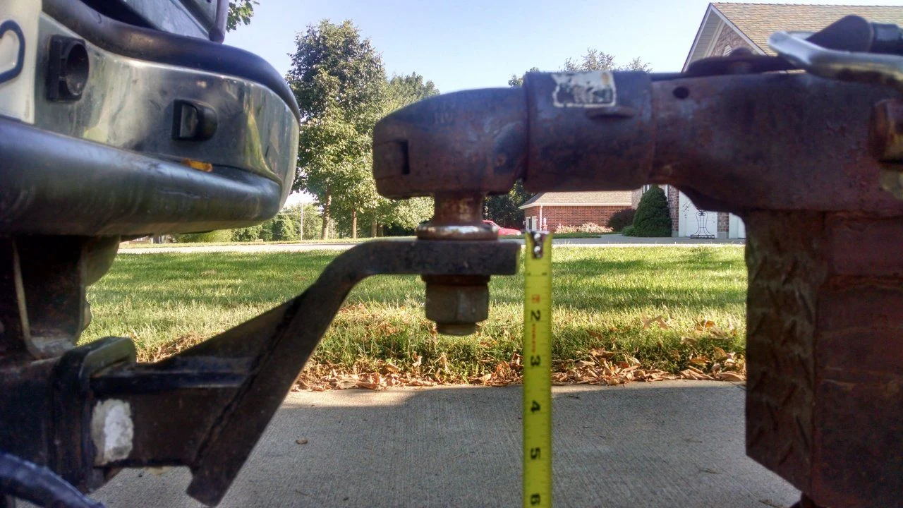

Got the 4Runner on the trailer. I need to do something about the ramps though. Or it may have to do with my daughter spotting me onto the trailer the first time. With the front tires pressed back to the front of the wheel wells, the young drop is 1/4 inch. Not to bad.
