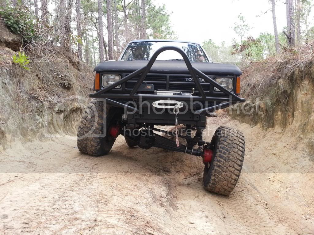

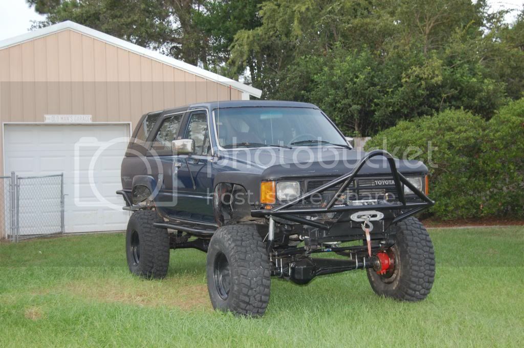

Maybe this will help, plus I like posting pics of my 4Runner :)
89 Trail-Gear 3 inch front and 4 inch rear, 33 inch BFG's, about 3 inches cut out of the front and rear fenders.
Total lift upfront a little over 6 inches.
Flexed
Maybe this will help, plus I like posting pics of my 4Runner :) 89 Trail-Gear 3 inch front and 4 inch rear, 33 inch BFG's, about 3 inches cut out of the front and rear fenders. Total lift upfront a little over 6 inches. http://s1280.photobucket.com/user/GuyHuey/media/Halloween2013012_zps184e26d2.jpg.html Flexed http://s1280.photobucket.com/user/GuyHuey/media/KFrB7Oh_zpsdc5926cf.jpg.html
Can you do me a favor? I've always wondered how much lift I have compared to a TG 3" lift.
Can you measure from the bottom of your frame to the bottom of the front spring pack?
