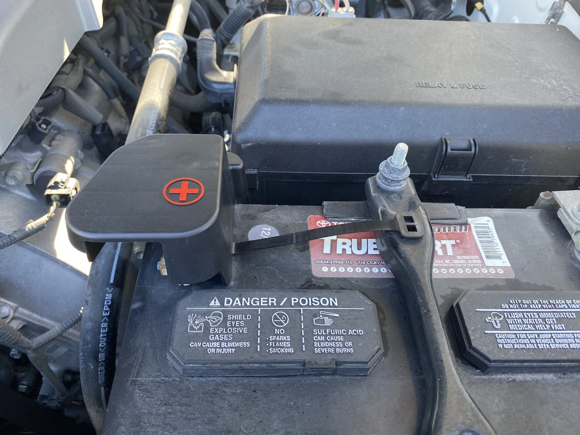

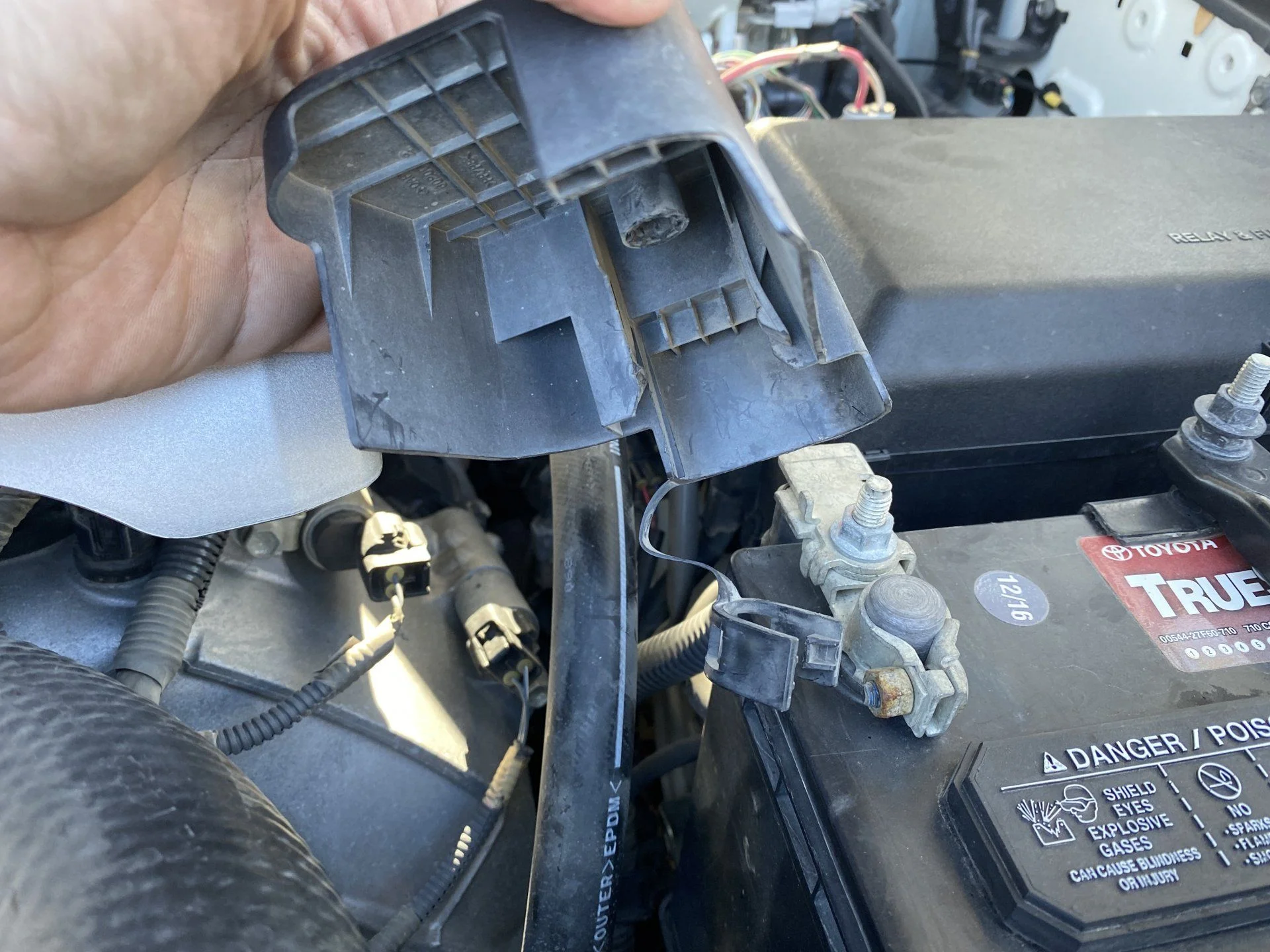

The large plastic cover on my positive battery terminal had a habit of popping off lately, and looking at it I noticed the retaining tabs inside were permanently bent outward reducing the tension. So I looked up the number and ordered a new one.
When it showed up I noticed it had a different retaining strap and at first couldn't figure out where it attached.. then I noticed a hole in the battery tie down and realized they really improved the design.
New cover, part number 82821-60200
The strap on the old design was retained along the positive battery cable and actually contributed to pushing the cover off the post and letting it rattle around next to the engine:
Those of you with older higher mileage trucks but still the stock size battery and mounting might benefit from this update. It was only about $13
Thanks. Good to know. Mine is all loose goosey and doesn't stay put.

Might not have been the dealer, they tend to try to commit suicide on their own once those tabs flex back. I think the airflow from the fan when it gets ripping doesn’t help.
