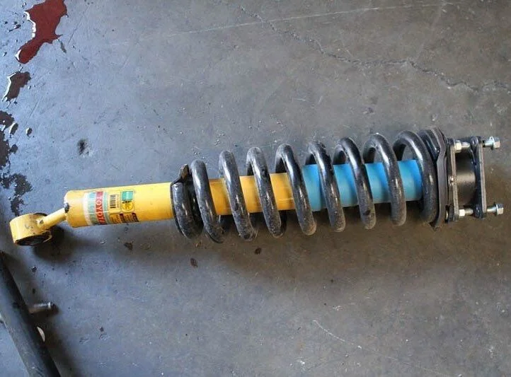

It’ll fit per say. But pay close attention to the preload it will put on the strut assembly yielding to much stiffer ride in the front and is the usual cause of this:
Has that happened with the OEM 10mm spacer?
I doubt that’s 10mm thick on the picture I posted. And owner probably jumped his truck causing this damage on the strut neck.
That was kind of my point. OP asked about the toyota part and while it’s obvious what is in your picture can lead to damage, I’m curious if anyone has ever had problems caused by the OE toyota part specifically.
Negative. The Toyota spacer does not effect preload the way they are installed. They are simply a shim on top of the coilover assembly, rather than effecting any pre-load of the spring, like a adjustable coilover perch might do.
The failure in your pic is much more likely due to overstacking spacers, such that the coilover is too long and becomes the compression limiter. Normally the bump stop in the lower control arm is the limiter.
Not sure what’s in your photo, but that is not the Toyota strut spacer.
