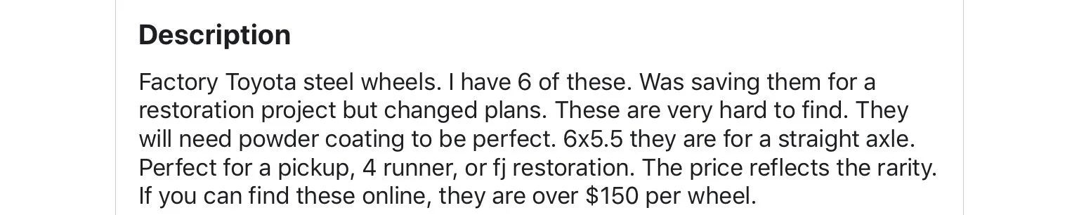

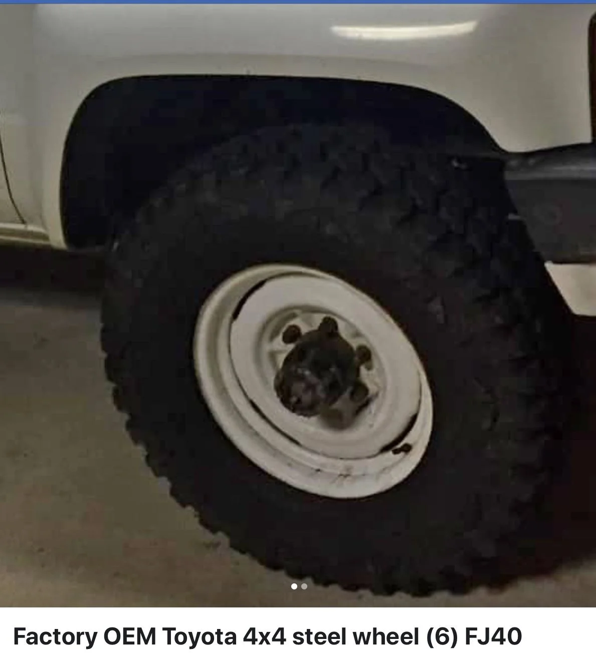

Toyota Steel Rims on a 1991 LandCruiser will that work. I can purchase 6 of these for 400. Thought it might look more classic than the aluminum

Would probably work on a 91-92. Will not work on a 93+
Not really, just a preference based on looks for most people.
Some say you can fix them with a big f'ing hammer if you bend the rim on a rock. :hillbilly:
Those are minitruck rims. If you want a nice 5.5" rim, you can buy a '78 FJ40 rim (with hubcap clips) for ~$125/ea at the dealer, brand new.
