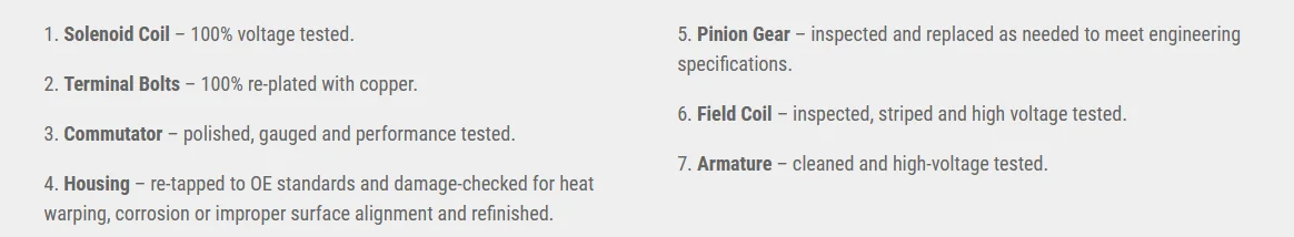

According to Denso:
Features & Benefits:
  • High-voltage tested armature and field coils to ensure reliable performance
  • Premium copper terminals to ensure a clean source of electrical current
  • All-new bearings, brushes, and seals

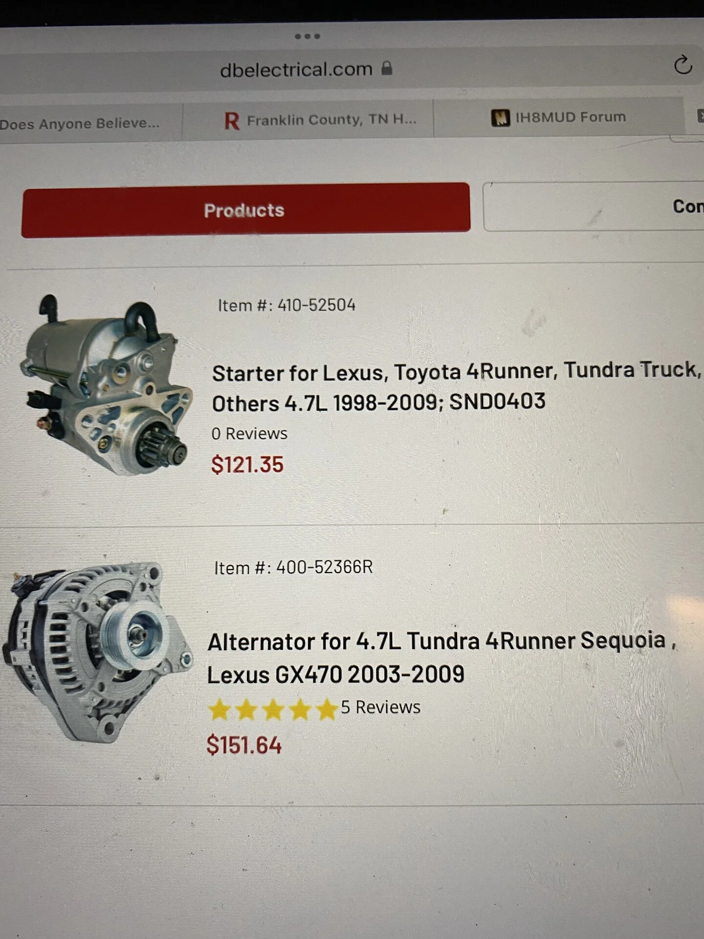

D&B Electric new.. I used one of their new starters on my daughter’s G6 and was rather impressed with the results,not to mention the price.$75 vs $200 for a rebuilt locally…Considering buying these for spares.

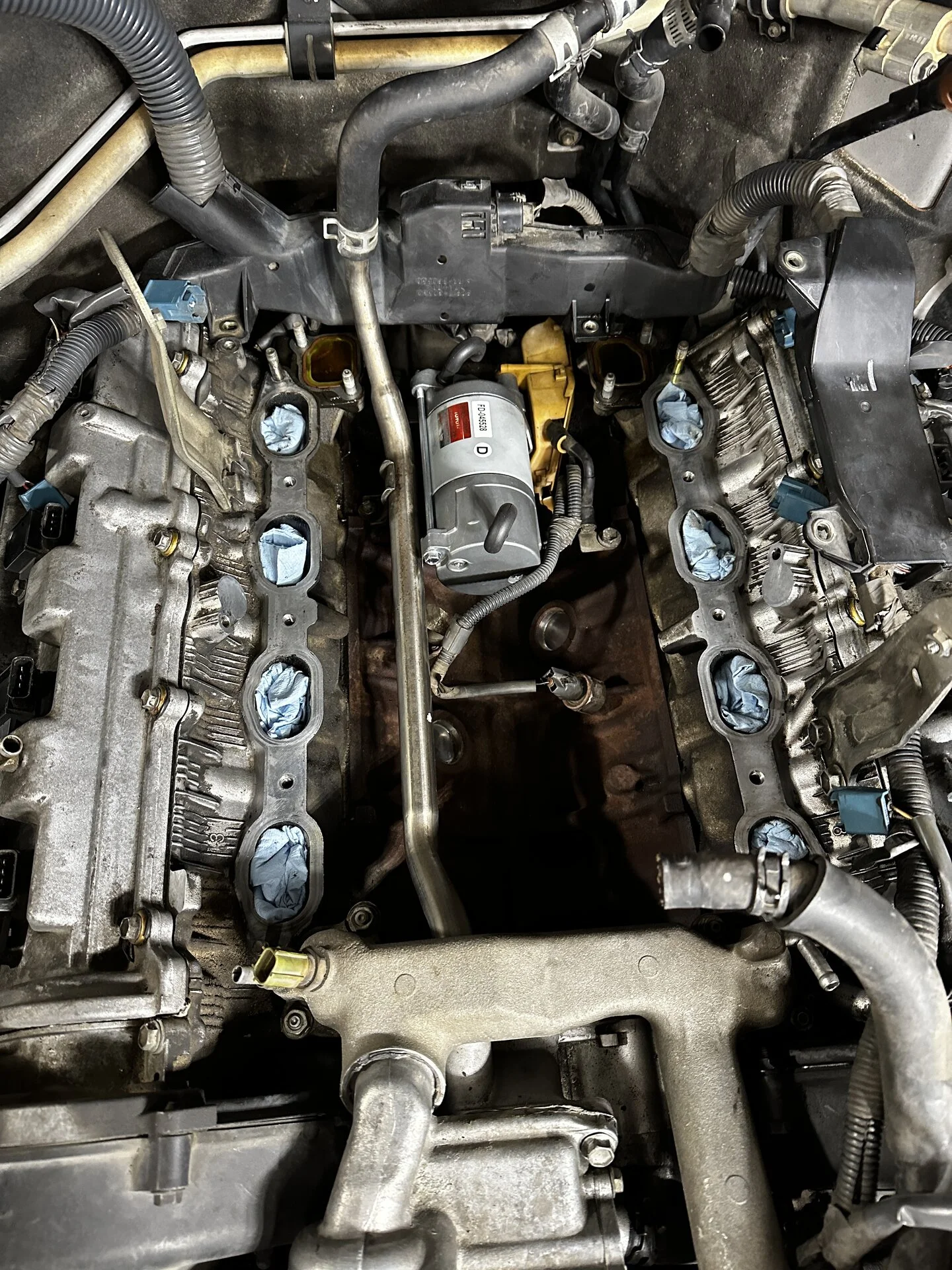

If the starter was hung under the header or by bell housing with easy access, installing disposable whatever brand prob makes sense. Because the starter is a colossal PITA to get to under the intake-at the firewall, installing the most durable- reliable component makes the most sense (to me).

Denso only specifies that they replace certain items, they don't say what they replace it with (supplier) or that it's OE quality. Toyota replaces with Toyota parts. Also, from your same Denso site:
They specify for many things that they only inspect, clean, and test a majority of the internals.
