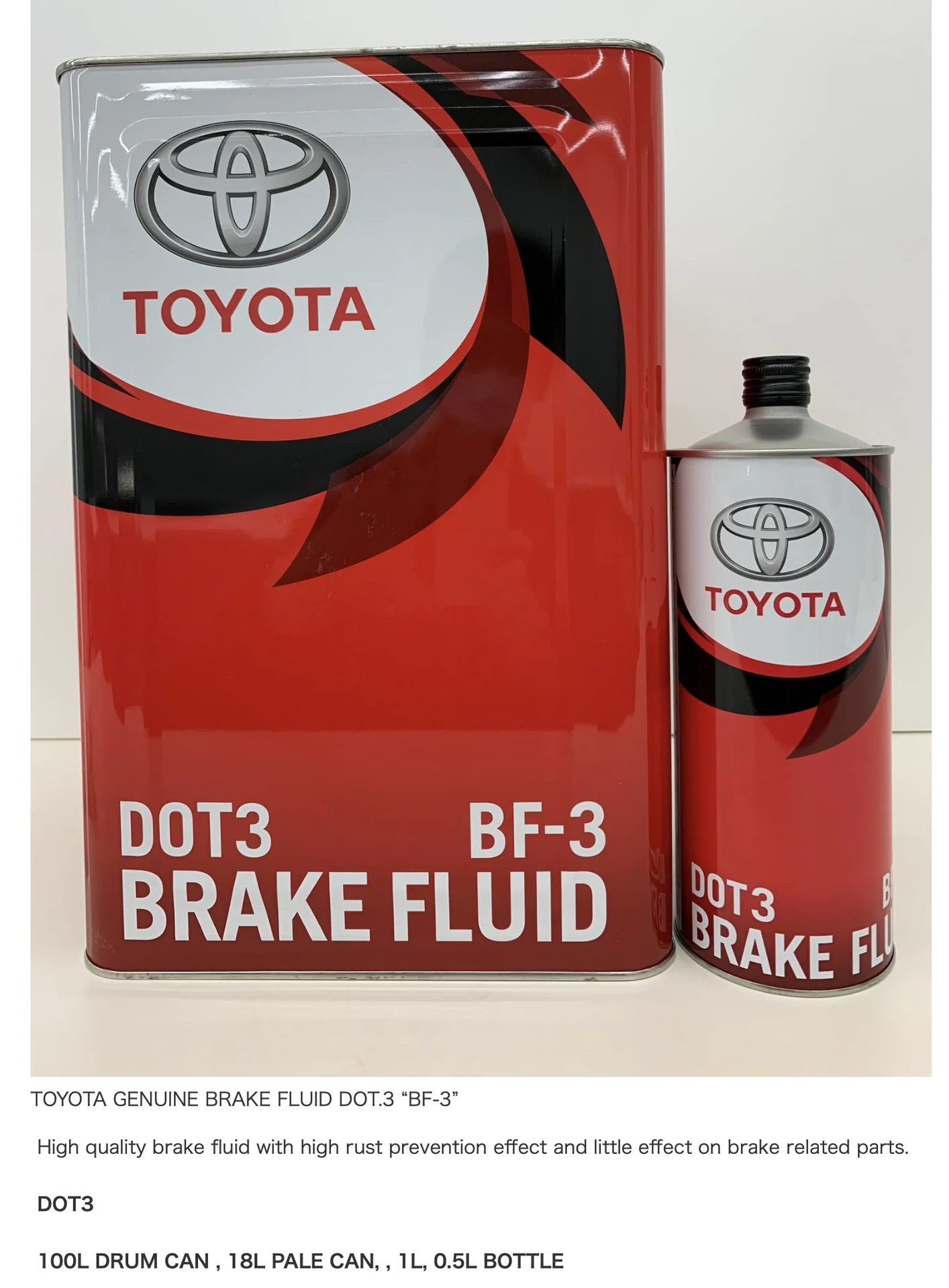

Toyota DOT3: 00475-1BF03 is the US manufactured brake fluid that is only available in 12 oz bottles, unfortunately.
In Japan... here comes some brake fluid porn... haha...
I believe this statement to be true for both Toyota Oil and Brake Fluid.
"Japanese O.E.M. - oils under the Toyota brand, as well as oils under the CASTLE brand for the domestic market of Japan - are produced under a contract by ExxonMobil Yugen Kaisha Corporation (original Toyota oil is produced at the same plant). Castle is a retail brand of TACTI, which is a wholly owned subsidiary of Toyota. TACTI Corporation (Toyota Aftermarket Creating and Trading Incorporated) was founded in 1996. The founders are: TOYOTA MOTOR CORPORATION - 80%, DENSO CORPORATION - 10%, AISIN SEIKI CO., LTD. - 10%. The CASTLE brand was created in order to expand the customer base in the post-warranty car service market. Consequently, the same oil is filled in cans under the Toyota brand and in cans under the CASTLE brand. In Japan, Toyota oils are sold mainly through authorized dealers and in large packages of 20 and 200 liters,"
Do you know if and where can be bought and shipped to USA?
