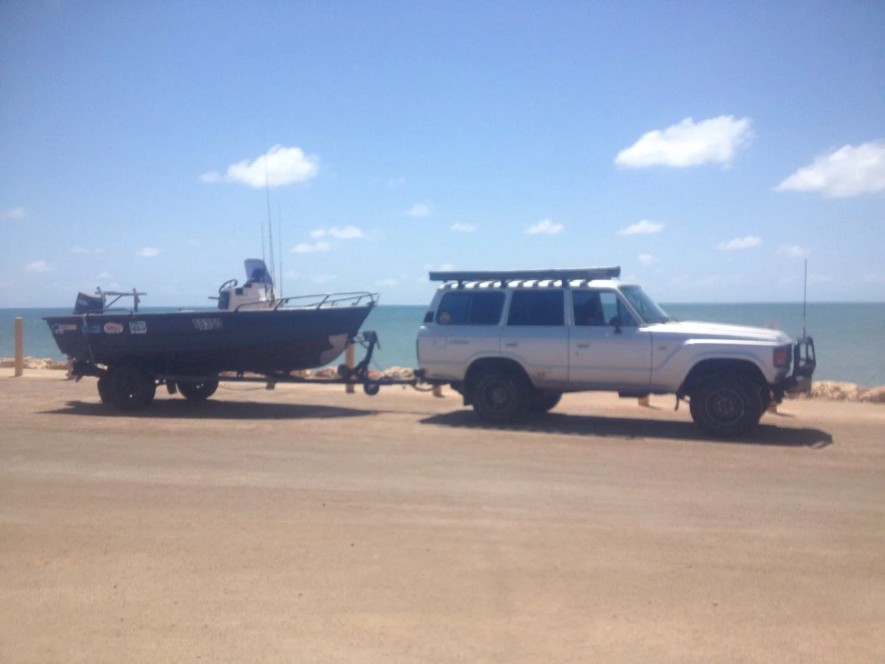

Well, we made it to Exmouth! The 60 performed better than I could have hoped! The boat came in at 1 tonne empty, and we managed 90 - 100 km/hr the whole trip up (except for hills!!) and used 16 - 17L/100km the whole way. It tows the boat easier on the 4x4 tracks than the 100 series, and didn't use a drop of oil. We have speared and caught some nice fish and still have 5 days before heading home. Will post some pics when I get back as limited bandwidth here... Loving the 60!!!
We made it there and back! Straight into a 20knot head wind on the way back for 1400k's wasn't fun! Used 19L/100km the whole way back... Here are a couple of car and spearing shots...

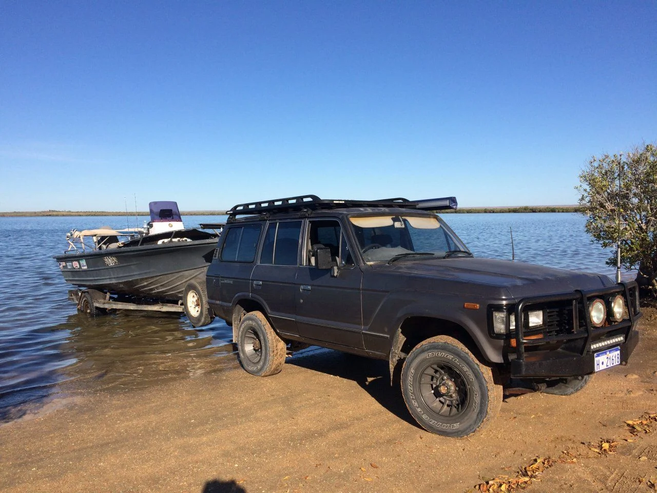

Hi guys, just a bit of an update.... At about 2:30 this morning we returned from out annual family camping trip to Exmouth - but this time in my 1988 Hj61 factory Turbo Diesel... What a difference!!! I averaged about 14.5L/100km sitting on 100km/hr with more of a load than the previous trip with the 2h. The car didn't feel stressed at all, and was a pleasure to drive. This was the 4th trip in 4 years with a different car each year, and this certainly is the best tow vehicle of all that I have towed with ( hzj80, hdj100 - with a 4 speed auto, hj60, 100 series petrol - 4 speed auto, and a Holden Captiva auto - but that doesn't count....). Near are some photos...
