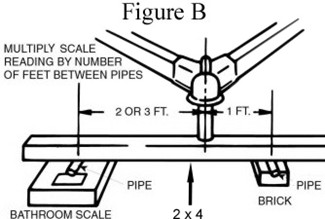

It's possible to calculate the weight without buying an additional scale. You just need a 2x4, a brick, a tape measure, and a regular bathroom scale. See the "bathroom scale" technique at Determining Trailer Tongue Weight | etrailer.com:
Bathroom Scale
You can use a bathroom scale and a box to measure tongue weight of smaller trailers. Place the coupler of the loaded trailer on the scale at normal towing height (Figure A). For heavier tongue weights, use the second method (Figure B). Be sure to perform these measurements on a level surface and with a leveled trailer.
To use the method in Figure B, follow these guidelines:
  • Always place the trailer tongue 1 foot from the pipe on the support brick
  • Multiply the reading on the scale by the total distance between the 2 support pipes
  • Use a brick that is the same thickness as the scale so that the 2 x 4 is level when you weigh your trailer
For example, if the distance between the trailer tongue and the pipe on the scale is 2 feet and the distance between the trailer tongue and the pipe on the support brick is 1 foot, then you would multiply the reading on the scale by 3 to get the tongue weight. If the distance between the trailer tongue and the pipe on the scale is 3 feet and the distance between the trailer tongue and the pipe on the support brick is 1 foot, then you would multiply the reading on the scale by 4 to get the tongue weight.
