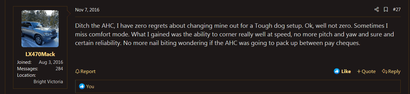

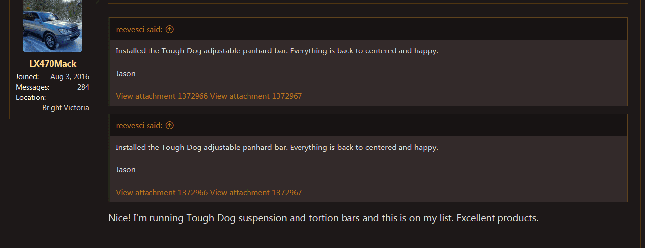

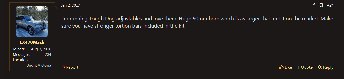

Interesting comment considering your previous comments.
Yep, that was the honeymoon phase. It all went down hill very quickly after that. At least you know i'm telling the truth since you dug that up to be catty.
Have you never changed your mind about anything over the course of years? I was informed by the dealer it would break-in. It never did. Thanks for digging up the story of exactly what I recounted above with hindsight of years and owning that cheap as junk product. Also, being in Cali have you ever been to their premises? They don't have a cent to spare.
Ever bought a new car or product and been unhappy with it as time progressed?

It was easy to remember you from all the positive comments you made for quite some time and a simple search pulled everything up you ever said on the parts. I didn't see anything from love to immediate hate.

This was 4 years and 10 cars ago. I was initally enamoured with TD. I grew to dislike it. I had the truck set up perfectly for what I used it for. Canning Stock Route, Cape York corrugations. I got the Big Bore to deal with the corrugations and to prevent overheating. All those comments were before some of the big trips. I needed new fillings.
