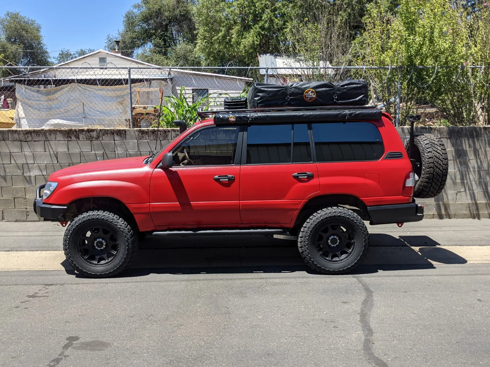

You can get close to a 65mm lift up front and still maintain 55-60mm droop. The 949L rear coils will yield about 50mm and the 949HL about 70mm.
They sell as a 30mm lift but you can get more out of it. Don't expect any warranty going above their specs... BUT, I've sold literally hundreds here in the states, Canada and misc other countries and other than an occasional shock warranty... all good. I
I run one of the tallest 100 IFS Tough Dog kits out there and no issues on my end with a diff drop and extended sway links. 34.5" tires, 75mm rear coils and Tbars cranked to the maximum with 50mm of droop...
If you are maxing the system out run the 53mm fronts and 45mm adjustable rears. Superior engineering (comparable to mine) diff drop and my sway links available from Complete Cruisers in Wagga Wagga, NSW.
