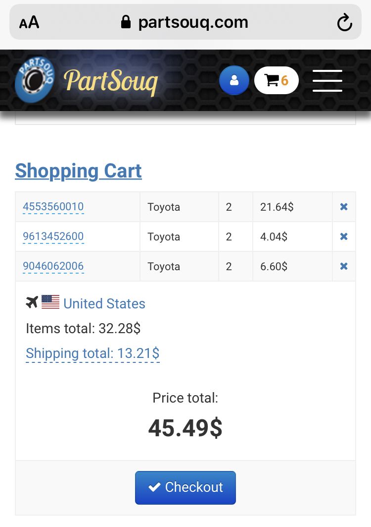

Don’t know if you’ve ever ordered from PartSouq.com before, but they have excellent prices and quick shipping. Around $45 for the everything, delivered:
Partsouq is a great parts source, just to second this. My dad wanted a new center cap for his 06 LX as one was missing. Partsouq with shipping had the best price by far on a new one.
They’re not usually cheap for big ticket items like CVs or Racks but little Knick knacks like this they really cannot be beat.
