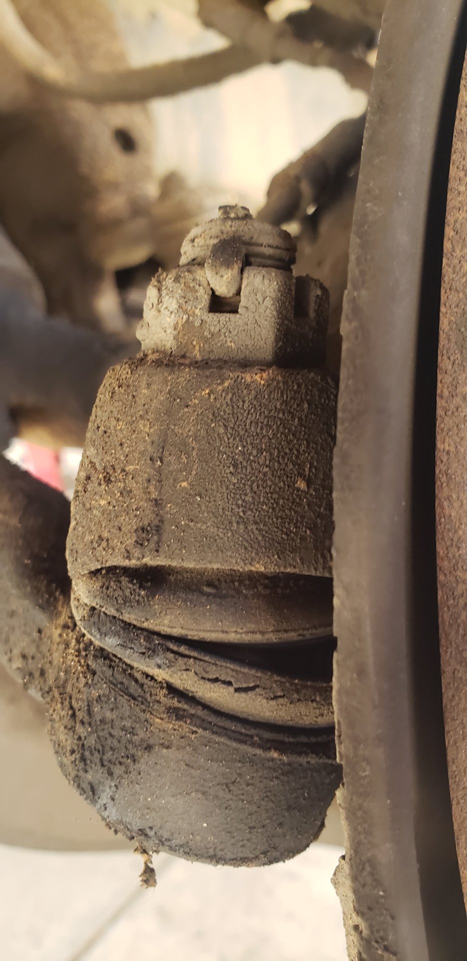

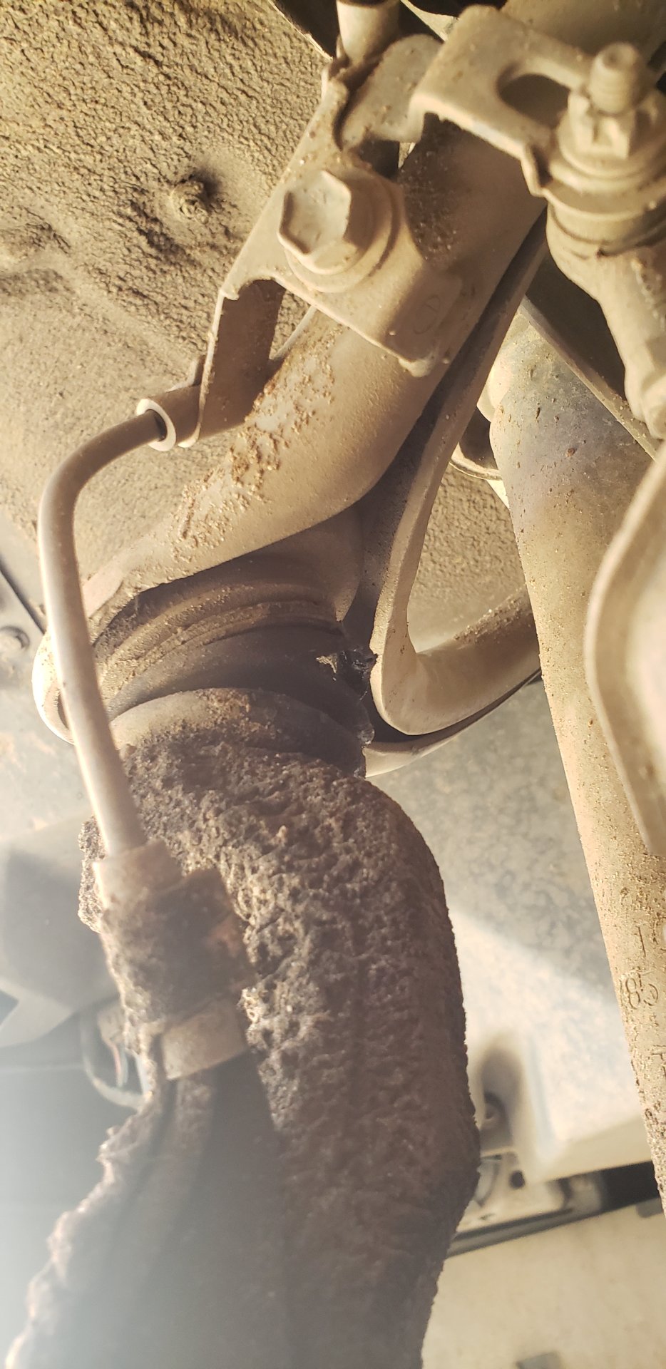

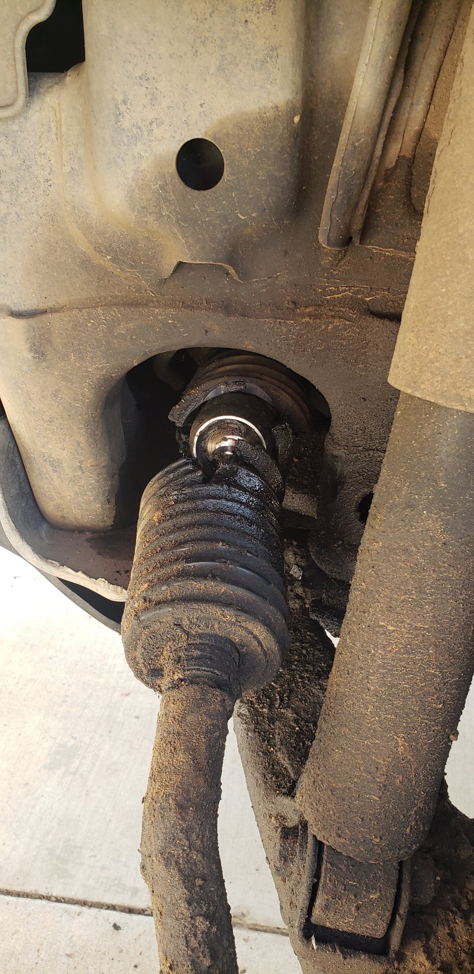

My son kept telling me that the suspension was creaking and making noise. This is what we found today when we looked into it.
It’s not leaking power steering fluid. It does need valve cover gaskets and is leaking oil pretty bad. Do you guys think i need a new rack or new boots?
The boot is torn on the upper control arm and the bushing is shot on the tie rod.
Thoughts? How bad is this?

At minimum the inner TRE and dust boot need replaced. However, based on your photos, If that was my truck I’d likely prep for replacing everything: steering rack, ball joints, outer TREs, and control arm bushings.
