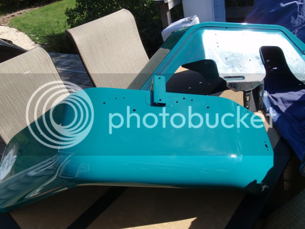

Couple of quick pictures, some in the dark but Hi-rez. Its a little bright the first time you see it, then it grew on me a bit. It POPS big time in the direct sunlight.
...now if I could find all my parts to put it back together I would be happy camper.
Cleaned up the dash pad and threw a windshield knob on there to see the color contrast.

Pat, that looks awsome! Glad to see with all that's going on that you're still focused on the Cruiser. Are the windshield knobs aluminum?
Yea finishing this thing has become somewhat of a vendetta...
They are, I dont know how long it took the guy to make em, but they are sweet! I bought them about 3+ years ago HA! I dont want to know how long it takes to machine one.
Here is where I got em.
