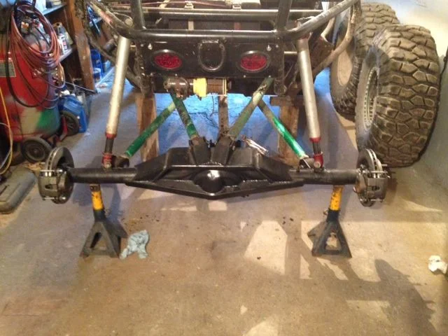

finally had some time to install the 9" under my buggy today, still need to weld the lower shock mounts and plumb the rear brakes.

Was in the shop at 7:30 this morning. Grinding out a bunch of less than ok
welds. Try again and they look like s***. Getting no gas to the tip, brand new bottle.
Trouble shoot and find that the cable to the gun has slid out a bit so the port for the
gas isn't lining up, fix that and tighten it up. Ok works good now! welding away and s*** stops again,
out of wire now. Ok, airgas is only 10 minutes away, "no we're out of that wire, maybe in a few days"
What the hell, its a welding place you'd think it would be something they keep around. So now I'm at Home Depot,
yay they have some!
Back home, finished up the brackets. Made a bit of diff armor from some 1/2" flat stock I had laying around.No torch so
so I'm heating it up using charcoal the bending it. Lots of fun!
Anyway, the axle is in place. Now I have to figure out tabs for the shocks. Passenger side is simple but the steering box is in the way
on the drivers side.

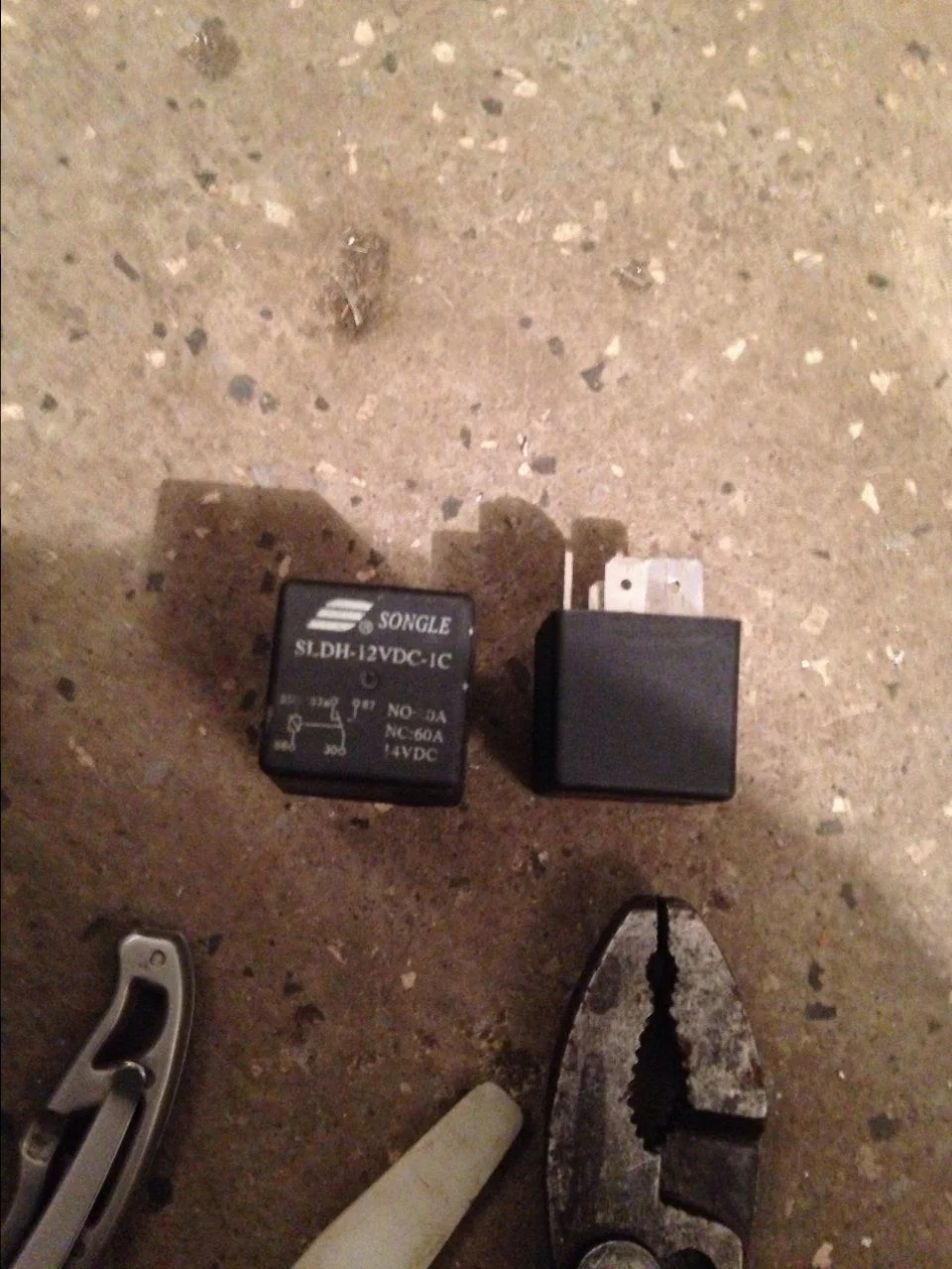

Changed both solenoids on my little rear suck down winch just now. That crap broken for over a year now. Ready for saturday. Also finished installing the 9" axle. Will see how it holds up.
9" axles are legendary. It should hold up fine.
