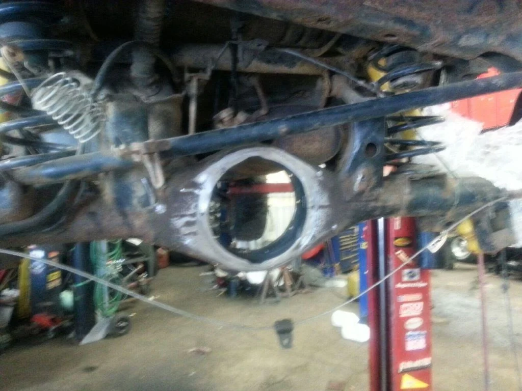

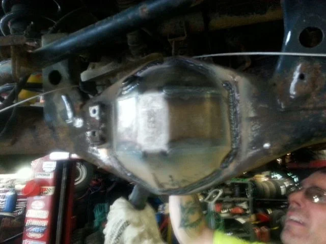

Out with my leaky JB weld covered diff in with the newer, bigger, stronger cover.

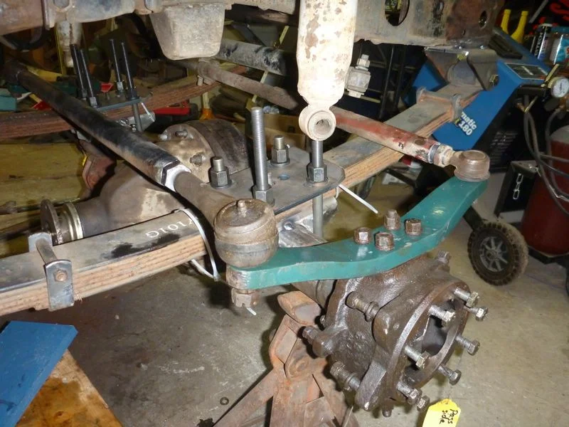

My shop isn't big, how did I lose a knuckle?:bang:
20 minutes later I find it.
Re-tack things, pinion angle is set, knuckles are at 5 degrees.
Hi-steer arms are on. Things look pretty good, no major rubbing when
things articulate.
Now to take it all back apart and weld it up.

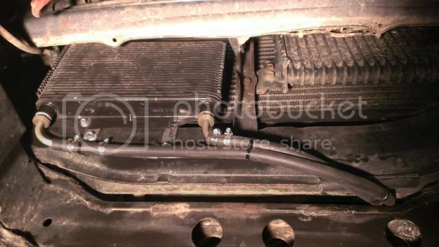

Had a unexpected wrench today on my power steering. Last min. fix as I am leaving tomorrow for CMCC event in PENN. My paperclip cooler sprung a heavy leak. I stopped at the bone yard, walked around and ended up with a trans cooler off a late 90's suburban. I'm good friends with the owner so I tend to get most parts for free so it was a good budget project. Removed all the old stuff and installed. It worked out well. I can tell it held more fluid overall also. I got the cooler positioned so the engine fan will pull air through it. Unfortunatly I had no more of the shielded hose clamps so I doubled up with some cheapeeze until I get home from the event this weekend.
Nice.That will cool better than paper clip.
