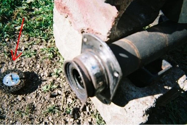

2 Winers ago some SOB, sprayed my new paint job on my truck with some nasty paint striper, I waited till summer to get it repainted, so it stared to rust . I didn't want to sand blast it, so I used that gizmo you see in the first pic. Removed all paint and primer (right to the shiny metal). I did the whole truck inside and out side excluding the insde of the box. This thing works good on the drill and doesn't cause any damage to the metal. The second pic you can see the damage , it doesn't show the rest of the truck, but that stuff was everywhere.
I would use it on a 40 in combination with blasting the hard areas areas.
