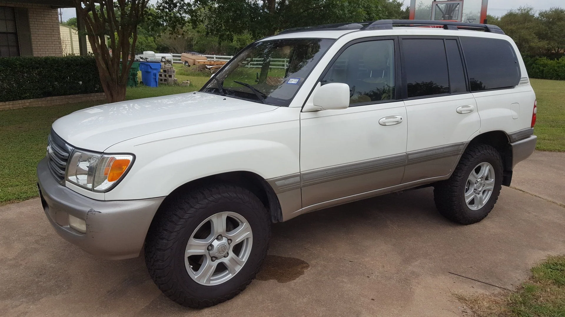

Currently running 285/65/18 TerraGrapplers. One of the tires has a screw in it that is non-repairable (outer sideblock) and no warranty on the tires. They were not rotated by the previous owner, so the front 2 have a bunch more wear than the rear (60% tread life left vs 80% per DiscountTire). Additionally, my spare is not the same overall size (previous owner didn't match it). As such, I've decided to replace ALL 5 tires with BFG KO2 thru DiscountTire with their road hazard warranty.
So, here is the quandary:
1.) Get 5 x 275/70/18 tires + 1 new 18" LX wheel ($225 on Craigslist) to match the other 4 so I can do a complete 5 wheel rotation each time.
2.) Get 5 x 285/75/16 tires, sell my 18" LX wheel/tire combo and replace with a set of 5 x 16" stock LX wheels (found on Craigslist for $130 for all 5)
This LX has become my DD and I put about 40 miles per day on it on the roads. I take it off-roading quite a bit (mainly gravel roads every weekend) and will travel to Colorado 3x per year to drive the trails and passes. Seems to me that the 285/75/16 might be better for trails as they provide more sidewall (8.4" vs. my current 7.3" and the 7.6" on the 275/70/18). The overall diameter would be slightly larger than my current setup and slightly smaller than my other alternative 275/70/18.
