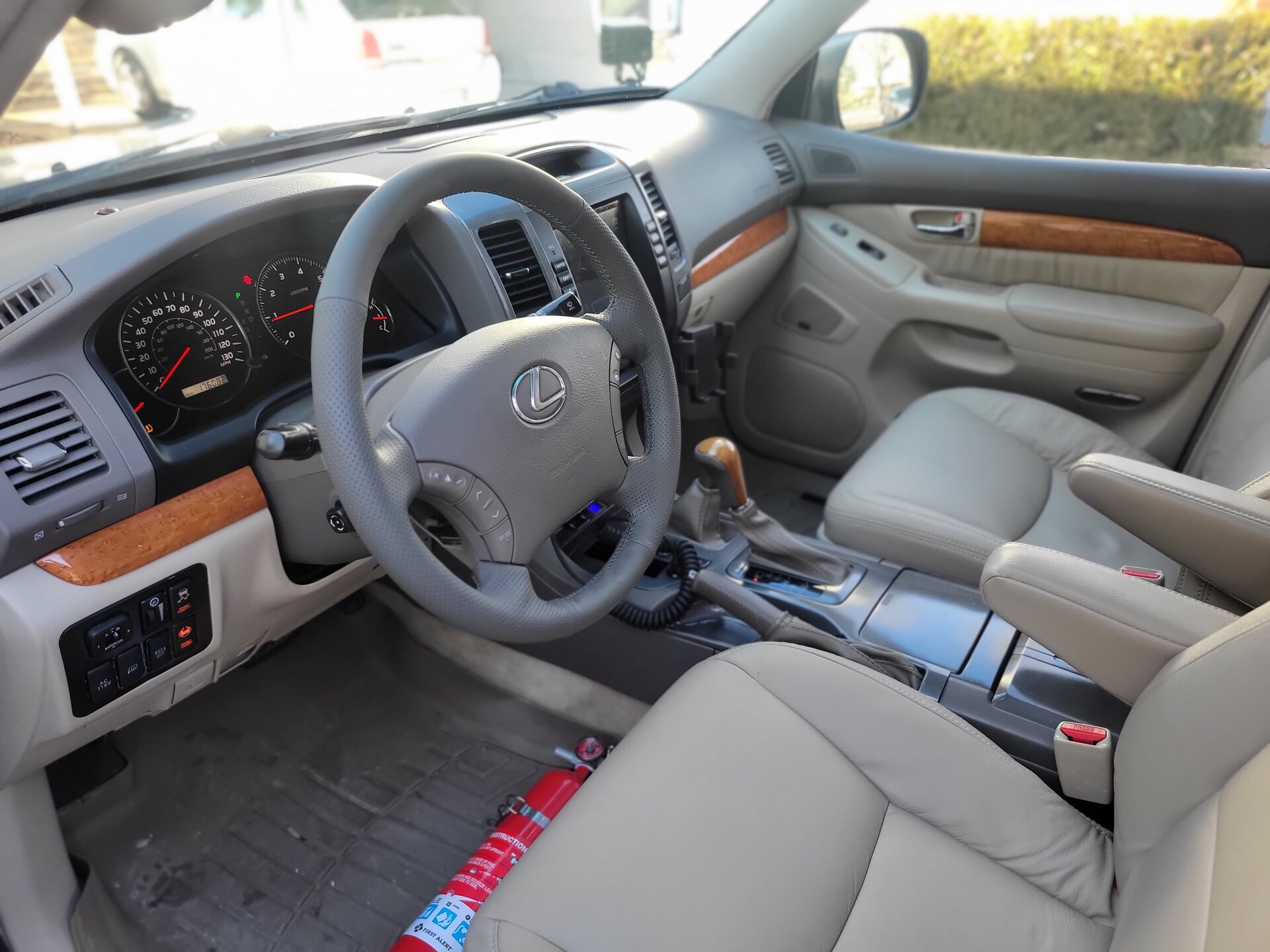

If you have someone with some sewing expertise in the family, the Loncky wheel cover can be a good option. Still pretty happy with mine, and I honestly preferred keeping the OEM wheel core instead of the eBay wheels.

She'll be able to knock out the whole wheel in a couple of hours. Just use LOTS of the double-sided tape, especially around the spokes, but even on the outer part of the wheel as well. My wife and I didn't use enough the first time and the leather was loose in a number of places (you can see little "bubbles" in my pic of it). We had to pull it off and re-do it (carefully) and now it's fine. I had her get each seam started and finished for me at the end, but I did everything in-between.
It's not going to feel as good as a new OEM wheel (maybe 90-95% as good, depending on your tape and sewing job), but it will be much nicer than what you have now and it's inexpensive.
