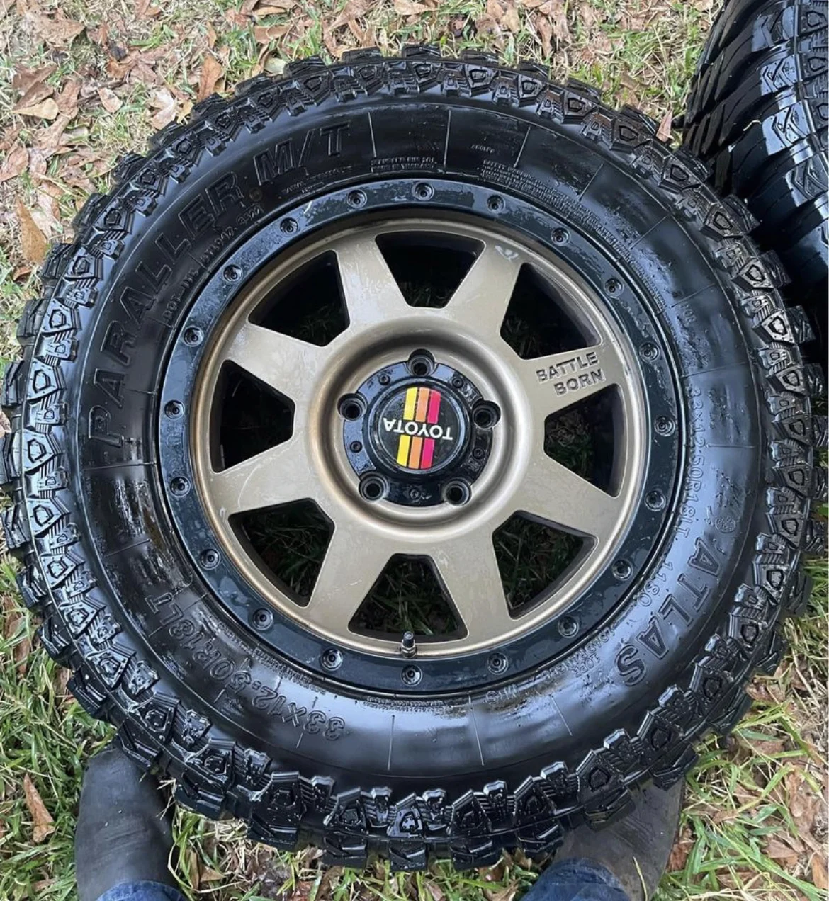

The wheels are Tundra 18 x 9 with 18 mm offset and 33 x 12.5 x 18.

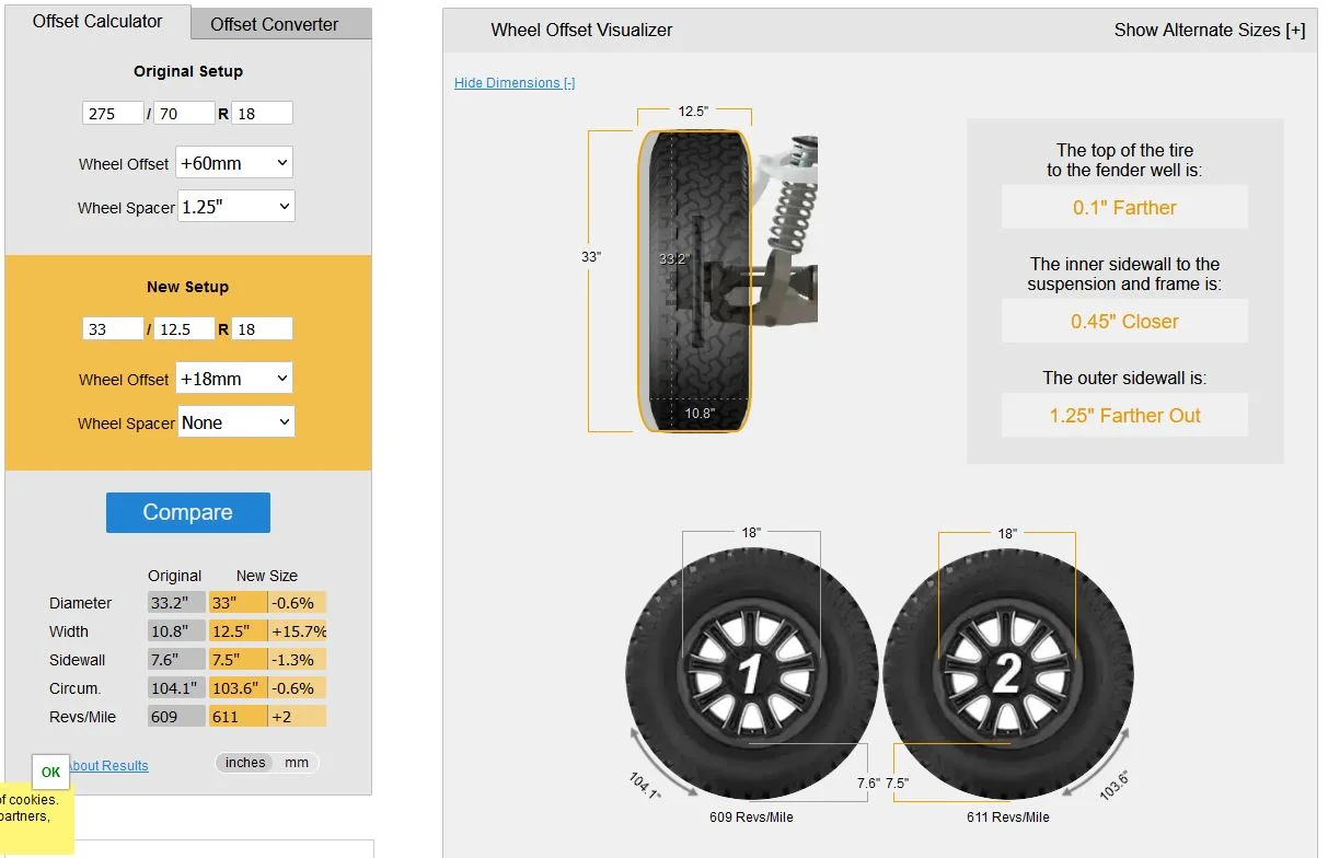

Isn't it more offset? Stock is ET60. This is like running a 1.5" spacer with ET18. It's possible this fits without mods. That is a fat tire though.

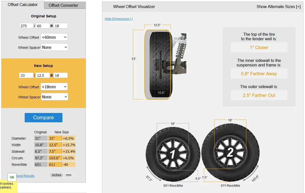

Compared to stock:

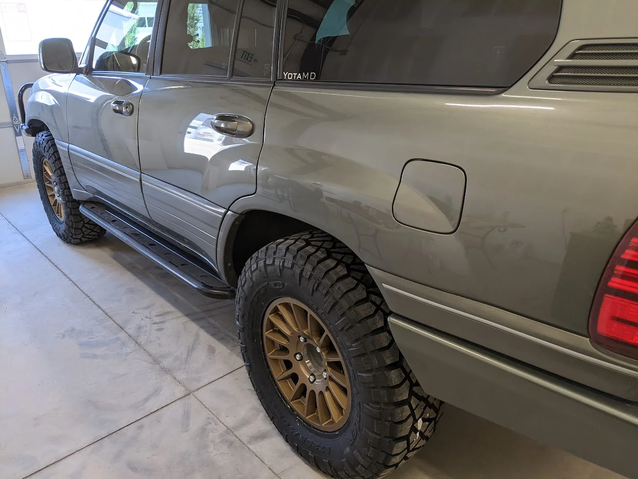

Compared to what I run (no rub):
Compared to stock:
You'll probably at least rub on the pinch weld at 3/4 turn tbh
Ok that is a cool tire fitment calculator @YotaWagon. What website is it? I get so confused with offset when looking at tires.
@Newportfreak I think I saw the same set on FB so we must be in the same area lol. Was tempted, but my 285s are basically brand new still, so I can't justify it.
Compared to stock:

I’m on 20” Tundra rims with 305/55R20 KO2’s. That said… I have no pinch weld… at all. But also no lift, outside of a tiny torsion adjustment when I put new OE springs in the rear. Paired with a HC front bumper, I have no rubbing, anywhere. If I’m at full tilt to one side or the other, I do have a touch of rubbing on the inner fender.
