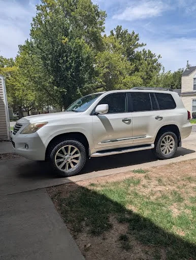

Michelin AT2's 285/55 20's on my stock '14 LX and I love them.
I went with the stock Tundra/Sequoia size of 275/55/20 to achieve a more accurate speedometer.
I ran some 275/60 craigslist specials for a while just because the stock dunlops were useless in the snow and that was what was available cheap and local. I couldn't tell a difference from a ride/handling/power standpoint from the stock size. Also couldn't tell a difference visually. If you're looking to fill out the wheel well, but still keep it simple, I'd go 285/60 or 295/55. Also keep in mind some brands run larger/smaller than advertised size.
