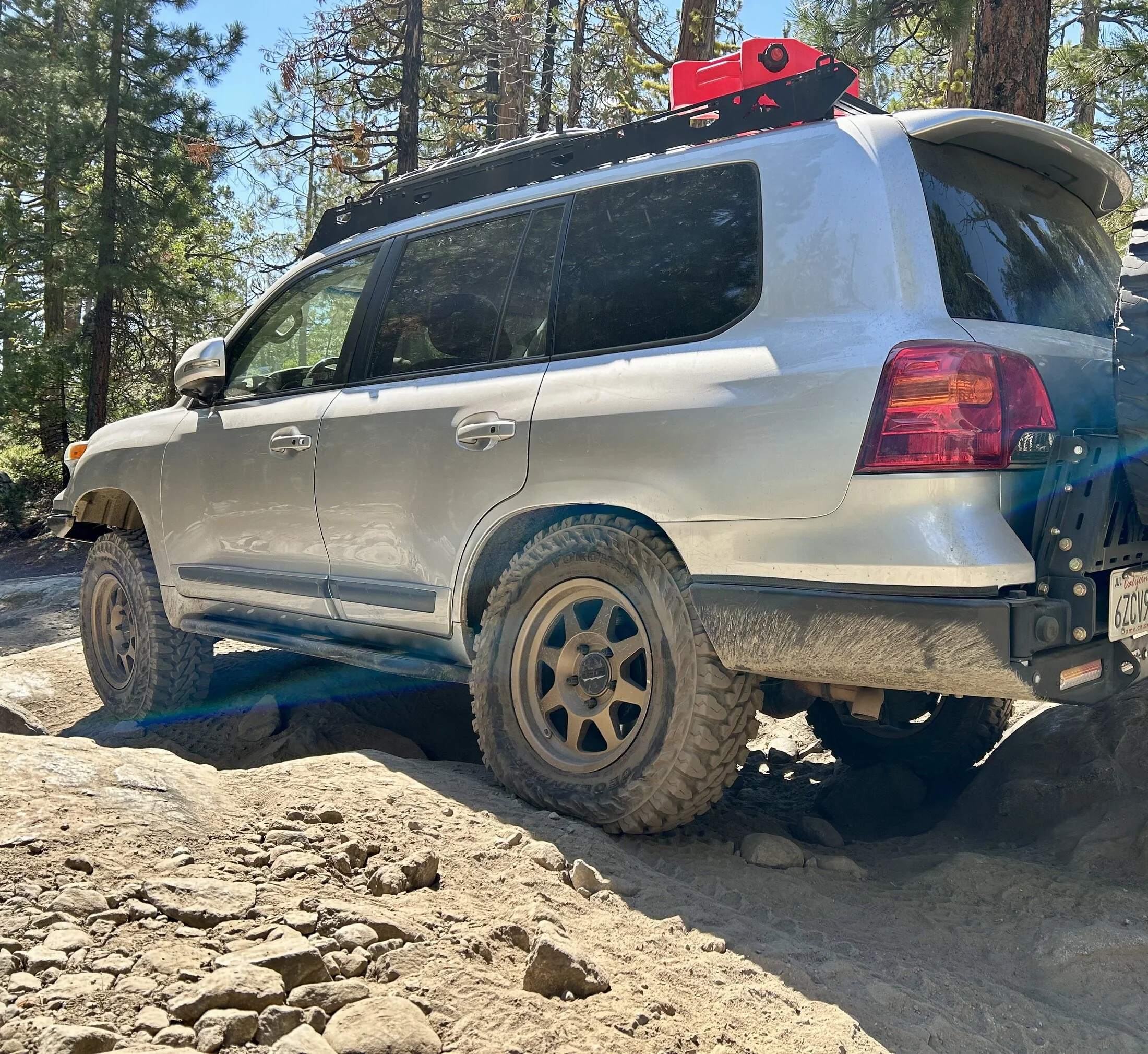

I just went up to 285/70r18 on stock wheels. My setup: +2” up front, SPC UCAs, appropriately trimmed fenders and flaps.
Yes, they rub: KDSS arms at full turn (noticeably), the UCAs at full drop, maybe a piece of the frame at full lock.

LT285/75r17: TOYO AT3 (E) on a 35mm offset wheel. Slight rub to the KDSS sway bar at full lock. May at some point do the relocation bracket/set up but not necessary.
LT285/70R18: Yokohama MT G003 on a 25mm offset wheel. Clears the KDSS bar more with the lower offset compared to the 35mm.
The 17” tire / wheel combo when aired down flexes better over rocks and terrain. Highway driving isn’t as precise feeling, I can feel a weee bit more sidewall flex, roll over with the LT285/75r17 l during high speed turns and on windy roads.
Until recently all of the LT285/70r18s were e rated until falken released their new AT4w so that’s something to consider.
There are more options in tire size and load range with the 17”s.
Keep the offset between 25mm-35mm and either size will fit with some plastic fender liner molding and trimming as needed. With that said this will require spacers to achieve this offset with the factory wheels.

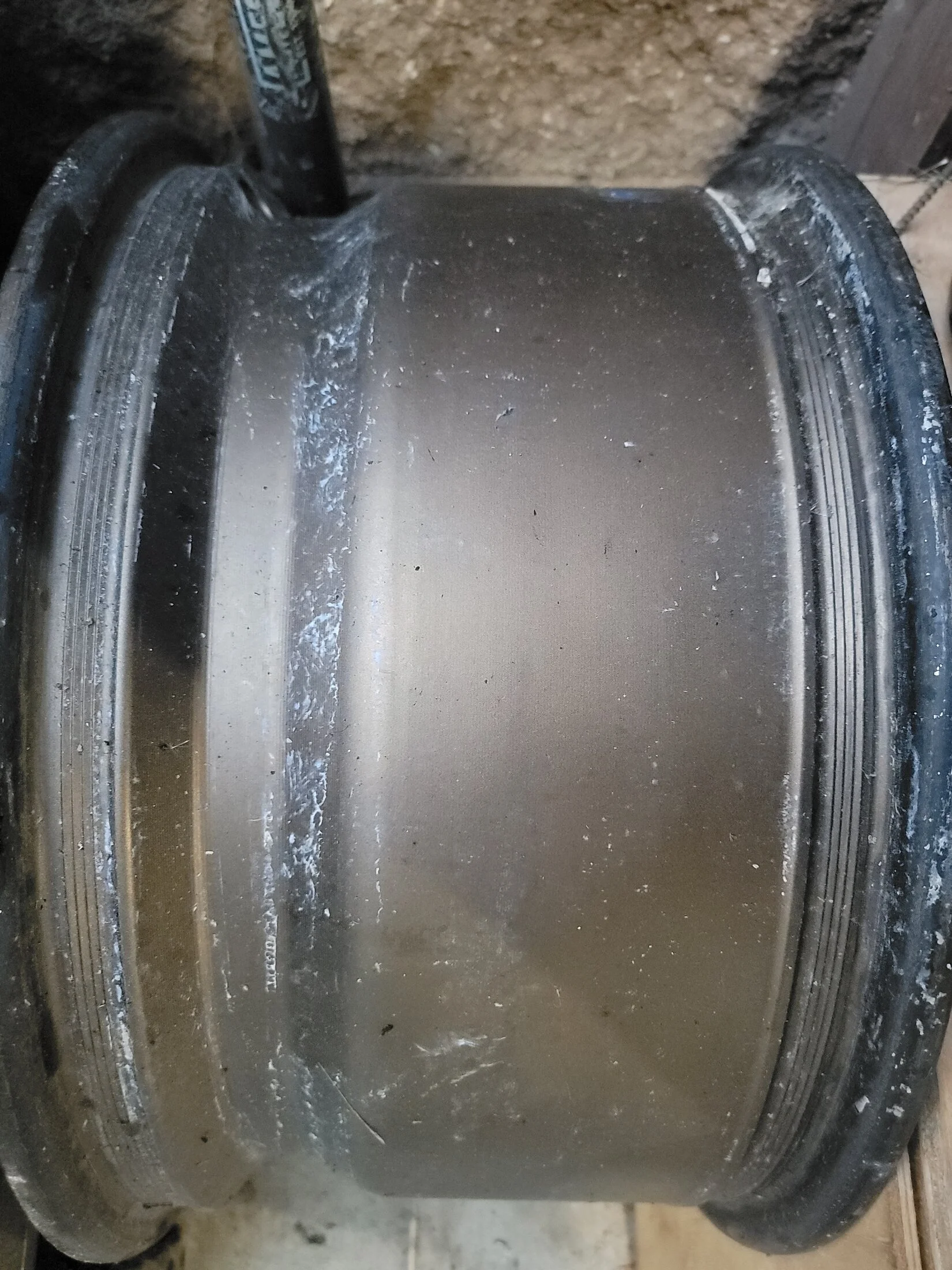

The challenges of getting the tire bead to seat can be a real issue for shops as the wheels lip is massive and has grooves, that make it hard to get the tire installed.
I have the MR701 (18x9 25mm offset)
You can see how pronounced the lip and grooves are. They really hold onto the bead when aired down.
