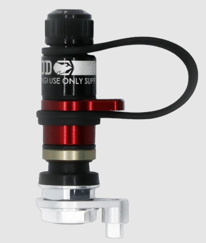

Screw on RCV (Rapid Connect Valve)

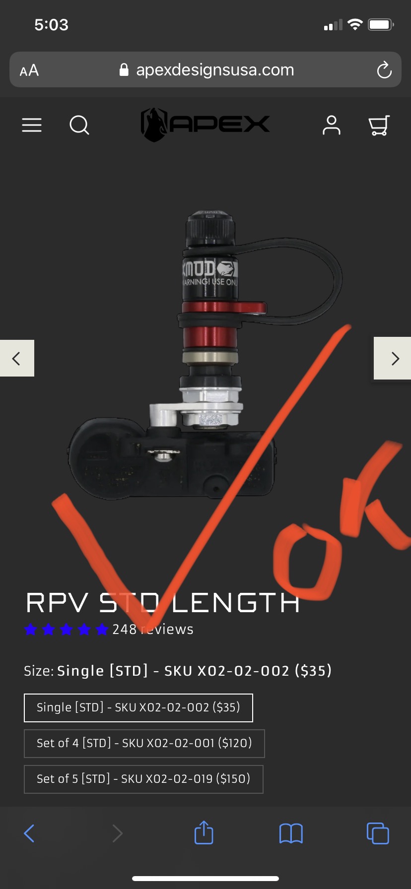

Install / Replace valve stem RPV (Rapid Precision Valve) in std length (which should work with most OEM wheels)

Looking at the RCVs, they add about 3/4" to the total length of the stem. OEM stem is about 1.2", +.73" = 1.93" I'm not sure I'm comfortable with that on the Tundra wheels I have as that'll have it closer to the face, putting it in danger of rocks. Whereas the normal length RPV will be about 1.62" total length.
Figure I'll reply here since it's a new thread--the added length was a pretty big concern for me as well with both style valves. I've marked up my wheels pretty good and have yet to break an RPV in 2 years, but I have definitely heard of people doing it. When I put the RCV's on I'm actually specifically going to not go OEM TPMS so I can avoid the rigid valve stems. Autel TPMS has a rubber valve stem and will be slightly flexible which I'm hoping will help with the added length. Reliability and durability is TBD, but the owner of my local tire shop has been running them for 3 years in his 4Runner without issues so hoping they'll play nice. Worst case I'm revisiting new TPMS again in a couple years and will just put Toyota ones back on and deal with the added length
Also; forgot to say occasionally with the RPV the tab get pretty stiff and the best way I could find to get them open was to move them side to side while pulling out. Minor inconvenience if you have baby finger tips like I do

I will say as someone who deals with tires and tpms every day:
Be cautious using the bands. Your sensors on your valve stems were not designed to be mounted like a band sensor.
It’s possible the sensor won’t work properly, not saying it won’t 100% but there’s a chance.
I’ve dealt with many aftermarket wheels that have toms sensors installed and if they aren’t correctly installed they won’t work at all. I’m face we chased our ass for 2 days working on one that has “new” sensors put in elsewhere. Turns out they were upside down and the vehicle thought they were rolling backwards so it never learned them. They would respond every single time to the tool, but required a drive cycle to learn and being as they were going the wrong direction they would not pick up. I’ve also seen the same problem after a long drive cycle.
I do like that the apex valve has provisions for tpms sensors on it. Factory style mounting and where it’s supposed to be.
However if you have the sensors that require the funky little adapter just buy new quality aftermarket sensors and have them programmed. Mounting will be much more secure. You don’t want a Tpms sensor / mount rolling around inside your tire. It’ll kill a tire from the inside in a short amount of time.

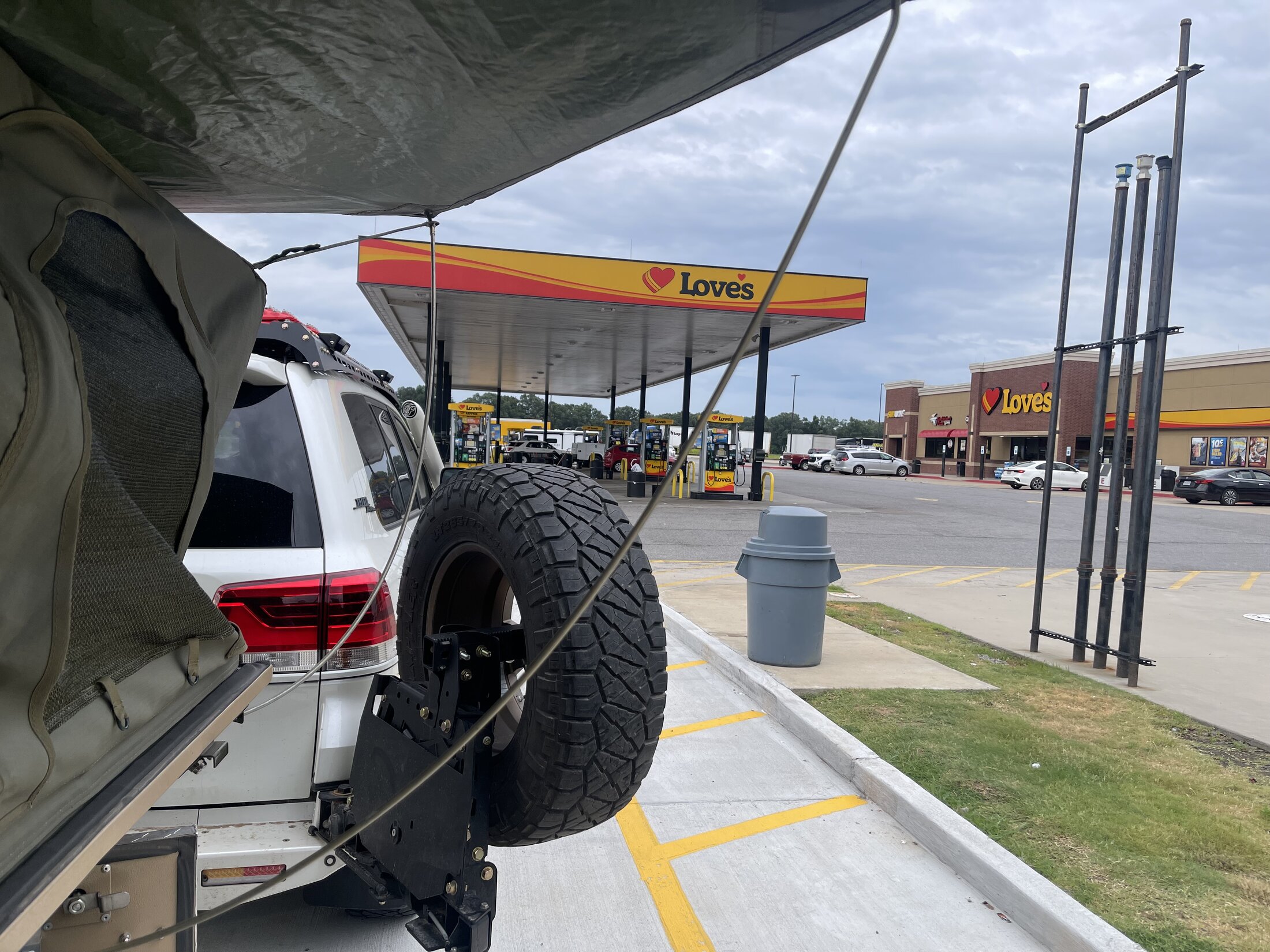

They’re coming. My current view as I type this:
Heading east, one more big stop before home, Mammoth Cave in Kentucky.

I forgot to comment about this, but unfortunately this style mount is not offered for Toyota OEM style TPMS sensors. The only way to mount Toyota sensors is with the bracket you had crossed out.
I believe that to be correct.
That is why I stated to get new quality aftermarket tpms sensors that valve stem mount.
For the exact reason you had with intermittent issues.
