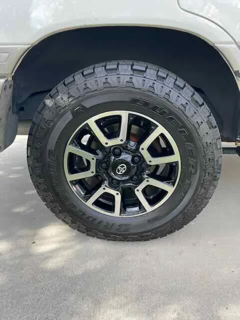

I went with AT Ascents in 275/70/18. They're E rated, but ride more like a C or D.
I was planning on going with KO3s from Costco but ran into the size issue per above.
How is the road noise/comfort? Costco also have the Ascents but most likely they would only install 275/65/18 ( which might be the perfect size for LC).
They've been great. Very quiet, but I'd add that most new tires are very quiet IMO.
I got the Ascents from Discount Tire who price matched Costco.
I agree it's the perfect size for a "stock" LC. Far more availability than stock 275/60's, rides and looks much better.
Thank you. Did you have to do any mods to fit 275/70s ? Any rubbing?
None - my LC has the standard OME lift though and they fit well.
