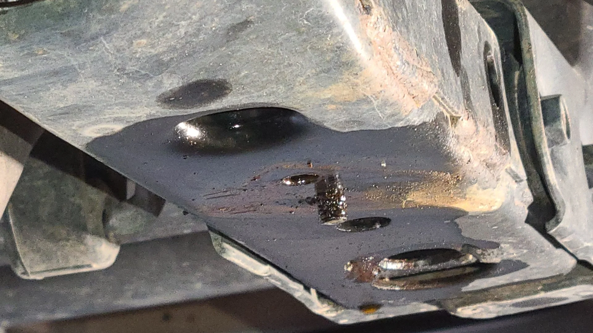

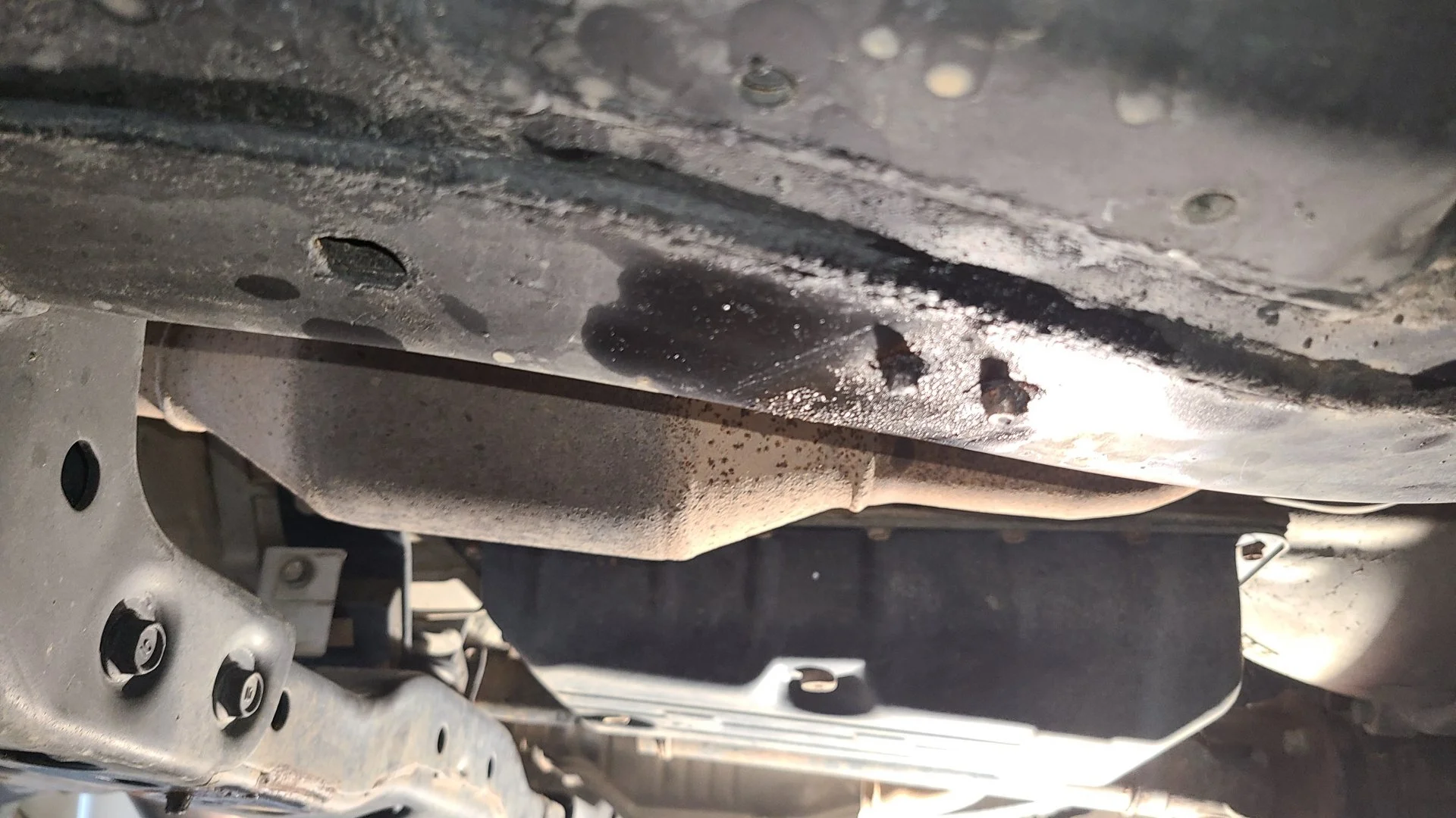

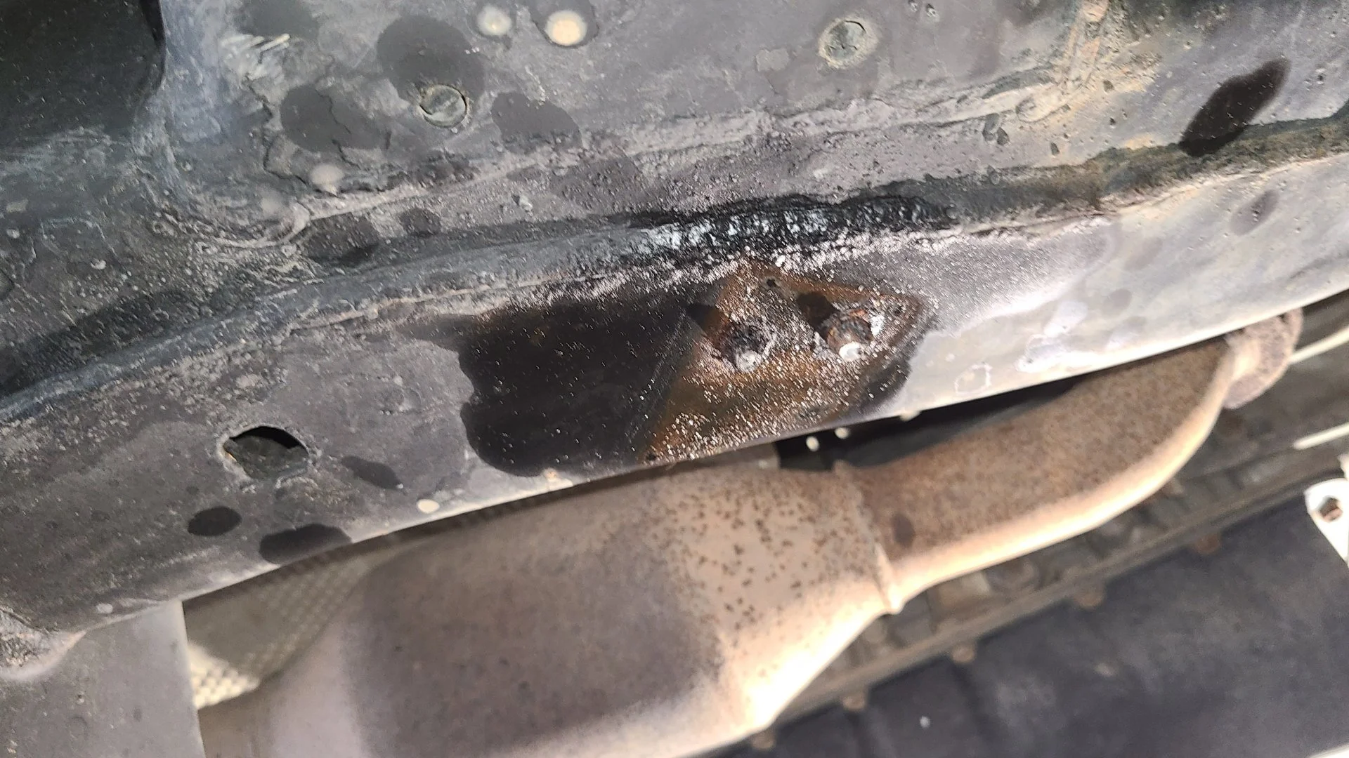

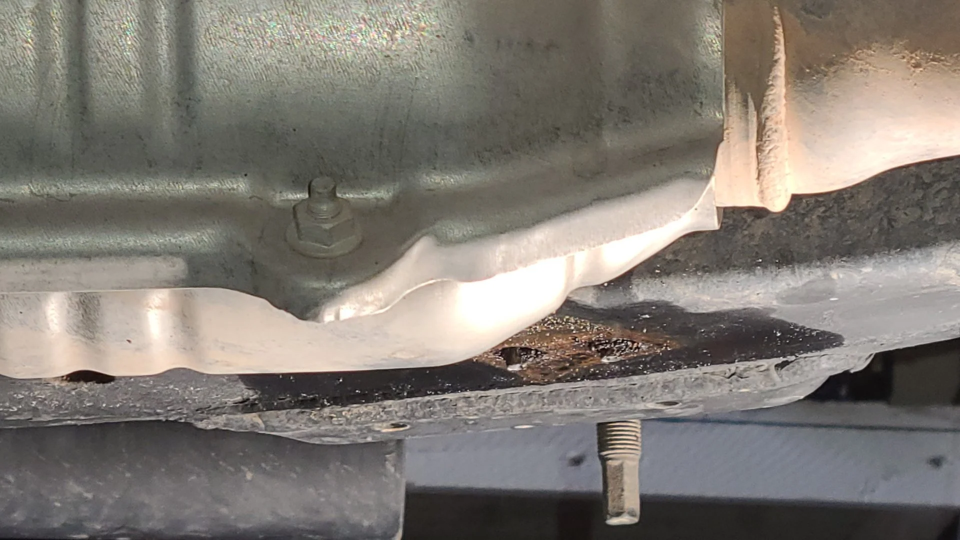

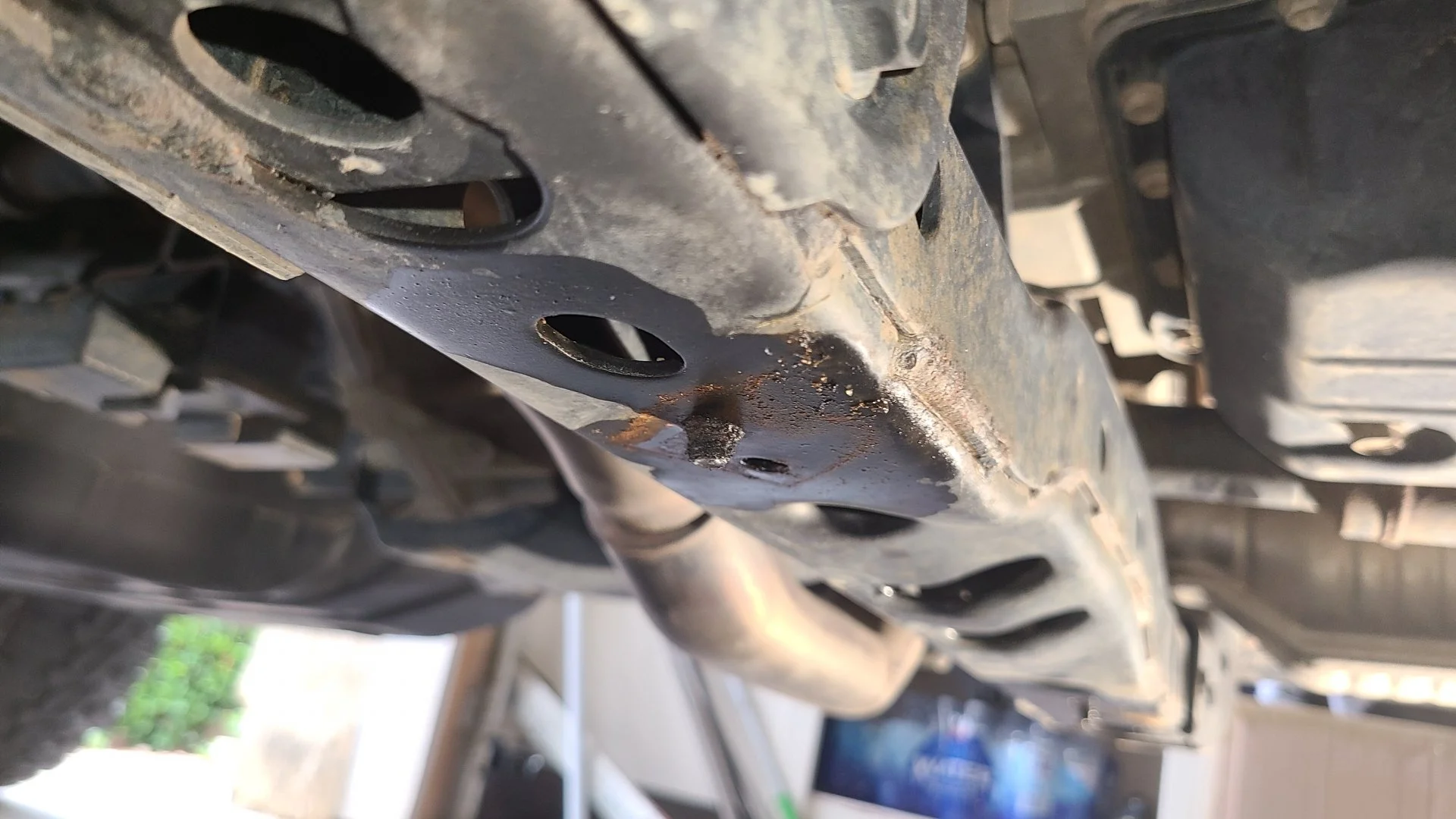

I'm in the process of trying to install some skid plates on my 4th gen and have run into a few snapped bolts that I'm unsure of how to remove.
The skid plates I have mount all the way to the back of the tranmission so the rear mounting point is using the cross member braces. There is one on each side 2 bolts on each giving a total of 4 bolts. I got 2 out no problem one on each side but the other two snapped almost immediately, soaked them a few times with pb blaster before attempting.
I then tried to remove the braces and all 4 of those bolts have snapped as well.
Unsure of the best way to get the removed and get everything put back together. Hoping to get this done before the Colorado trip.
