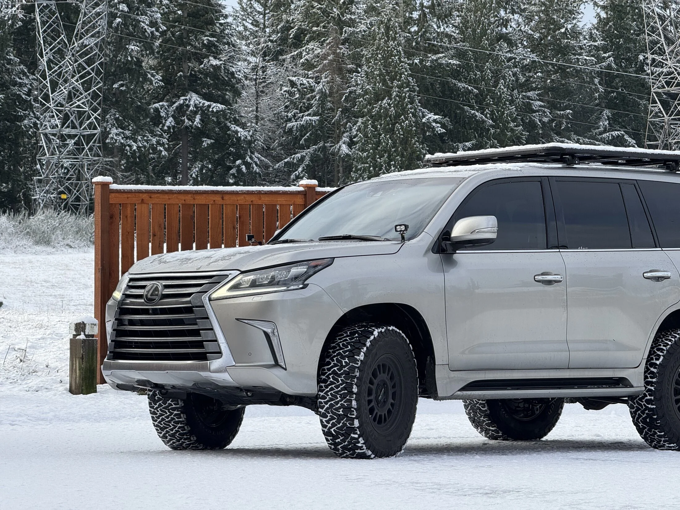

Tinkerer’s Adventurer fits 37s with no lift or BMC
It's not the diameter, it's the scrub radius + diameter. Most people (myself included) want the more aggressive +25 offset. Keeping the stock +60 overcomes a lot of problems with running big rubber in front.
Even at +40 im running 35s (34.9 🙄) with no cutting or mods really.
I think Method made those +40s specifically for that reason. I prefer the +25, but the +40 is a great compromise for the 200.

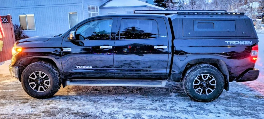

I have 35s on my Tundra - crazy thing for me was that it didn't even require removing the mud flaps. The only thing i had to do was trim a tiny bit off the skid plate with some tin snips (the OEM engine skid is weak sauce). But also they really don't even look very big on a Tundra. They kind of look like stock size if you don't have a stock size next to it for reference. Part of me regrets not bumping up to 37s. Would be nice if there were tire options in a 37 with a more all-season type tread pattern for more comfortable highway miles.

what are the tire/wheel specs on your rig?
295/70/18 BFG KO3s and method MR318s. I massaged a little plastic and moved a few things around with the guidance of @tbisaacs who happens to live down the street more or less.

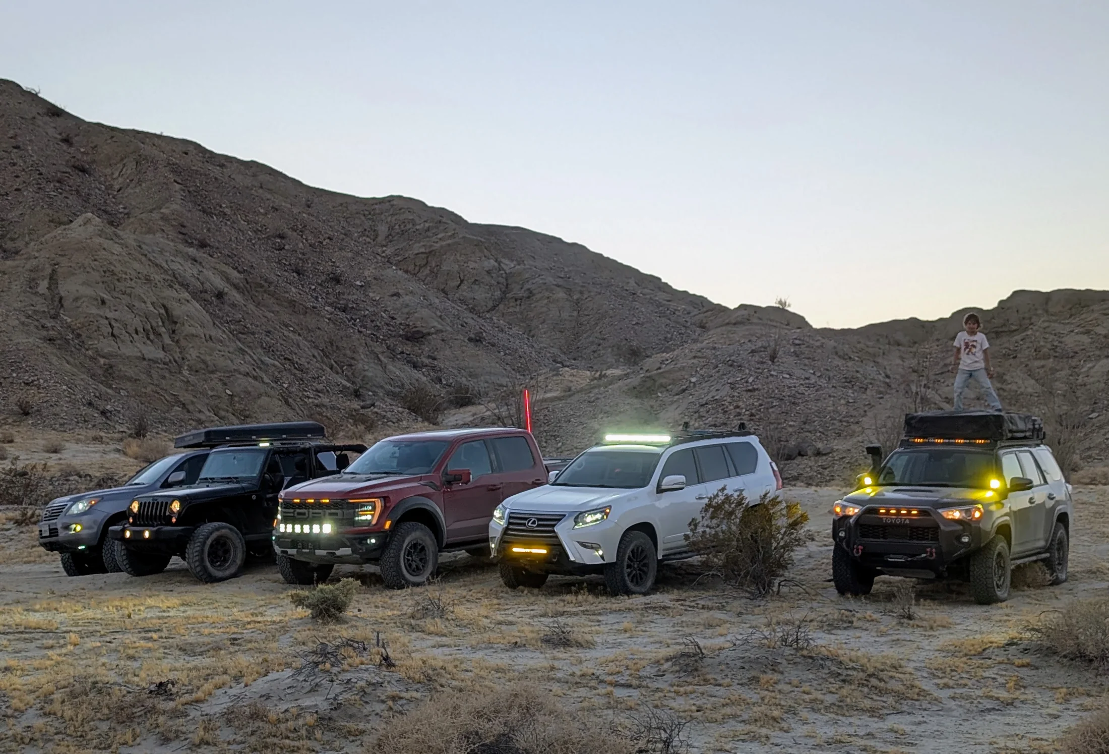

My GX460 on 33's was much more capable than my F150 on 35's. Breakover alone destroyed the F150.
I think this is definitely true. My 4Runner with 34" tires would pretty easily out-perform the Tundra on 35s in most offroad scenarios. The only place it might not is high speed desert type places where the long wheelbase can be an advantage and in the sand where the Tundra's big power advantage might overcome the size and weight. The 200 also has a MUCH better version of ATRAC/MTS. The ATRAC on the tundra is pretty worthless. I'd guess in the more technical trails a LC200 stock would still do better than my Tundra on 35s just due to the traction control.
Agreed. I wheel with a pretty varied group and it plays out over and over. This 4Runner on modest 33s will make easy work out of many things a Raptor on 37s may not breeze over as easily. Part of it is opportunity for line choice whereas a Raptor will just have use the only line he fits through.
And yes, open expanses is the Raptor natural playground.
