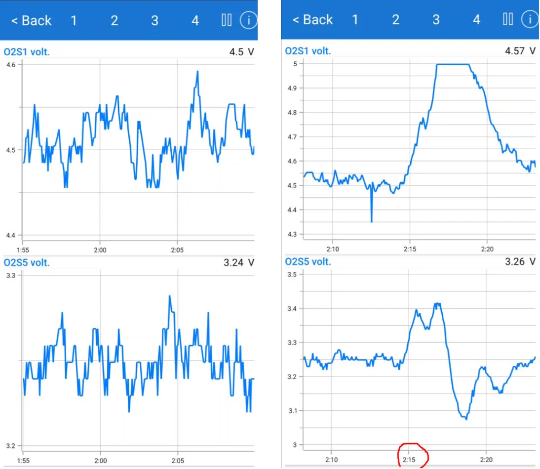

I then used Car Scanner app on my Android phone + ELM327 dongle to log AFR O2 voltages on B1S1 and B2S1, and during engine idling, I pressed the brake pedal to simulate a lean condition (this idea is from several Youtube videos).
My O2S5 voltage (Oxygen sensor 5 Wide Range Voltage, I don't know why the software shows sensor 5 voltage instead of sensor 2, but I assume this is the B2S1 AFR sensor, as other sensors are disabled in the software) consistently hovers over ~3.25v during idle, and goes up to 3.4V when I pressed the brake pedal, then goes down to ~3.1V when I release the brake pedal, then it will go back to ~3.25v after it "stabilizes" for several seconds.
My O2S1 voltage (Oxygen Sensor 1 Wide Range Voltage) however consistently hovers over 4.5V during idling, and it shoots up to ~5V after I press the brake pedal, it probably went over 5V as the software recorded a flat line at 5V for several seconds. Then the voltage drops to 4.5V, but it never went below 4.5V (like B2S1 does under 3.25v) and its response seems slower compared to B2S1.
I think my O2S5 (or B2S1) is behaving normal. But my O2S1 (B1S1) is not.

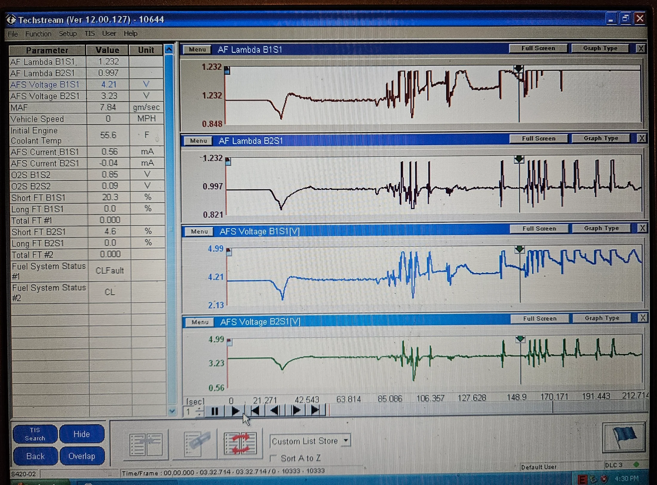

1) this is when I did a series of "snap throttle" tests: rev the engine to ~3000rpm, then release the throttle, then I blipped the throttle for several times.
LT Fuel Trim for S1 is 20%, and I think bank1 has trouble maintaining Lambda close to 1, and B1S1's voltage is consistently high, middle line at 4.2V and many times at 4.99V.
B2S1 seems to be much better.

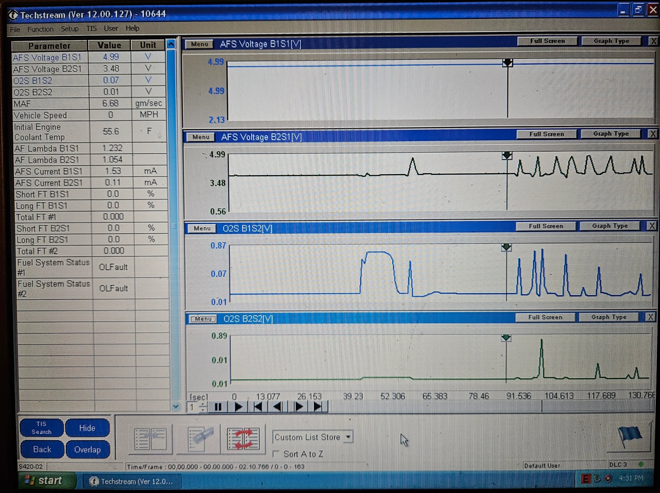

3) This is when I did several +- 12.5% injection volume tests for AF sensors from TechStream.
I was experimenting with Active Tests (first time) and observing the graph at the same time, so I don't remember how many times I tested and if I blipped the throttle in between the Active Tests or not.
But I can see B1S1 does not react to the injection volume up and down at all.
Odd is: fuel trim for both short term and long term came down to 0% for some reason? maybe communication problems?

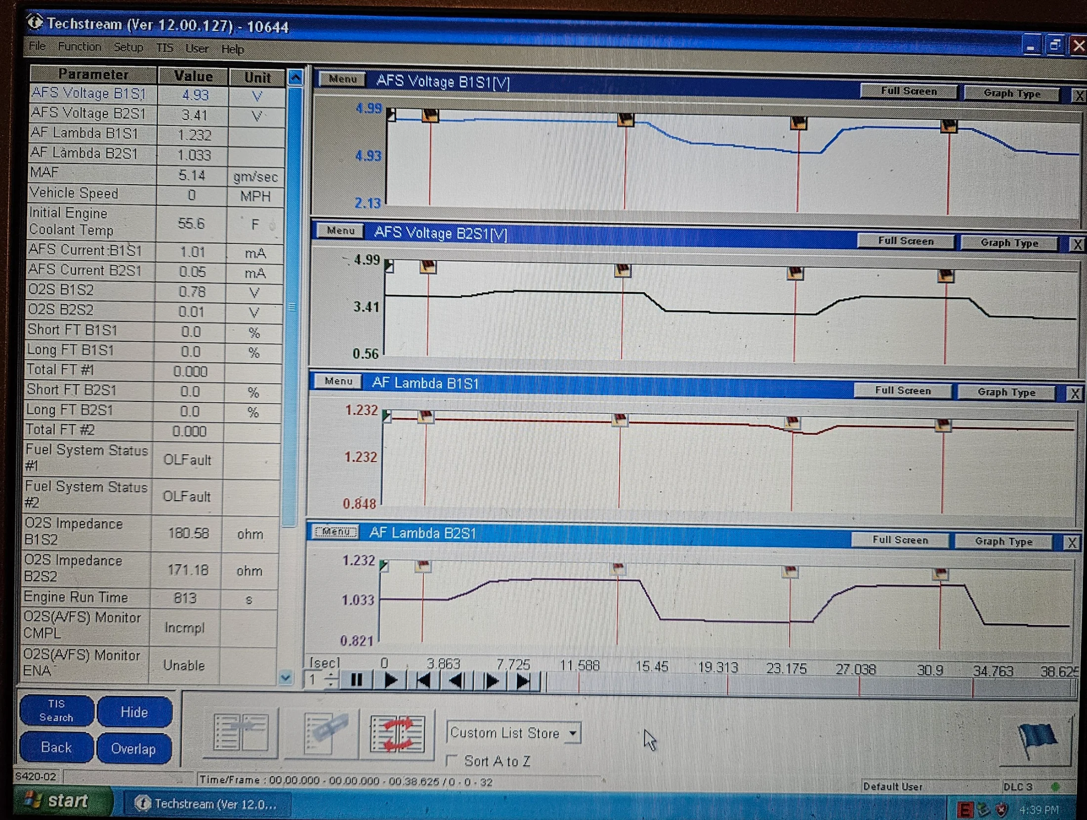

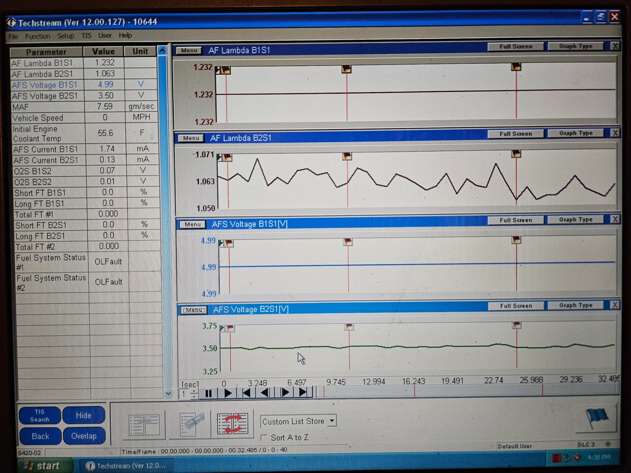

4). This is when I decided I need to do exactly two volume up and two volume down Active Tests: +12.5%, -12.5%, +12.5%, -12.5%
It seems B1S1 reacts to the injection volume change, but not much? (the X time scale is short, and I adjusted Y axis range making the graph easier to read.)
And the B1S1 voltage is still very high, hover around 4.9V range, even the low readings are above 4.93V.
