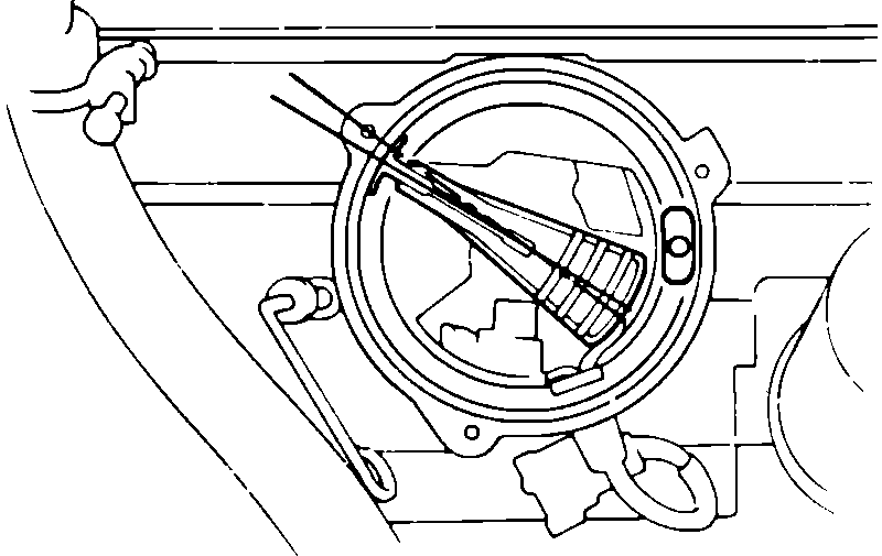

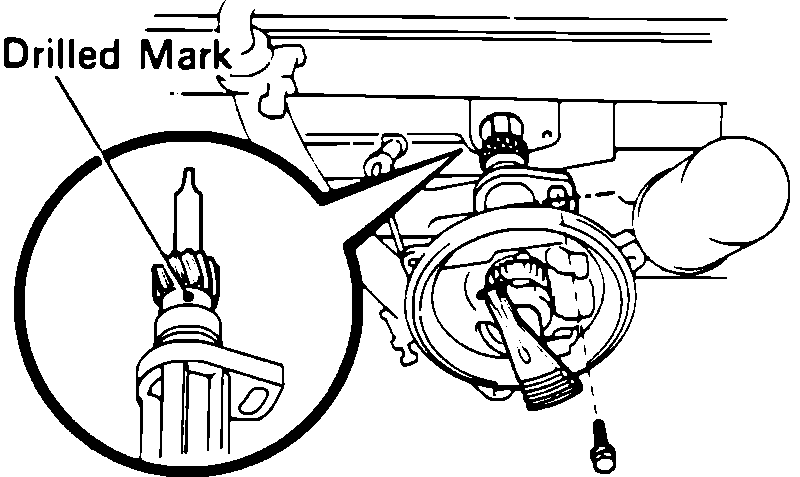

ok the distributor is not 180 off . I spoke with the guy who ground the cam it is possible that the machine shop put the cam in wrong it like the cam is one tooth off if you look at the distributor the rotor is not pointing where it should be. this is the OE position on the rotor on my rotor the at the bottom part of the drilled hole as a reference point. ok this right from Alldata the Distributor on these engines only go in one way it bot like a Chey or a Ford on a Toyota it ether its on or off
