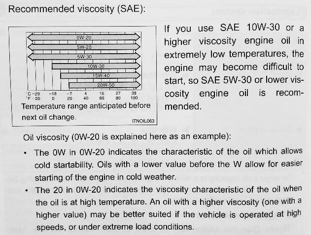

I don't see either of those weight ranges specified, but there are many options higher than 0W-20.
Here's what I have seen posted as ROW (Rest Of the World) oil options:
I'm running 5W-30 and am very pleased with it. If even higher weight is desired, 10W-30, 15W-40, or even 20W-50 could be used as a test - all full synthetic and depending on ambient temperatures.
HTH
HTH
They likely wrote up 15w-40 because in large parts of central and South America that may be all that is available in a high quality oil. If that is ok there should be no problem running 5 or 0-40, as the high temperature viscosity is often (but not always) a little thinner than the 15-40, but the low temp range would be much more favorable to most of the climates in the US let alone Oregon.
The fact that they go as thick as 20w-50 suggests there is plenty of room for a much more viscous oil if that’s what is available and the environment allows cold starts with it. I take this to mean these engines are quite tolerant of different high temp viscosities.. and it even makes me wonder whether the use of much thinner oil in the US contributes to these timing chain tensioner issues some of us and the tundra guys see. Unfortunately the 3UR isn’t common enough in other English speaking markets to really compare our experience to others, even if anecdotally.
