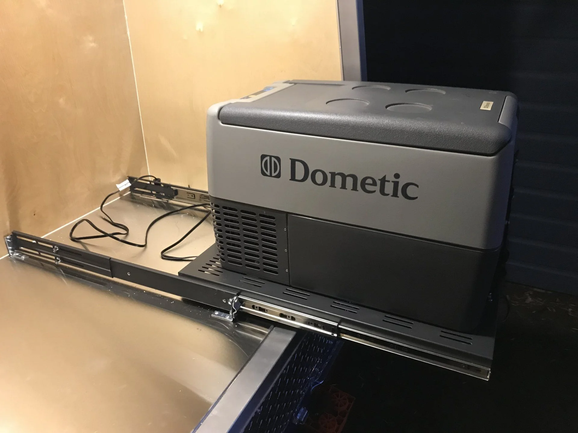

I already have 36” lock in/out slides so I was going to Fabricate my own version of the Dunn and Watson for my Dometic CFX75DZW. I’m pretty sure I can make it for less than the $600 it would cost to get it to Canada.

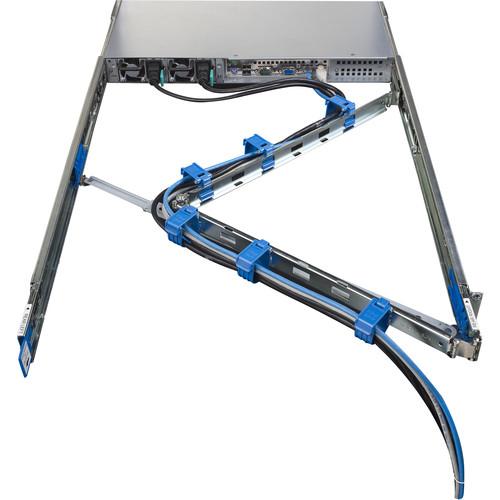

I have also been looking around for the scissor type cable management piece on the back of some server slides that allow the cable to travel without getting pinched. Like this:
May just 3D print something that will work similar.
@Brimstone I didn't even know the scissor cable management existed... I'm going to have to look into that one.

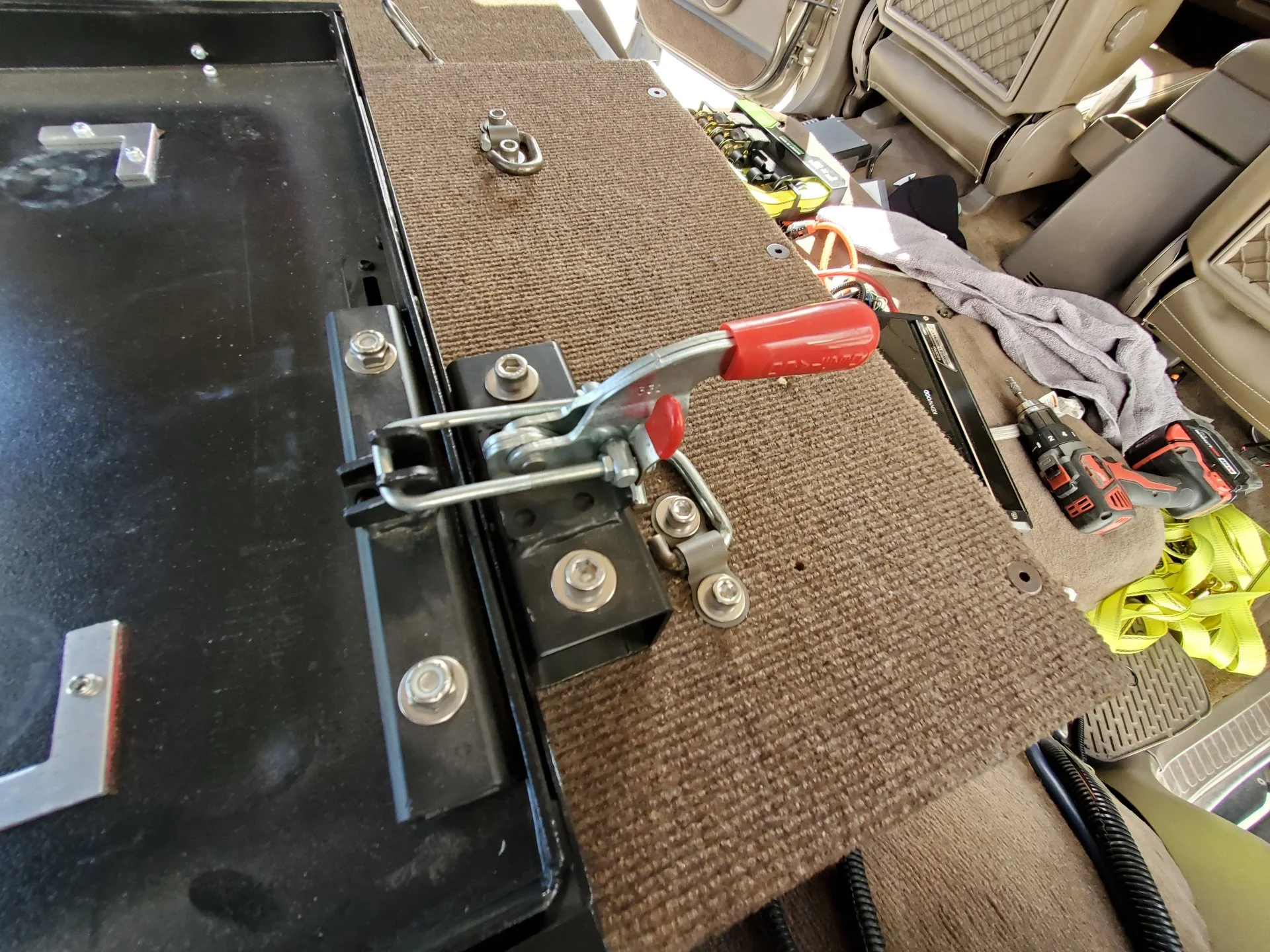

Bringing this back up as I just installed one of these slides and the rattle sucks. I installed more foam at the back of the frame so the front to back movement has been reduced but side to side is the real problem.
I used a Destaco toggle latch that I bolted to the deck the slide sits on and the hook is mounted on the slide

My Destaco arrangement
So it looks like you put that on the back?
Yes I did. Works well. Pain when I don't remember to unlatch it...but only temp pain

I've got a 65L fridge on whatever the largest Alu-Cab tilting slide is.

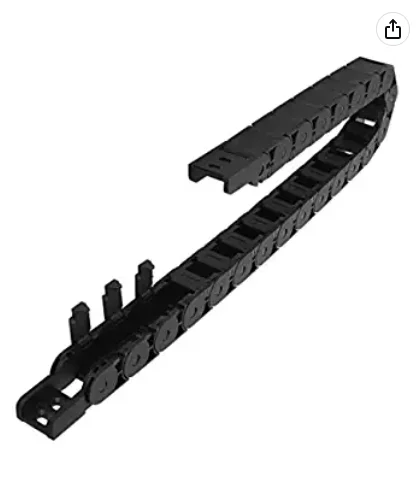

I ordered this cable drag chain to try to see if I can use it to manage my fridge power cable
