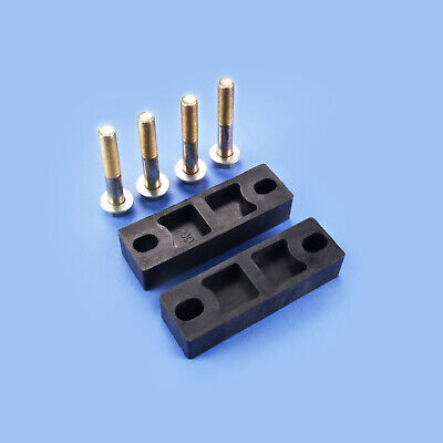

There are sway bar spacers for the tundra available...I'm not certain they are the same size for the LX570, but if not, a similar spacer can be fabricated in an afternoon with UHMW, aluminum, steel, or your material of choice. It could be matched to any AHC lift or spacing that you have installed (assuming lift, and resulting stress on the sway bar links was a contributing factor...the rust on your sway-bar ball joint may suggest another contributing factor too).
