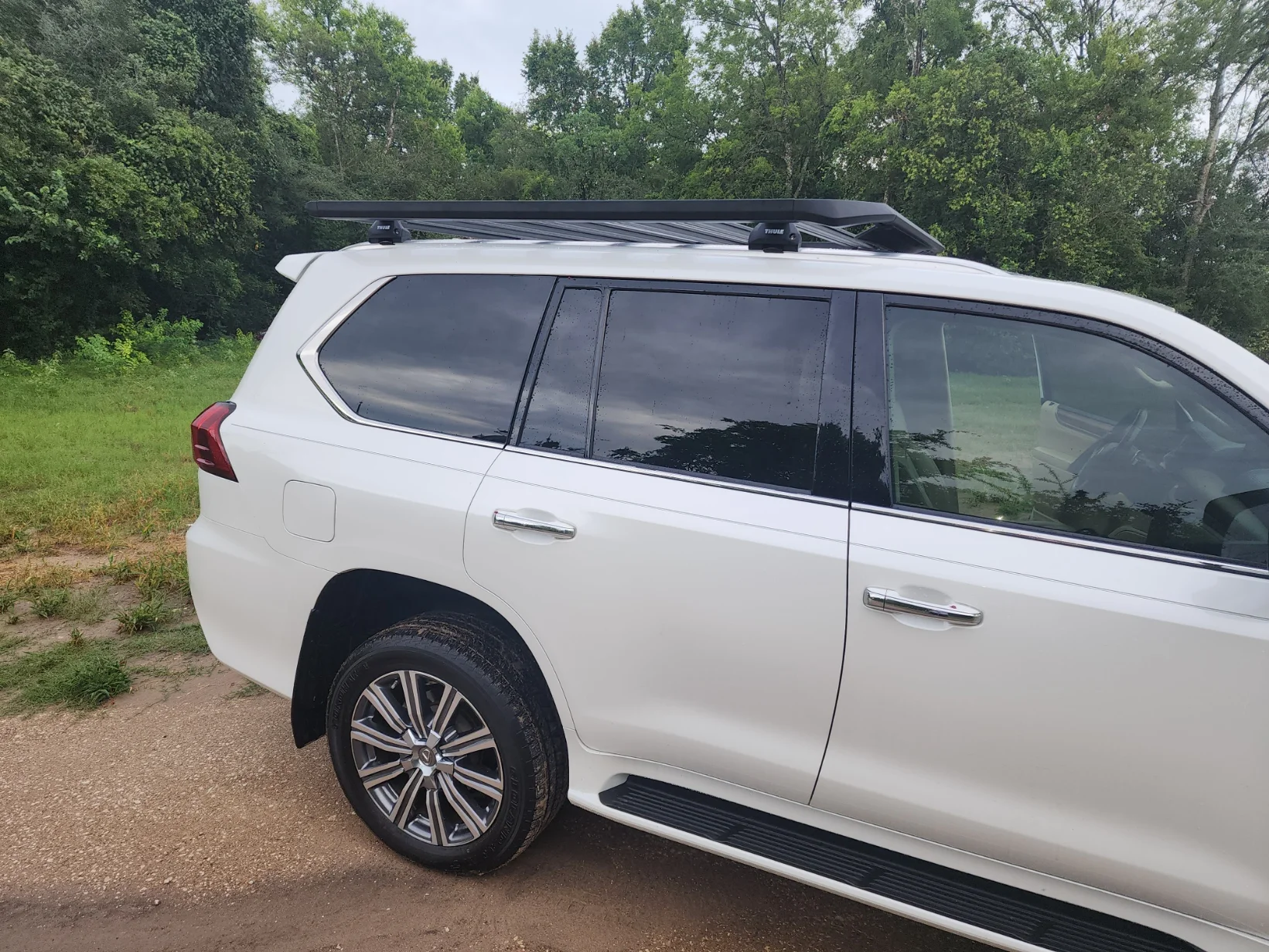

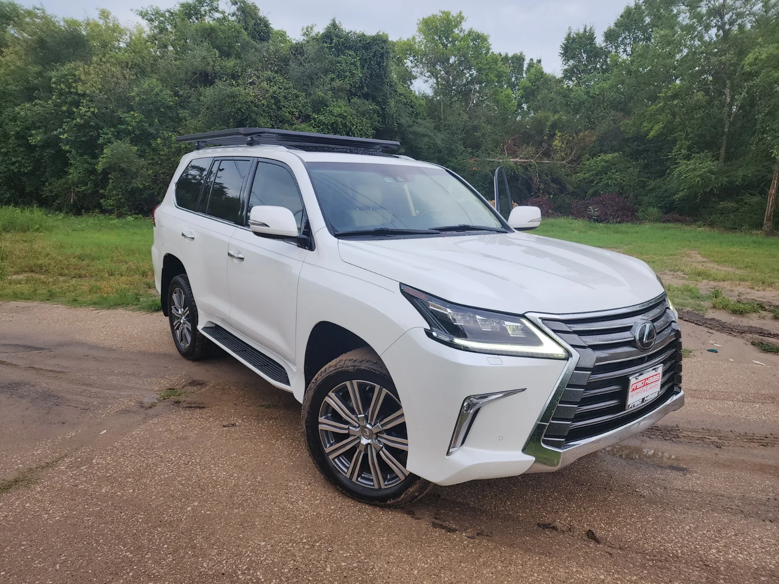

The most dramatic thing to note is that the sides overhang around 5 1/2 inches from the roof top. This rack has a good spread. Strength-wise, I fiddled around with the crossbars and could make individual ones flex, but no more so than my old Front Runner Slimline ll rack. It's sturdy. Once I got it mounted and buttoned up I carefully did my awning test -- stepping up off a tire and bracing myself on just the edge of the rack and slowly putting my 200+ lbs of weight on it. I did this test in the middle -- the weakest point -- and even did some gentle rocking bounces. It held up just fine. I'm also pretty sure that if push came to shove, I could add another set of foot packs at spars #2 and #5 to complement the existing ones at #1 and #6. With the curvature of the roof, adding a tower in the center isn't doable.

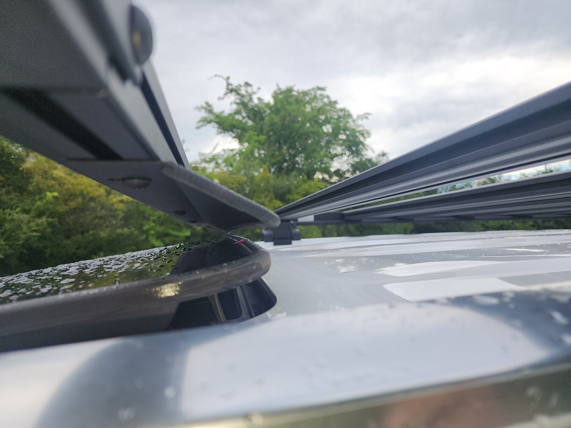

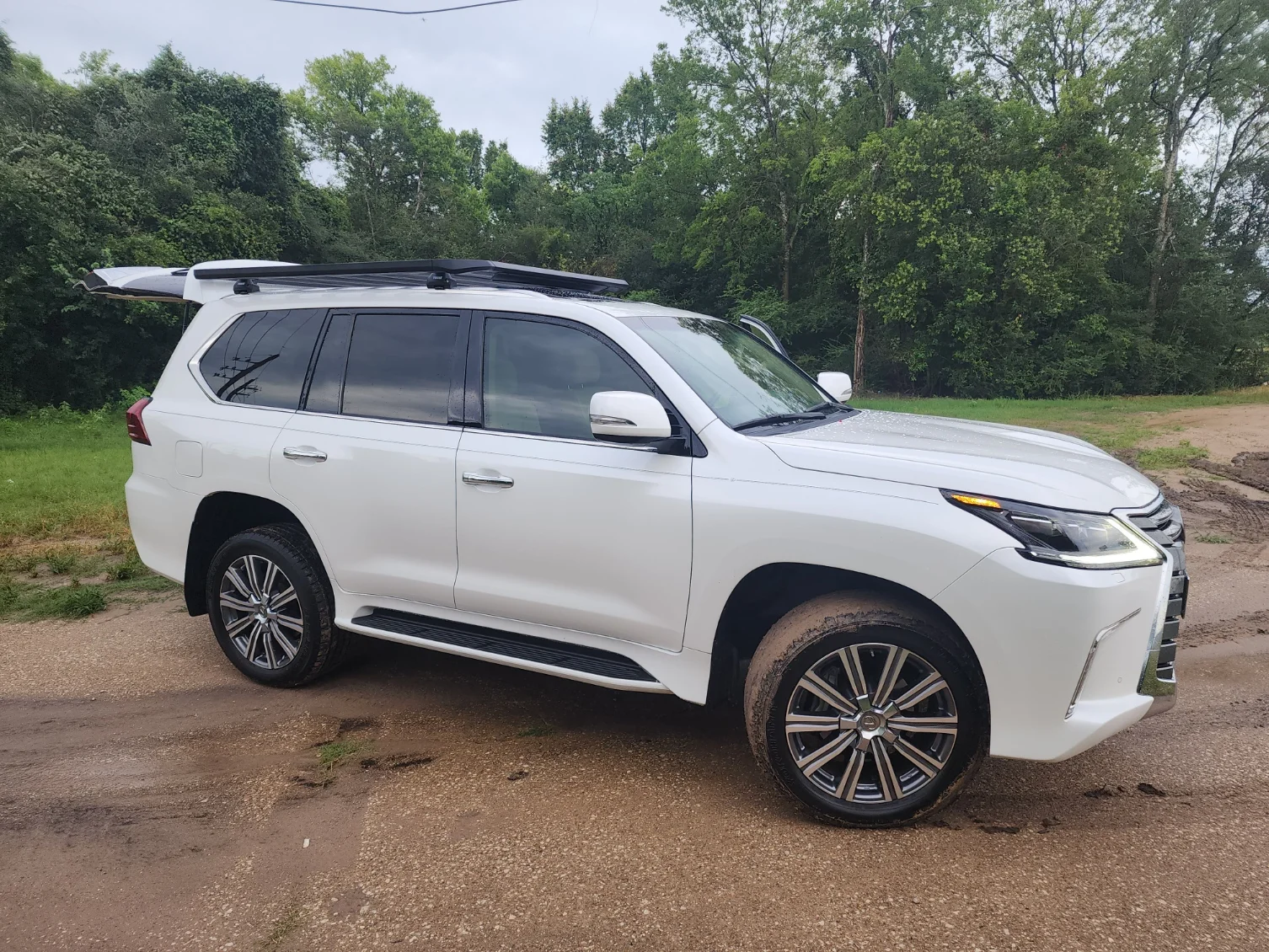

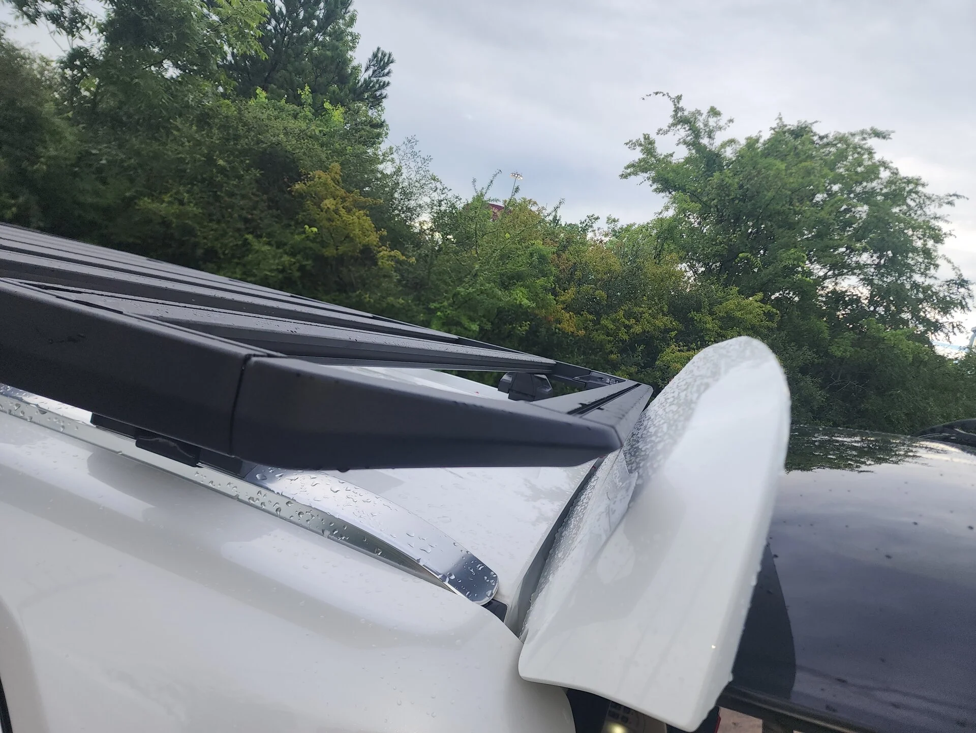

I also tried some of my old FrontRunner hardware -- it doesn't fit. The Thule T-channels are more shallow, but wider. I could add any accessories from the FR catalog, but I'd need to get the Thule-sized nuts. All in all, I'm happy with it. It was exactly the solution I was hoping it would be. As seen in the pictures below, the rack allows both the tailgate to open and moonroof to tilt without interference.

It does clear it, but just barely. The wind noise is pretty damn loud when my roof is cracked/open -- but there's two qualifiers on that. The first is that I'm pretty sure my air dam position is to blame in both roof raised/open. The second is the soundproofing on the roof/headliner closed is so good that I don't notice it even if it were noisy.
