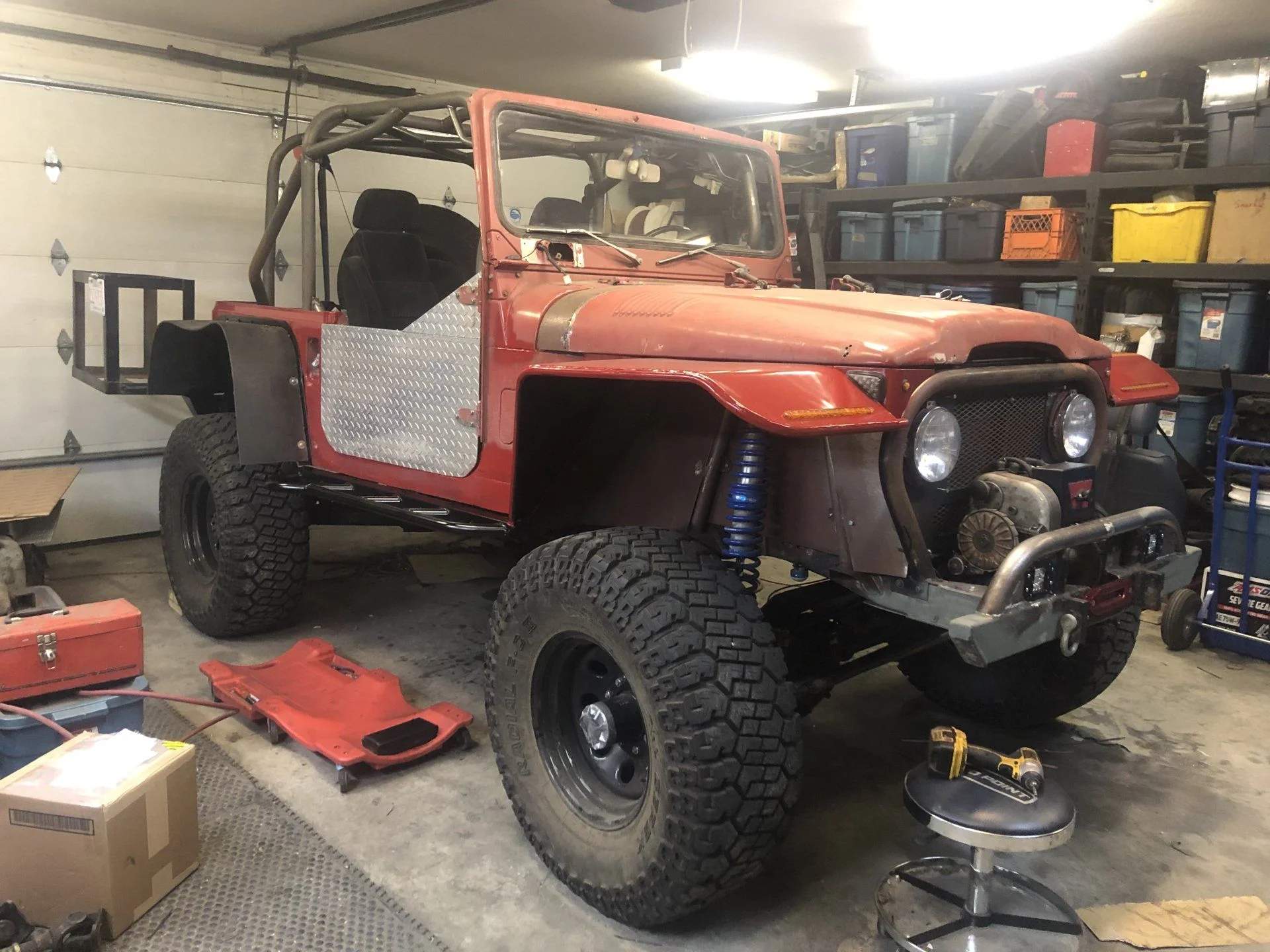

I am building something very similar to what you are talking about. I bought a truck with the drivetrain in it, and then made it fit in my FJ40. It is just getting ready to road-test, so I don't have any wheeling feedback yet. Vortec 350/SM465/NP203/Splitcase I stretched the hood 5" to push the motor forward to get the t-case back in the stock location. There are so many things that I had to do to make that work, and like others mentioned, it a lot of work to make fit in a full-bodied rig with a frame. I used the ruff-stuff rear 4-link and TMR 3-link kit in the front. I have a front Dana 60 from a 92 Dodge 1-ton, and a 14-bolt rear axle. I have 37s on it now, and 40s will fit.
With the rear coil-overs outside of the frame (for passenger room), there was a lot of work to make that fit, and even then, it just barely fits. I also wanted to keep the body with the hard-top to be able to go 4x4ing in sub-zero temps and drive it on the road once in a while.

Thanks for the input, cool rig. I’m not looking for a full body rig or a top. Altough I’m starting to second guess the two seater concept. That may rule this rig out, but not yet. As far as fitting the drivetrain in the stock frame, I pretty sure it’s been done. I’m not thinking of using a doubler. I’m pretty sure the TH400 will fit with a longer wheelbase. Or Areyou referring to the dana 300 not fitting? I think @SuperBuickGuy has one in his rig. I’ll double check his build. This would be a limiting factor as I’d rather not shell out for another Orion. At least not when the atlas isn’t that much more.

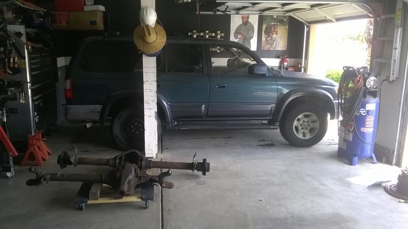

Ok the (potential) saga lapses and the 40 shell is sold. The desire is still there and more likely morphing into a 4Runner truggy. I love the idea of it being fj40 based, but I should really have 4 doors. Sooo There is a 97 3.4L manual for sale locally. Needs a transfer case repair/replacement, but said to run (208,000 miles). Body is fair to ugly-perfect. What’s the build progression with something like this for a starting point?
Will the 3.4 realistically turn 40’s ?
Stock transmission and transfer be up to the big meats?
IFS out for straight axle(60)
Matching rear 60
Exo cage for cab
Doubler case

I was looking to use the engine transmission and transfer from the 4Runner on this build. I had a 3.4/5 speed in my old T100 and it left me with a good impression. The desire for tons is for something I don’t have to worry about. So @WILLD420 what do you recommend in terms of a build? At this point I’m really open to any build plan. That bring said, my 40 is built for the majority of trails out there. The 4R would be built so I don’t worry about potential damage the remainder of the trails might dish out.

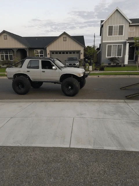

How do these fit into your goals?
A 3500 lb rig with 195 HP is a good start. Maybe a truggy style 4runner?
3.4, dual cases, gm metric 9.5 semi float rear and a good Dana 44 front on 37's will go a lot of places. You could use Toy axles too. 38's are doable but you are playing dangerously without top shelf axle shafts.
