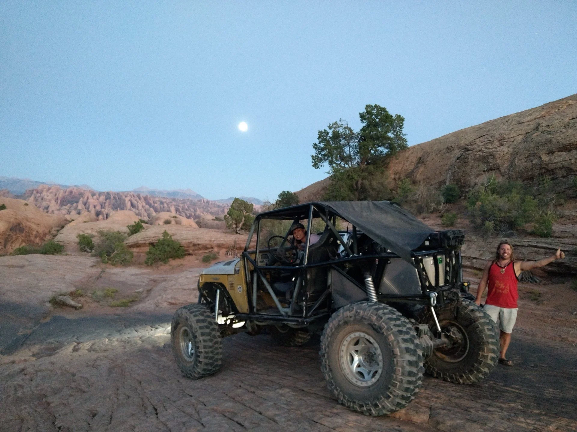

Have plenty of lessons learned, mainly that my build was a progression over time that resulted from wanting to keep up with others and/or upgrades after carnage resulting from keeping up with others, versus having a clear vision of where I wanted to be - and skipping to the end (at least you're skipping that mistake). Granted, I didn't anticipate adding two more boys to the family, changing the direction on my last upgrade, which included a fully caged rear so I could fit a fully harnessed rear seat for the two kids.
That said - for what you're envisioning, would almost recommend starting off with a tube chassis/full buggy. Trying to work from the Cruiser frame and safeguard a cowl/front clip that will likely get tweaked when trying to thread thru narrow crevices, much less a few flops/rolls, is an exercise in frustration. What I have and what you're looking to do - is 10 years behind the curve - and while plenty capable, often times can't do what cheaper/lighter formula Toy buggies or other similar stuff can do.
Otherwise, think the best mod was going to a shaved 14 bolt with Detroit and disks.
All that said, love FJ40 buggies, so hoping you resurrect the project from the first post...better grab it before someone else does.

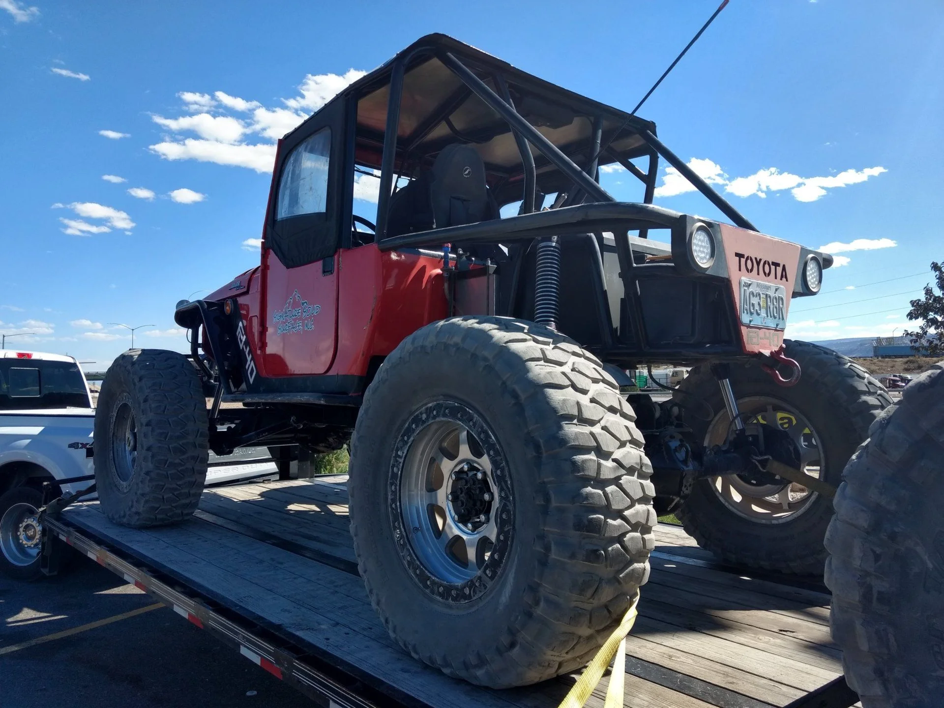

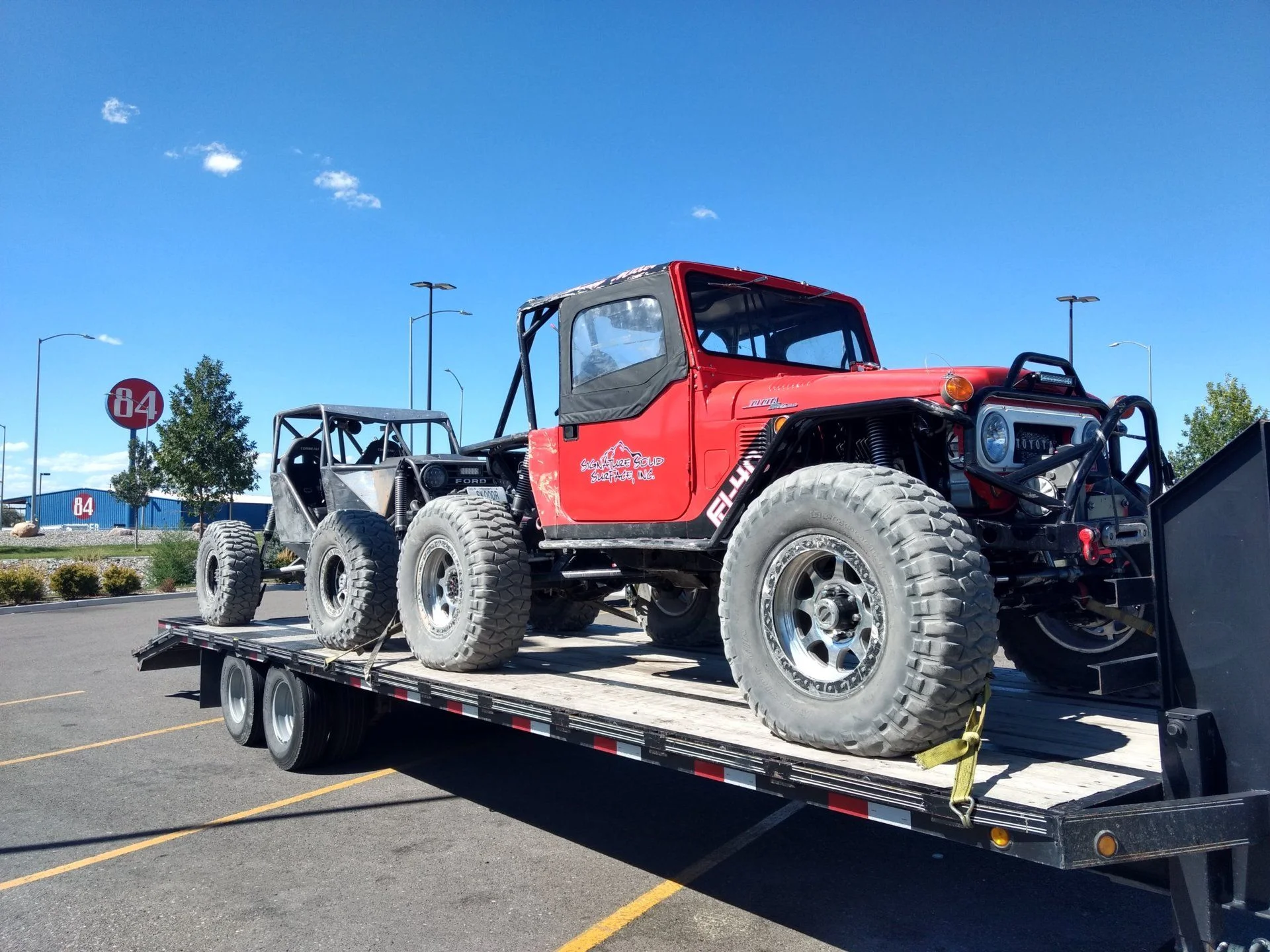

Here's one I saw just outside if Colorado into Utah last year, it ticked off all the items you have listed in your build sheet.
I don’t remember saying I wanted it to be red!!! Looks sweet.
I kinda figured with this starting point of a hacked up forty, I wouldn’t have to worry to much about body damage. If the hood and bib are good shape I’d be swapping them for my current dented hood(forgot to latch it on interstate) and rusted bib. But maybe you’re right, I’ll look into a buggy chassis. I think it’d have to be in the same price range for this project to work. I’d assumed all the tube Chassis would be in the 5k and up price range.
