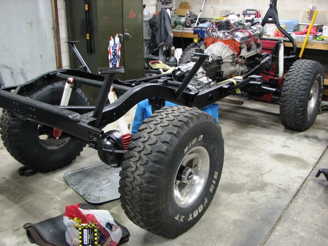

This is what I did.
Kent - do you have any pics of your setup? I hadn't contemplated this approach before, but several folks are recommending it.
