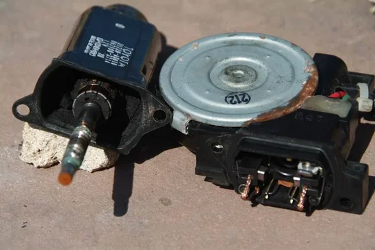

I cleaned my switches (pictured above) with contact cleaner, reassembled and reinstalled. No better.
based on this thread and others, the following things can cause issues with the 80 electric windows (followed by what I see as the 'best' fix)
