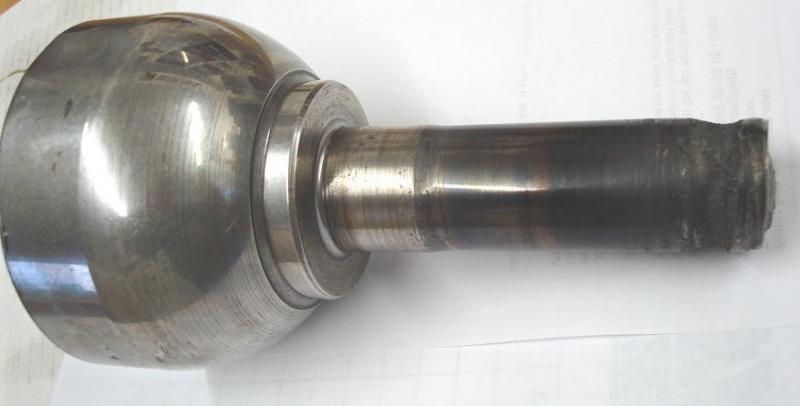

CNC "scoring" is fairly common on 90deg turn areas. Its very easy for this to occur and is really a MANUFACTURING and CNC programming issue. In theory the design should be okay.
Combine slight "scoring" with the added stress of heat cycles from bearing failure/wear and you have a recipe for failure.
Whose fault is it? Neither BOBBY or the customer really.....
To me it sounds like a manufacturing issue coupled with customer issue(bearing).
ID Like to see the pic personally.
EDIT: just saw the pic- thats a bad bearing failure issue for sure.......not manufacturing or design
Id grab a used stock birf and call it lesson learned on bearing premaintenance.
So 3 months 4000 miles after they were put in, one failed due to no lubrication on the bearings...seems like your bitchen about the wrong person. Makes you wonder what wasn't done on the other side thats now failing? What would make a bearing run dry at 4k miles?
That is definitely not a manufacturing issue. That was an installation issue.

The shaft is broken just below the base of the bell.
Thanks, I read it again, it was 14 months 4K miles and it broke at the end of the shaft and not at the base of the bell like you told him? I completely missed that the first time.
