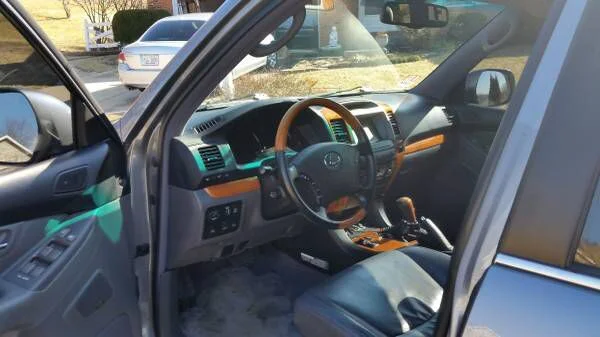

- What might the seller be referring to with "sport suspension?" Adaptive Variable Suspension?
- Can anyone tell by the pics whether or not it has KDSS? It doesn't have smoked lenses or dark grey wood interior, so I'm guessing not.

I looked quite a bit for a KDSS version before getting a GX470 without. I found many online posts (usually be $tealerships) that stated the car had the Sport Package with KDSS. It almost always did not, the sales-weasel just did a cut & paste of every possible option package into the car description. The black (dark grey) interior wood with the metal surrounds around the Nav system are the easiest way to check for the sport package when you're looking at someone's ad.
The best option is to look underneath the truck for the big hydraulic piston (you can search for pics of what it looks like under the truck--I kinda forget where I found them). That's an easy solution--it's either there and you have KDSS or it's not there at all and you have a standard truck.
Also, the adjustable suspension (where you can tune the shocks on the fly with four settings) are also called a 'Sport Suspension' by some. It's a bit misleading and potentially confusing, but there you are.
I found the Sport Package option to be quite rare and I'd imagine that a KDSS package on a non-sport GX would be rarer still. But I don't have hard numbers to support that.
It's irritating that the KDSS was a relatively small add-on price for an expensive truck and yet it seems to have been rarely asked for. Not much call for it at the mall I guess. ;)
I have to say that I am very happy with the handling of my GX 470 even without the KDSS. But I can empathize with the desire to have all the bells & whistles. The package adds only a few hundred dollars to the cost of a used vehicle, it's just tough to find one.
Hope that overly long answer helps. ;)
As others have said, only sure way to tell if it has KDSS is to look under the truck. It is possible this a non-Sport truck with an individual option for KDSS. However, looking at the truck, it does not appear to have the Sport package. While the smoked lenses are very subtle and might not be visible in a low-res photo, the interior is definitely wrong. It should have black bird's eye maple, not the standard wood color as is shown in those pics. And the center stack wood around the nav/radio is deleted in the Sport trucks and replaced with metallic-colored plastic.
I can tell you that KDSS definitely makes a difference, at least on-road (have not wheeled this truck, it is a kids car-pool mini-van substitute for now, so couldn't tell you how it works off-road). We stick the suspension in "Comfort" to maintain that Lexus ride, but the KDSS basically allows it to corner flat. I'm so glad I held out for ours!
I'm glad I held out for KDSS as well. I also really prefer the black wood. I didn't think I'd like it at first, but now I'm really happy with this choice.
It does not have KDSS. Unless I'm mistaken, KDSS was offered with the Sport package only and included the black/gray wood trim. If the wood trim is brown the truck is sans KDSS

KDSS was available as a standalone option, but I have yet to see a non-sport truck optioned with KDSS for sale.
Thanks, everyone. I've learned a lot about the GX470 over the past few days. Unfortunately, the seller is unresponsive. Fortunately, you helped me confirm it's a non KDSS truck (I guess there's a very remote chance it has it). Now I'm on the search for another!
