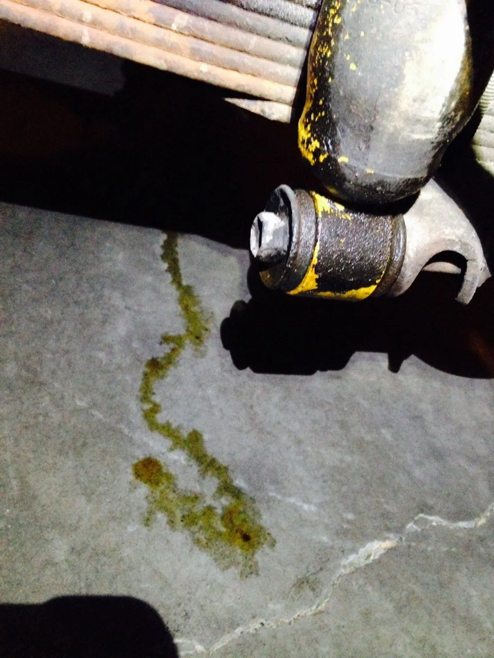

One other thing I discovered leads to a couple of questions. While looking at suspension, the shocks, mostly covered with undercoating/dirt appear to be yellow so I naturally assumed them to be OME. However, after a little scraping, the shocks are actually Oz Tech brand. Of course, I had never heard of them so I did a search and there isn't a lot of info that I can find. They seem to be a decent shock but I'd like to know more. From information I did find, it appears that they carry a lifetime warranty so that leads me to believe they must be pretty good. Is anyone running these or know anything about these shocks?
The oils not from the swivel hub is it
I'm not sure what a swivel hub is exactly but I'm pretty sure the shock is gone. Its a little disappointing as I would liked to use those funds for
something else on my list of needs but, oh well. Sorry for the poor pix. The daylight is gone for the day. Thanks for opining...
Yeah she's rooted mate the shock that is. swivel hub is a steering knuckle

If you can afford Koni there the best in my book as they can be adjusted for ride and rebuilt when there spent.
I'll look into Koni. I knew they had extensive experience in the sports car world from my days of driving old BMWs but I didn't know they produced an off road shock. Makes sense though. I'll check them out. Thanks. They must be spendy...
The shocks from Toyota are koni shocks with Toyota sticker on them normally cheaper to get through Toyota here then from other sources
