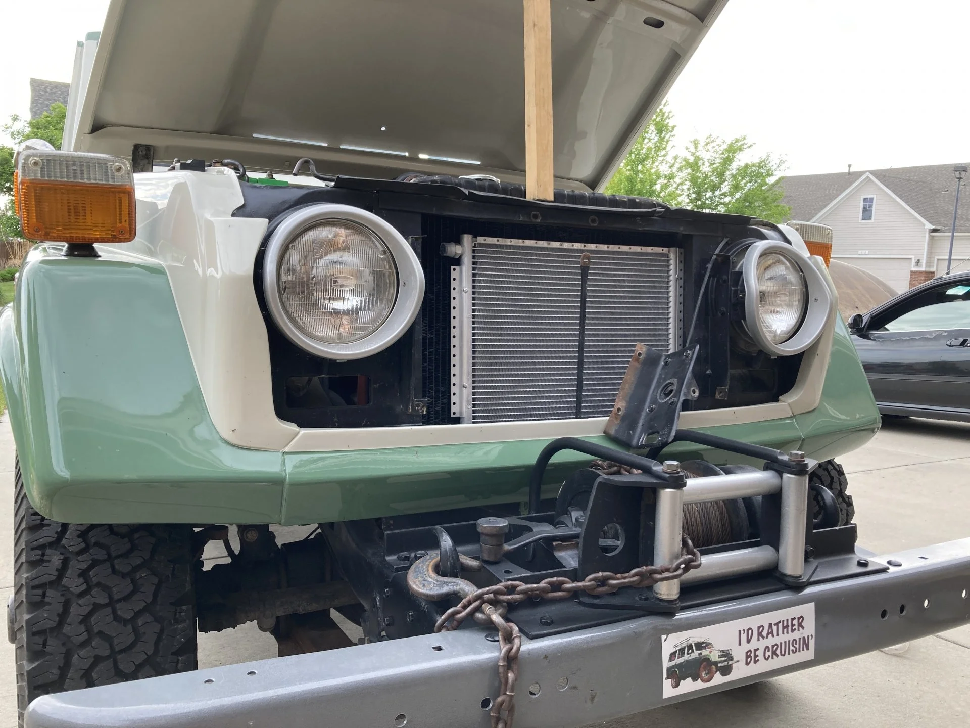

I have some good details about my AC progress (or lack thereof) around here:|

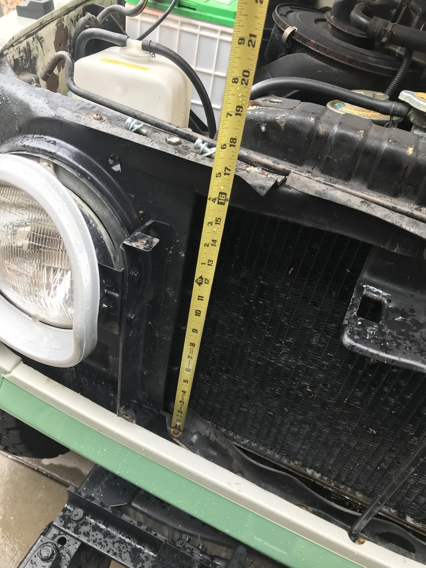

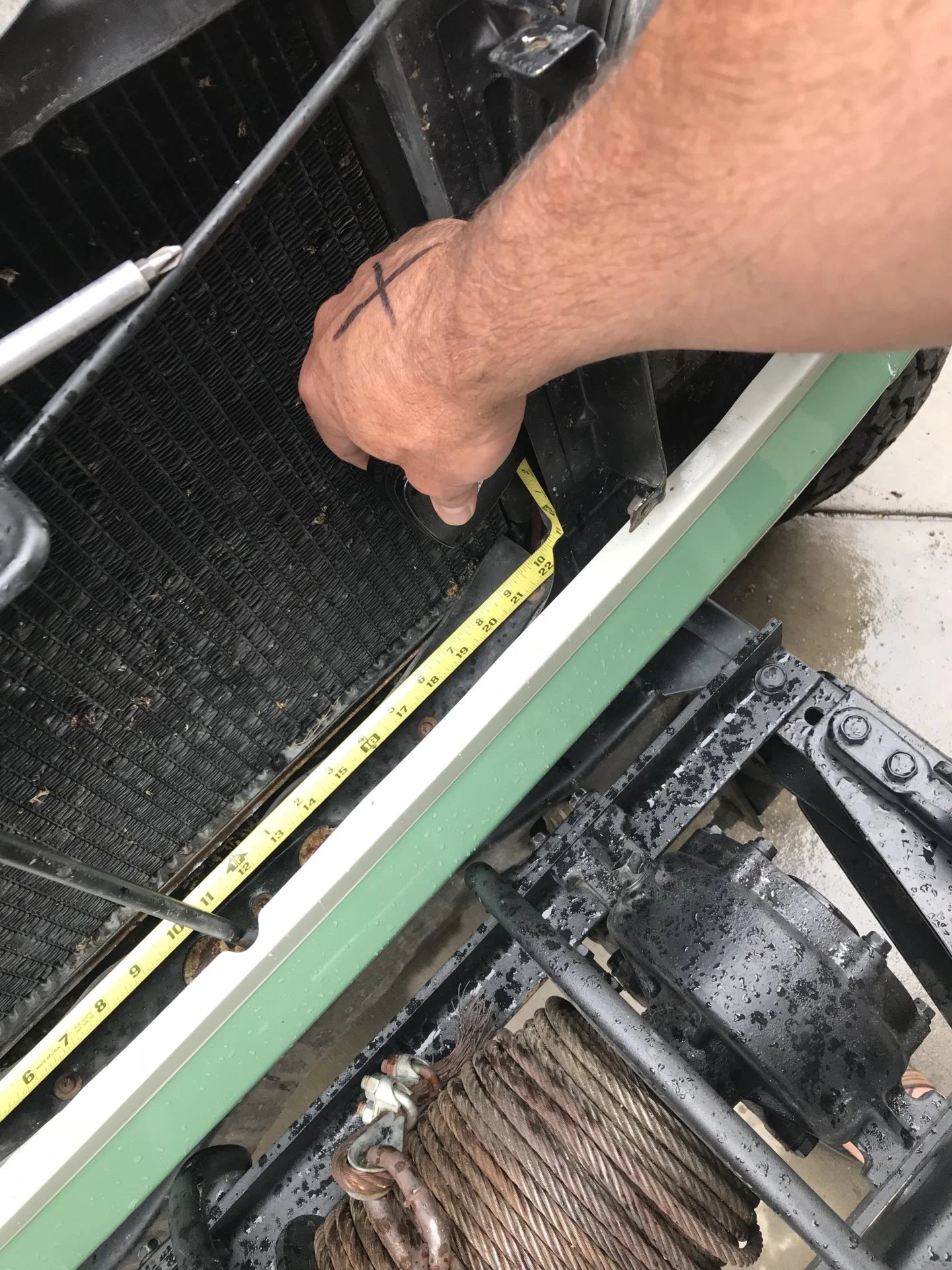

Here is where I measured the opening (wait, what?) to see how big of a condenser I could fit:

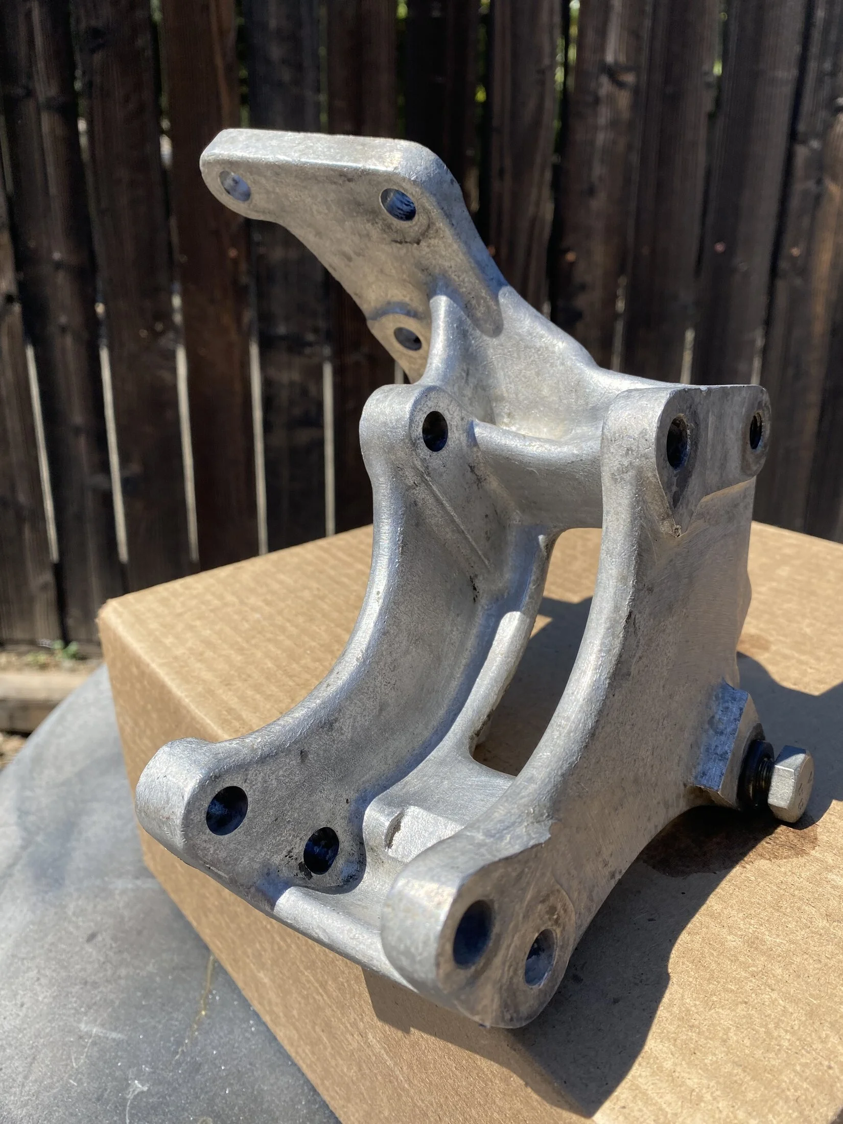

Need information on sanden compressor, I have the mount for a sanden compressor for a 2F, but not sure which one that will take the larger stock 2F belt. Any help appreciated I have this bracket
