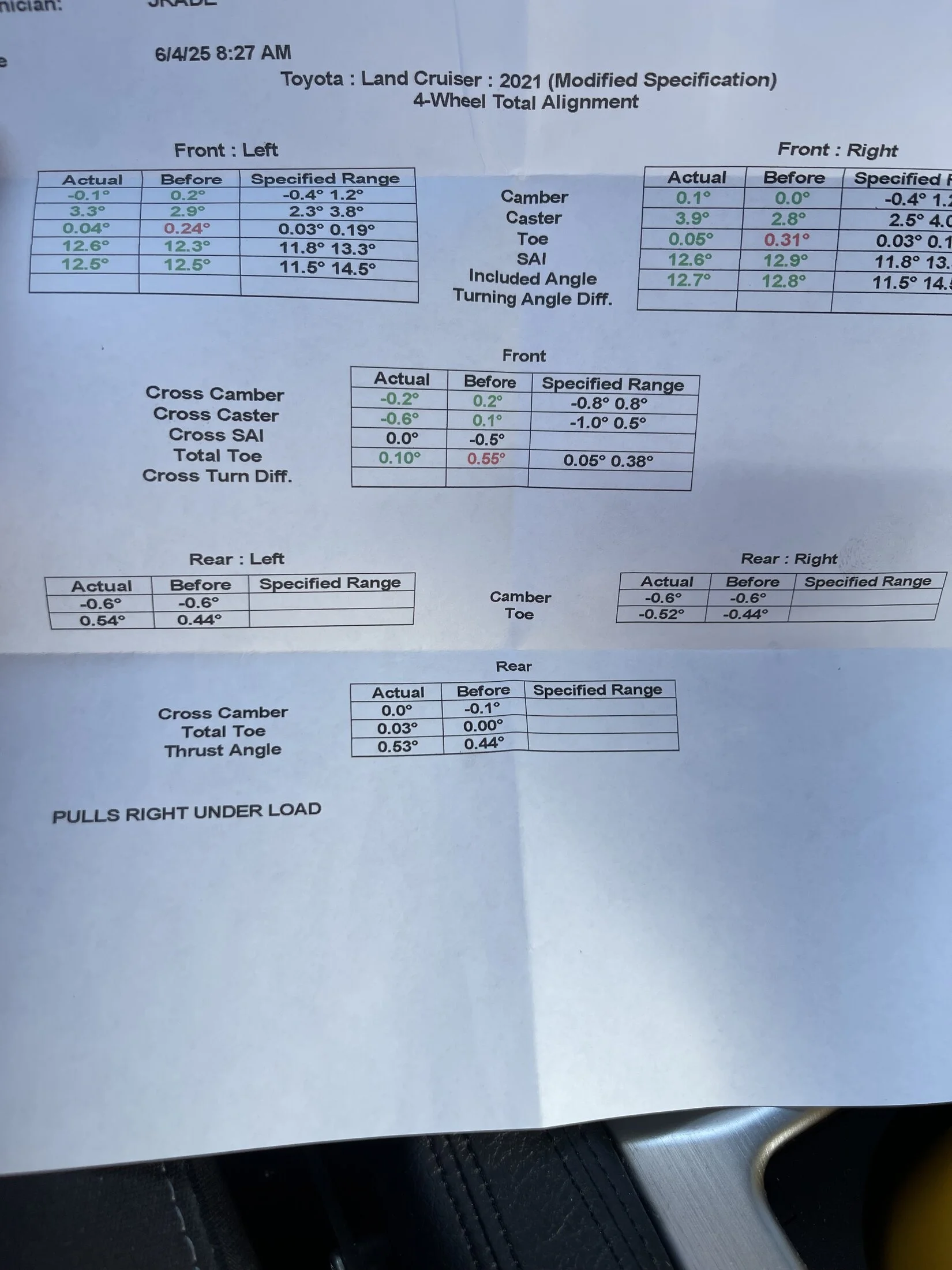

Ok so I just wrapped up with Mitchell’s precision alignment and I really wish I had these guys closer to home. They aligned vehicle but also found that I have some bushing play on the rear of both LCA’s and bushing issues on the steering rack.
Currently sitting at 35955 miles but outside of warranty on time.
Give me some recommendations moving forward. I feel like I just replace with OEM bushings when I return home is a few weeks but I’m open to suggestions.

I had in my notes to square up the caster but did not get them the same but he said that where it’s at now should help. I really need to get more educated on suspension.

We always intentionally have more caster on passenger side than driver.
Ah, that looks much better. The toe was out of control previously. I wonder if you're also doing the alignment now weighed down with stuff on your current trip? Still, should feel much much better.
I don't buy that your bushings are worn at that mileage. It's a Land Cruiser and it has robust bushings. Yet as a Land Cruiser, it also has large bushings for compliance in the rough stuff - which allows a certain level of play in all joints - very normal and healthy.
Yeah, I was a little surprised to be greeted by the owner of the place with the first words out his mouth being “are you still under warranty?” Then describing the bushings. He said the same thing you did, “these usually don’t need replacing until 130k plus.”

On the short drive back to the laundromat where I left my wife, completely out of her element, it does drive much better. Not perfect, still a slight pull to passenger side when applying power.
Idk if it’s bushing or if a perfect alignment isn’t possible given the weight, build, and use case of my cruiser. It’s also completely possible that this is how it drove when I got it new after all the modifications and I have forgotten. What I do know is that once the alignment went out the first time I’ve been chasing the dragon ever since.
How would I best test this bushing theory?
