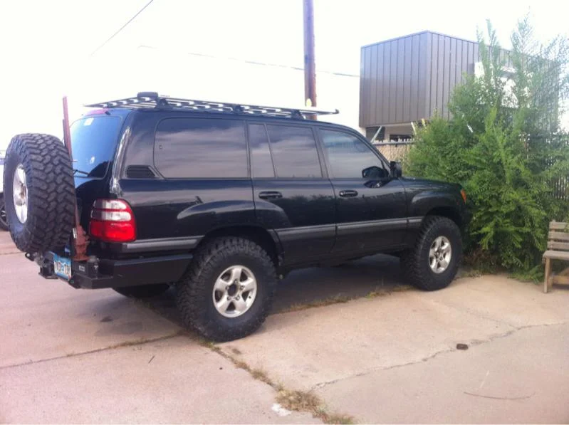

35s mounted!
35s = No Power
35s = look great
35s = Mo Betta off-road
Guys, I am regeared. These things are heavy!!!
I see a supercharger in my future
I also live at 4500 feet which does not help things.

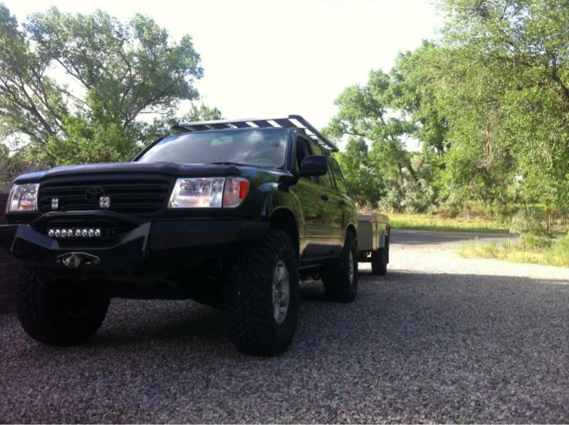

Hittin' the road for 100s in the Hills.
jon how much to those weigh?? I know we are not good on gas mileage but what was the hit once you went with these?? I se the trailer and you usually have lots of gear what is the MPG? Mostly concerned with range of vehicle with the available tank and maybe a few extra gallons on back. thanks

Oh yeah, pic. 295s, stock AHC in N.
