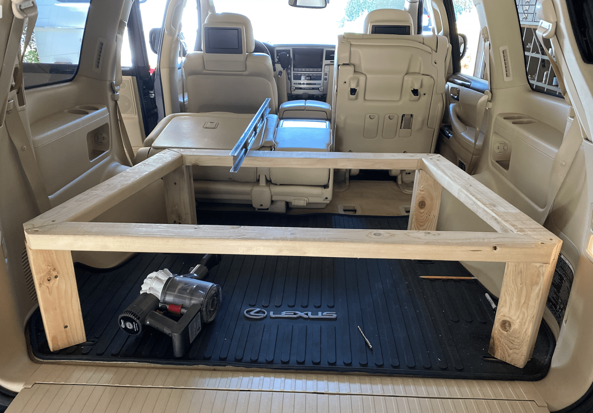

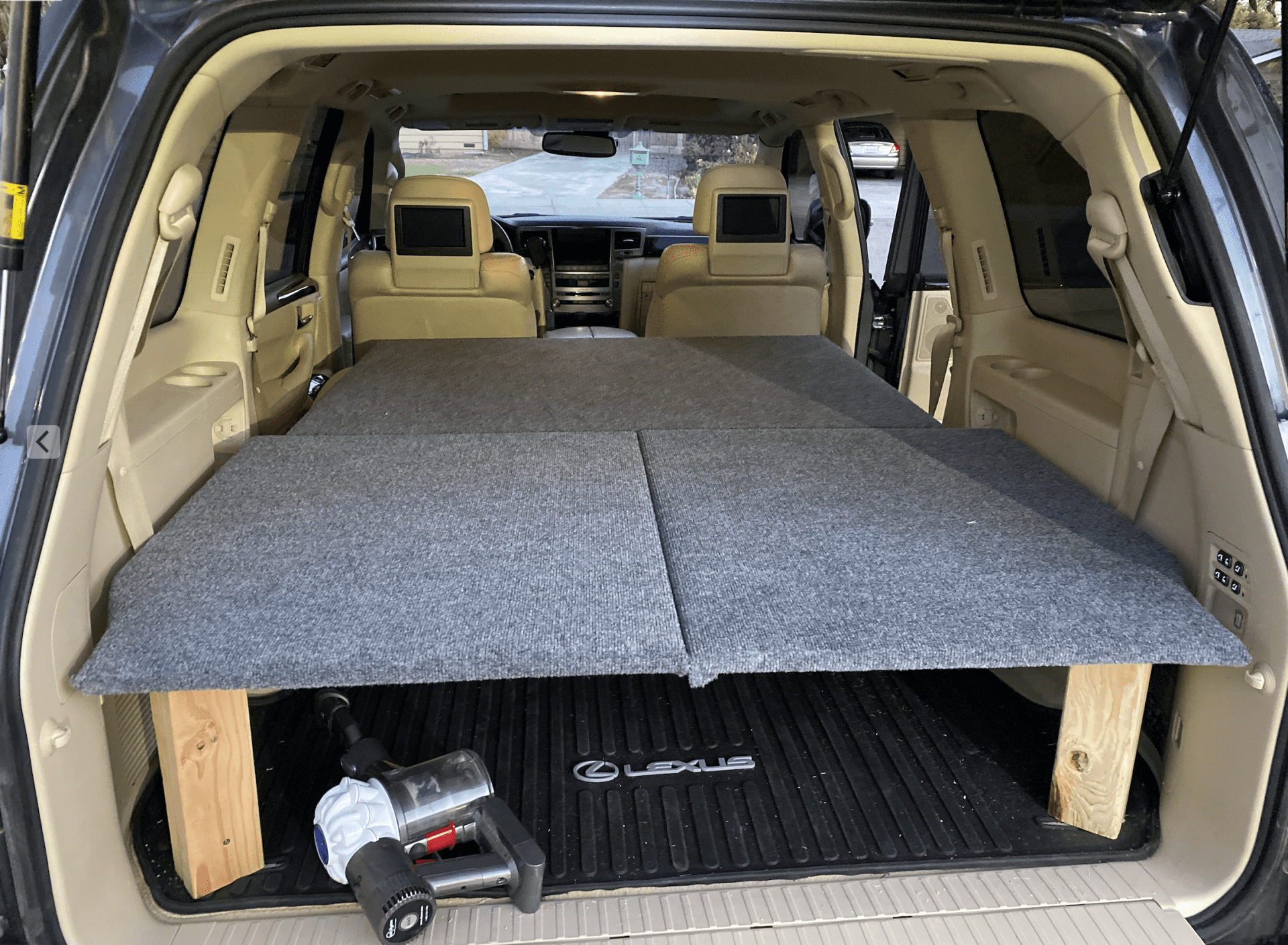

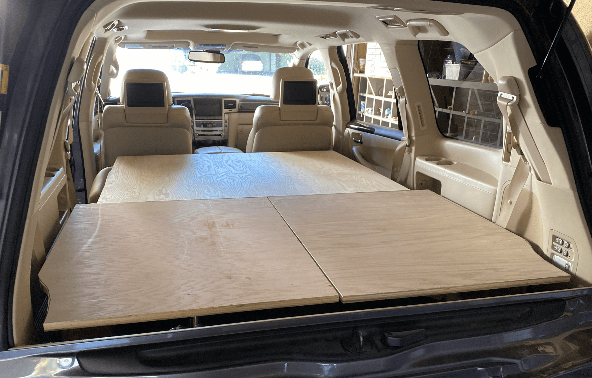

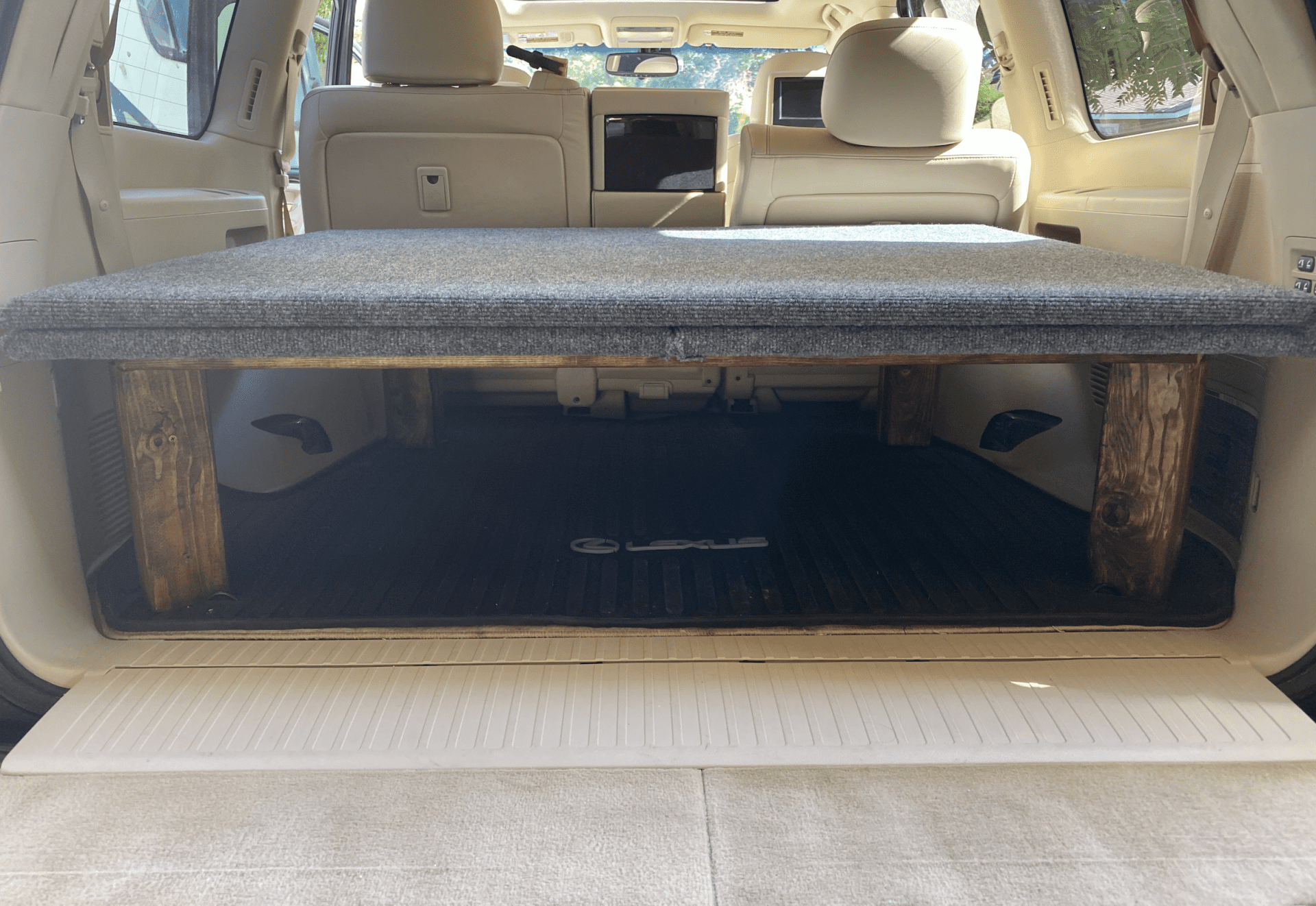

  • Built a sleeping platform.
    • I considered drawers, but they are (1) generally expensive and (2) limit flexibility in terms of carrying things like long camp chairs. So I built the platform on 4 legs with 2x4s for the frame. The three panels (3 /4 inch plywood) are easily removable to grab things underneath.
    • I then purchased 2 home depot Ridgid crates that fit perfectly underneath.

Sleeping platform built part 1. Leaving lots of flexible room underneath for all kinds of stuff.
Three pieces of 3 /4 inch plywood that will be the sleeping platform.
Carpeted all 3 pieces. It was pretty easy to do with a cheap manual staple gun. Used outdoor carpet for this. This platform fits the Exped Megamat Duo 10 Long Wide perfectly.
Stained the wood and pulled up the rear seat. Tons of space underneath, and to someone looking in from the outside it looks pretty like a "stock" cargo cover. Total cost was well under $200 in wood, plywood and carpet.
