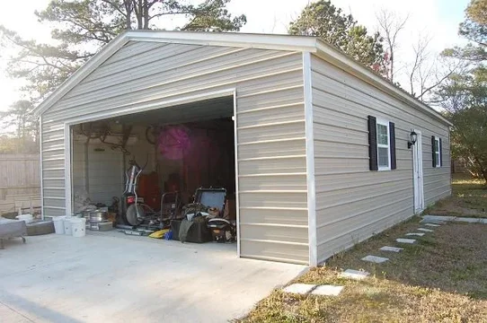

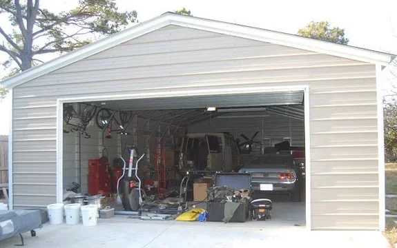

My wife and I are selling a property where my shop was. A wonderful 30' x 60' metal 3-bay with 12 ft ceilings and tall doors. Our plan now is to build a second garage at our house which will require downsizing and adhering to some HOA guidelines. Maximum footprint size can be about 28' wide x 30' deep. The existing attached garage is 1.5 stories with a bonus room upstairs so the new one will need to be similar but we still have some freedom.
The question ... What features do you want in your wrenching garage?
Would you rather have one big door or two singles?
Would your door choice change if you were installing a lift?
Must have good wall space (ie not too many windows) for tools, benches, welder, plasma cutter, compressor, etc.
Plenty of receptacles and 220 outlets.
Have a Bathroom or save the space? A utility sink?
What kind of hvac?
What else?
