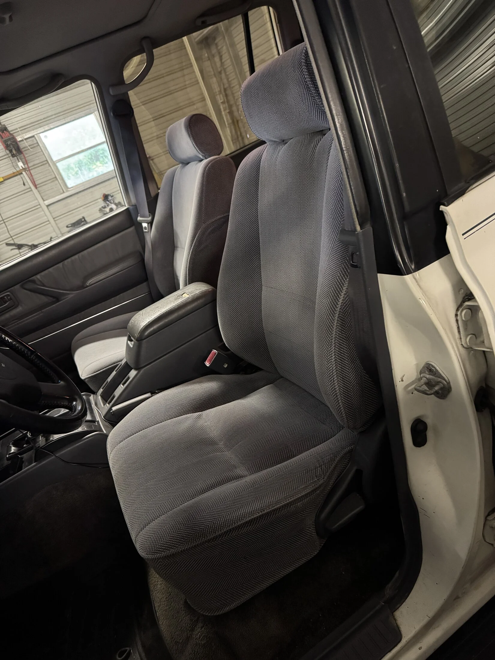

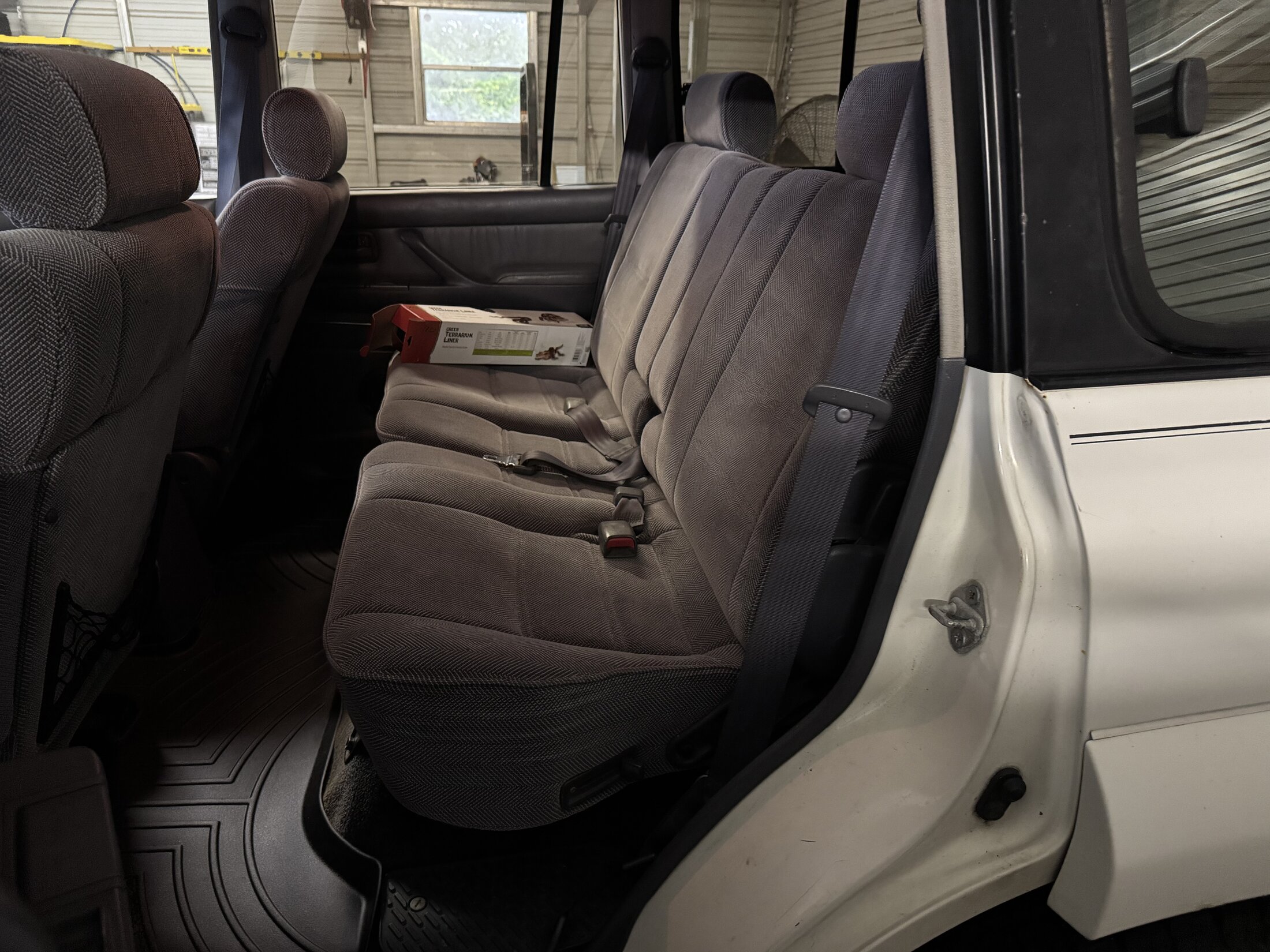

View attachment 3939158View attachment 3939159View attachment 3939161View attachment 3939162
I'm really digging those seats....
It is a beauty! Same paint and interior as mine (but the body is in a lot better condition!).

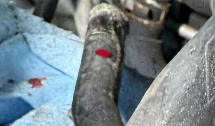

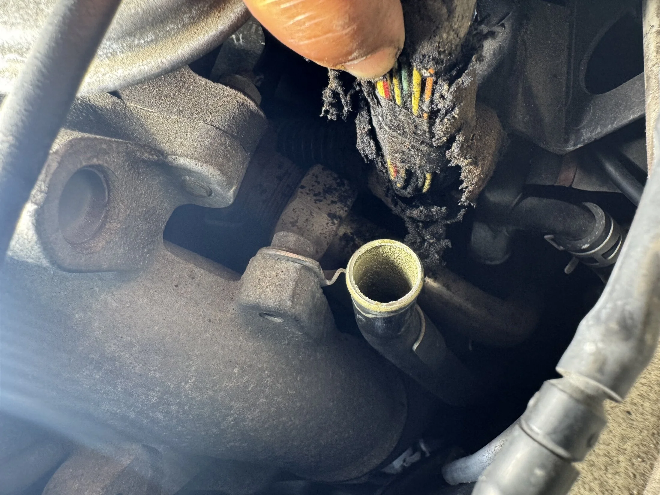

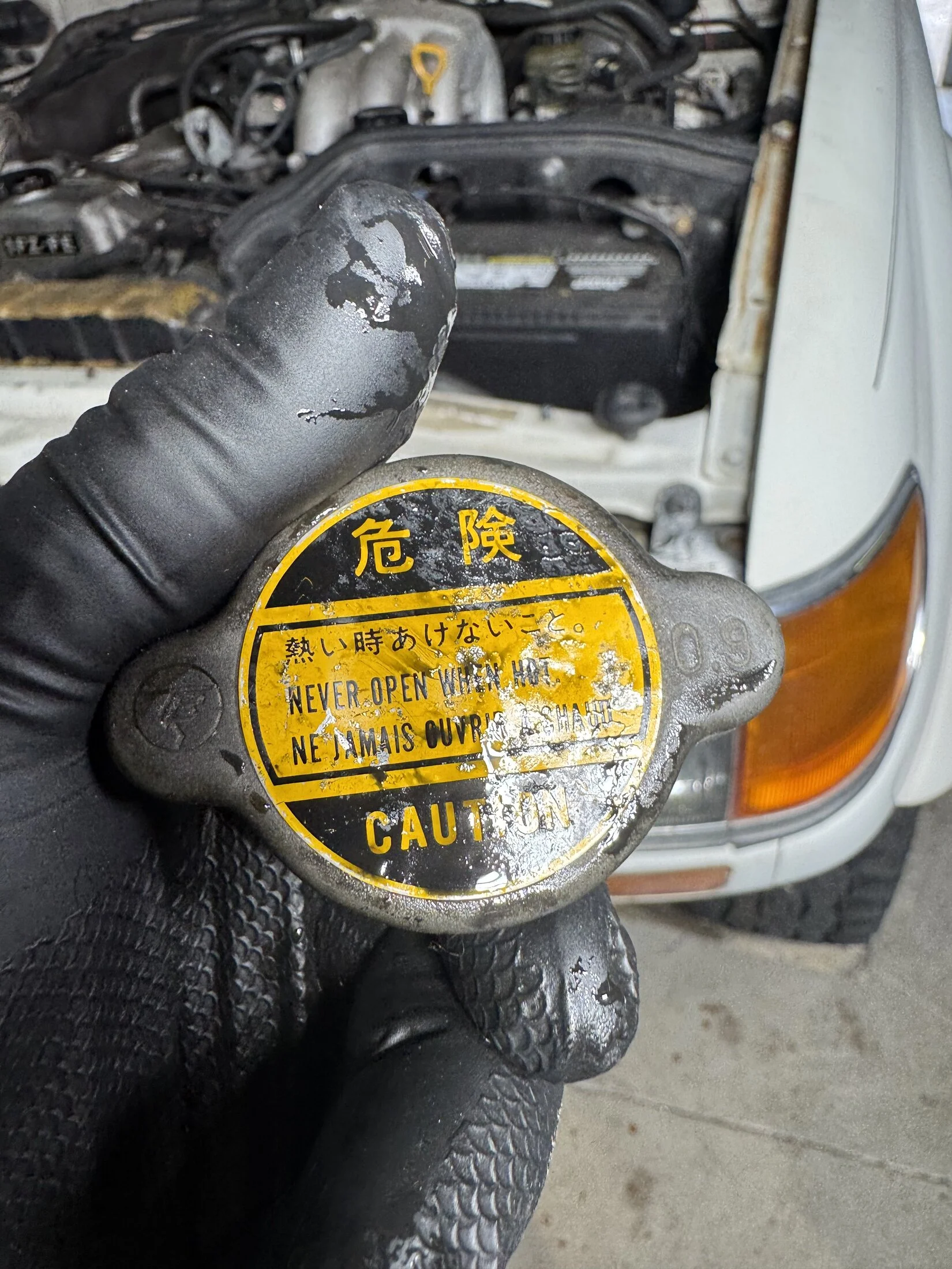

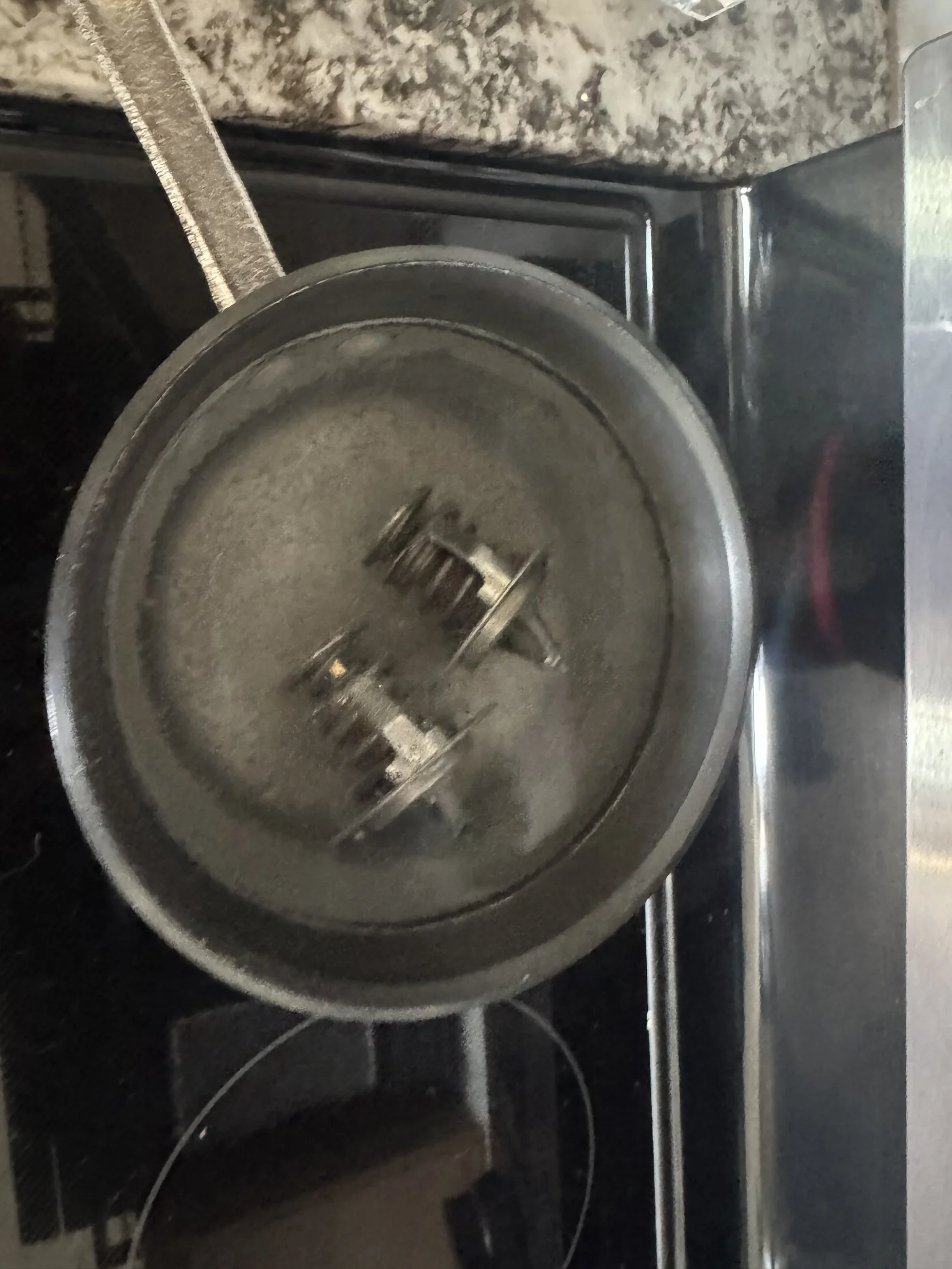

Two days ago my wife told me she smelled something sweet when she shut down the cruiser. I opened up the passenger door and felt the carpets and luckily they were dry.
I checked the Rad cap. Pretty old but OEM. Pretty old though. Compromised gasket. Spring was fine.
Checked the radiator and see no evidence of milkshake.
Checked the dipstick. Good to go. (Gtg)
Checked the thermostat. It’s Toyota so that’s good. Jiggle valve at the 12:00 o’clock position. Threw the bitch inside a pot of hot water and she didn’t open until over 200°. Simple fix.

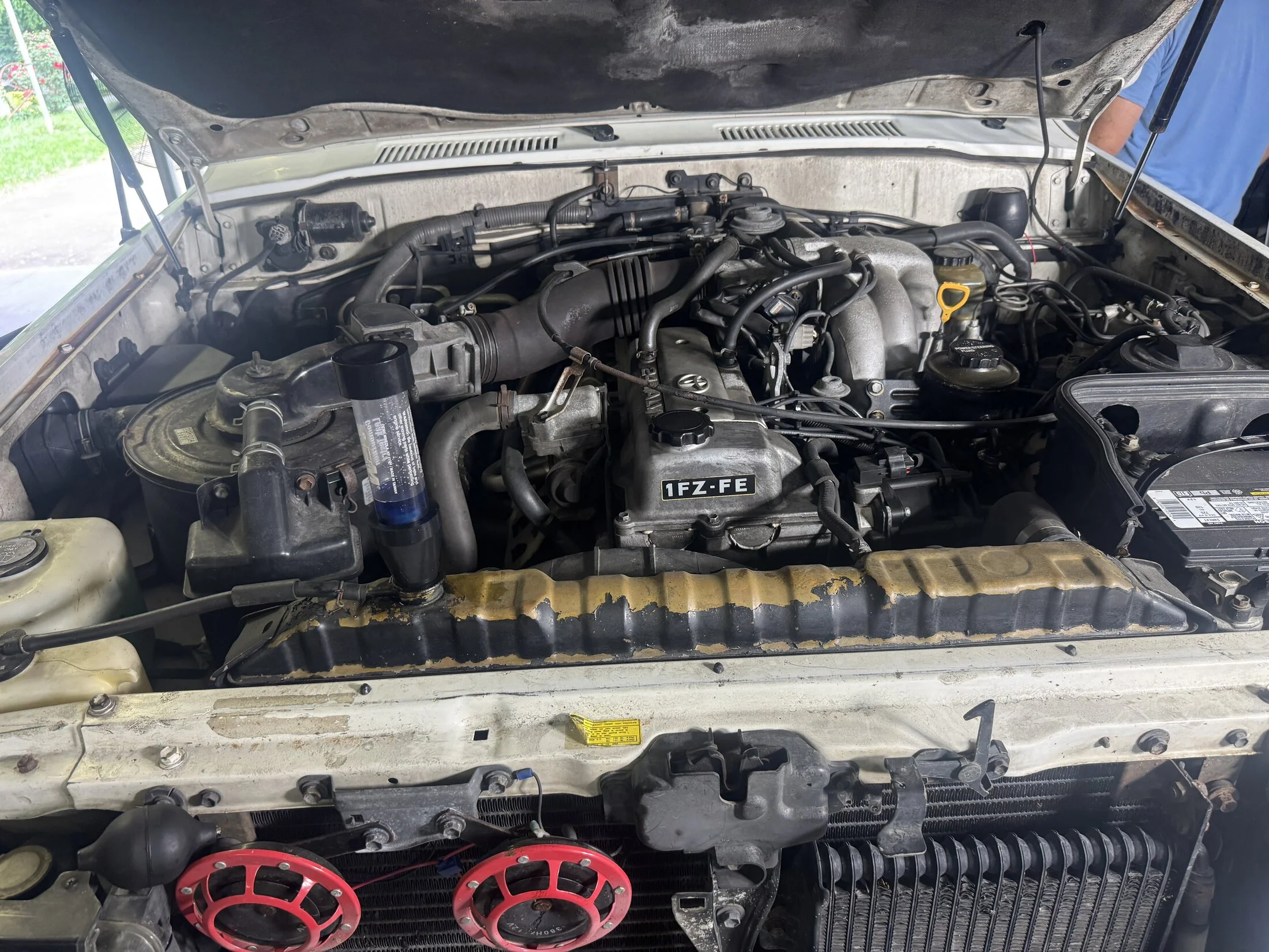

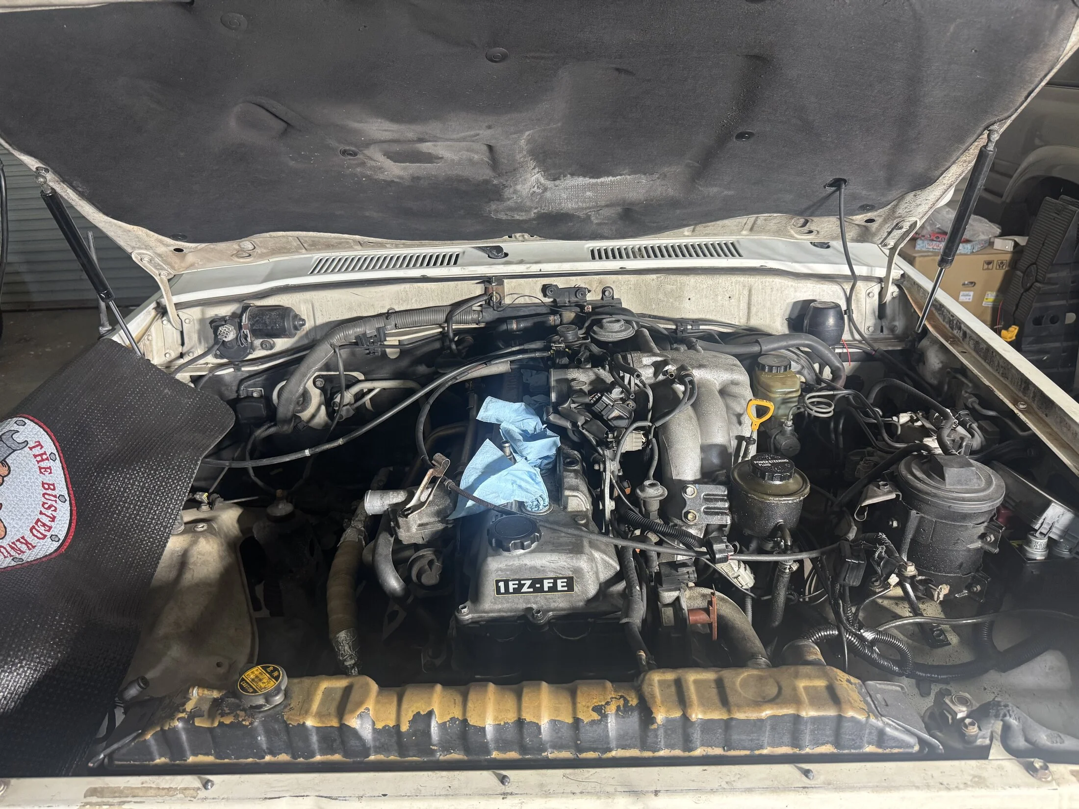

Now, I’m in the engine bay and it’s barely torn apart, so instead of performing an extensive baseline, fixing things that sent broken, I plan to replace the big items, HCV, PHH, wires, plugs, distributor, etc.
Already purchased a slew of parts, including new OEM brake calipers, rotors, short block (though I ended up not needing it. It’ll go to my other 80) and a bunch of other s*** I can’t remember why I bought or where it goes, so I have to get back onto Partsouq and figure what and why I bought what. Fun stuff.
Old is still closed.

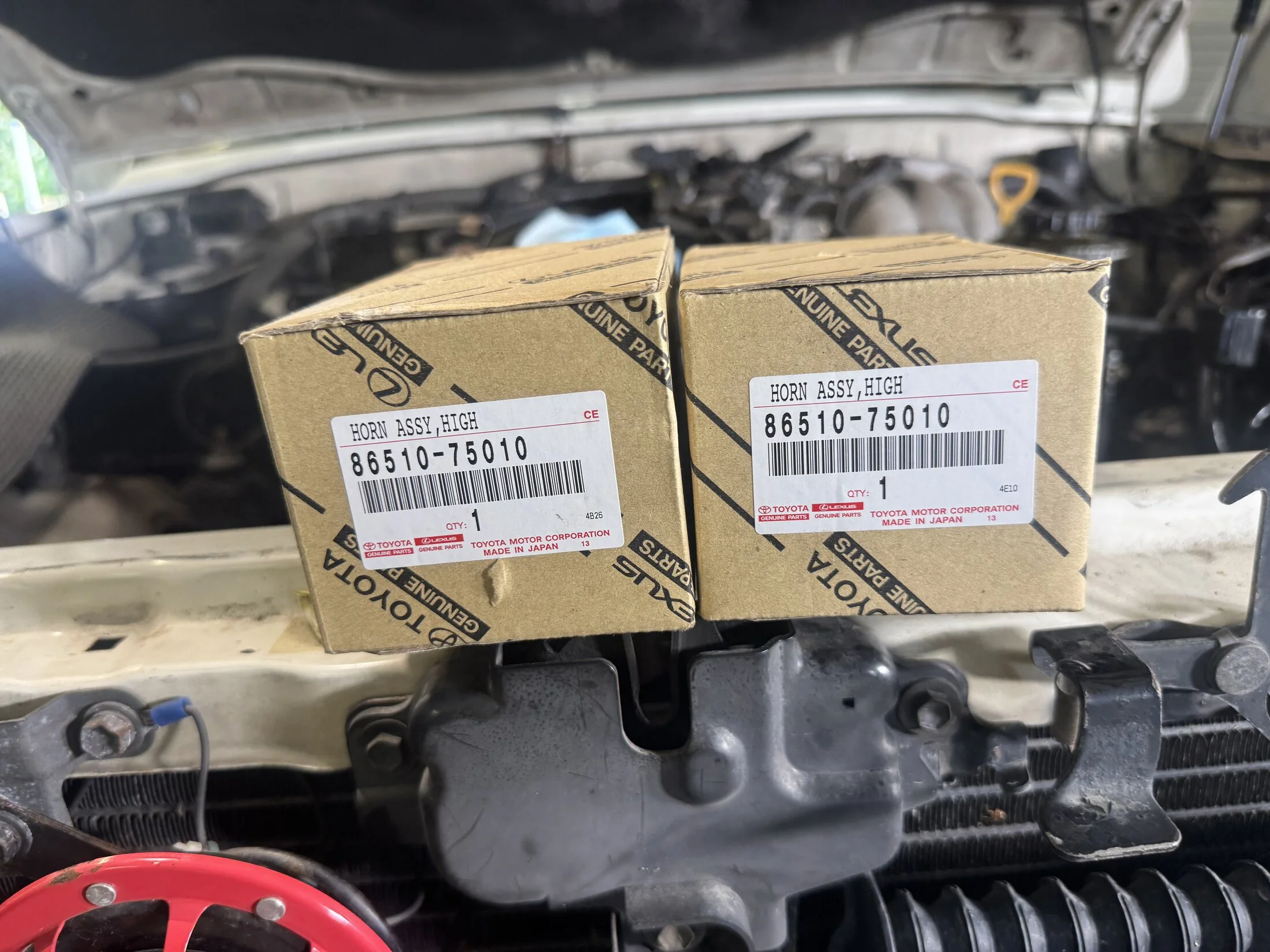

These horns are on deck to be install but one of the old POs hacked the horn harness, so that’ll have to take a seat on the back burner. I have these same horns in my cruiser and like me, they’re loud and proud. Heterosexually of course. Ahem. Just a joke fellas. But not really.

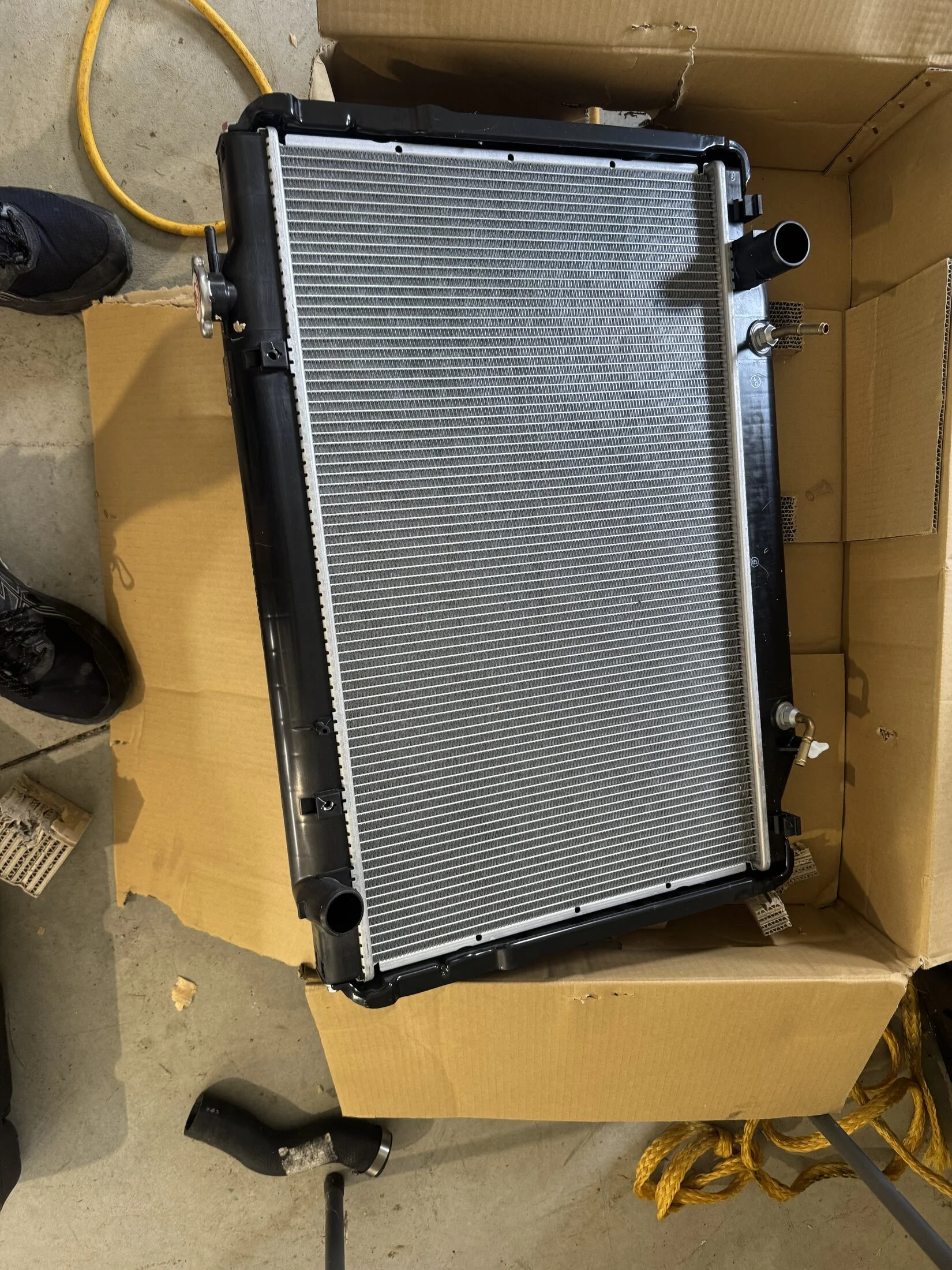

Need a little help…I am missing the long bolts that hold the bottoms of our radiator in the bracket/support. The PO used some janky bits and pieces to hold it in place; I’m not doing that.
BUT for the life of me, I can’t find it in any schematics either. I’m not talking about the shouldered lugs that ride horizontally in the middle. Partsouq is kicking my ass.
Can anyone help a brother out?
Disregard the above. I was out of my mind and literally overlooked the number no less than 17 times.

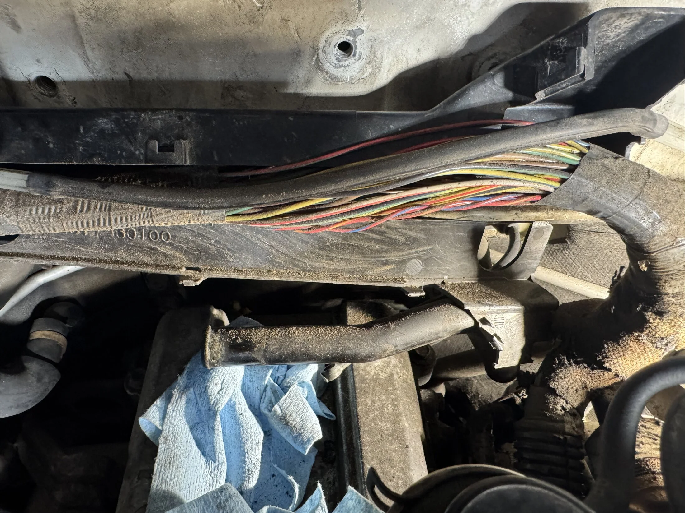

I am working at a snails pace it seems. Today, I worked for a few hours and disabled the EGR via the HuddExpo kit. The engine wire harness has the original wrap that literally falls apart when you touch it. You guys know what I’m talkin about. I wrapped that with some 2000°F tape. An inspection showed no frayed/chaffed/compromised wiring.
Also partly installed the radiator, fan clutch, we fan, rad shroud and am awaiting parts. Need to find those bolts for bolts for the radiator!

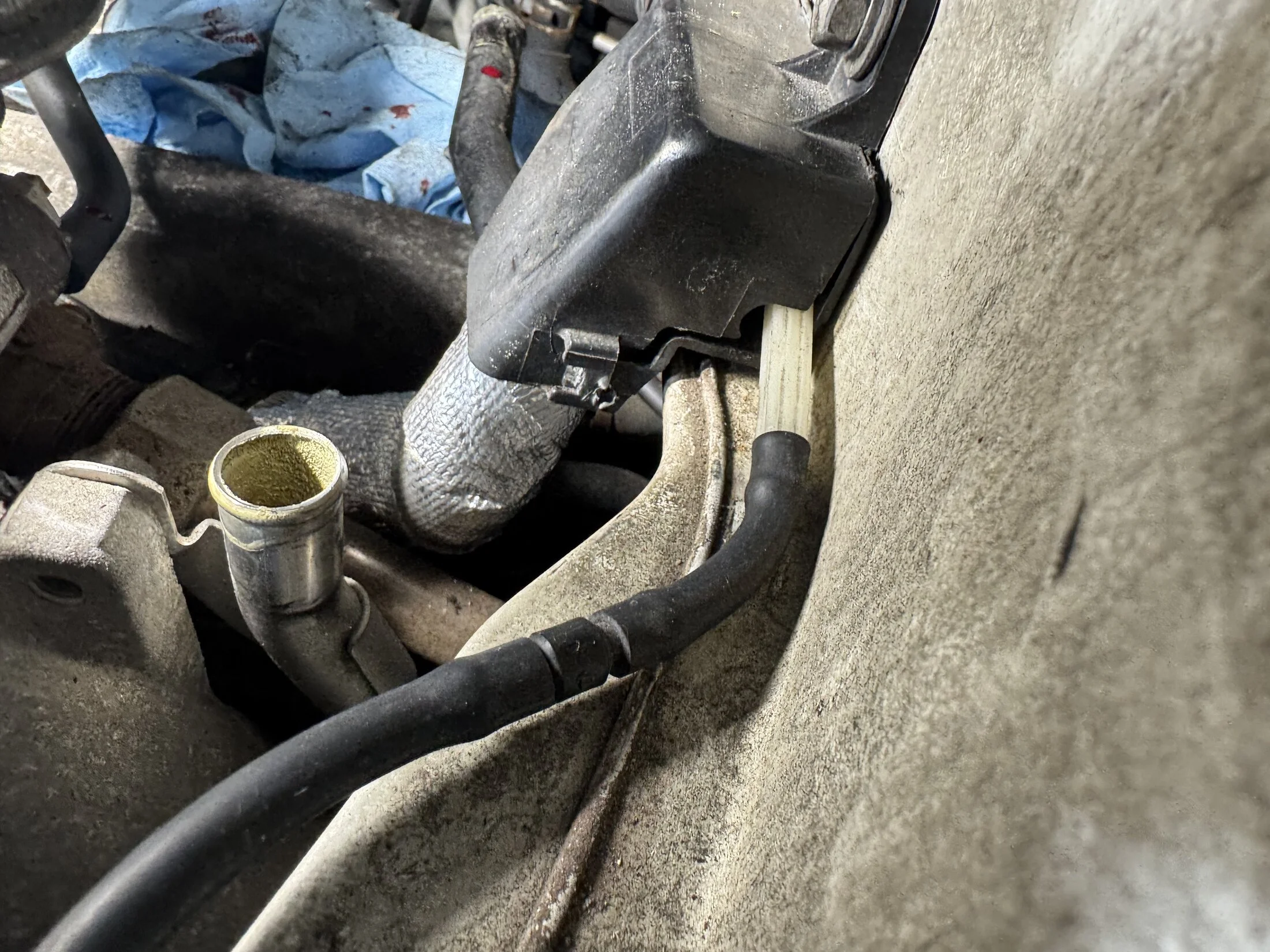

You said your wife-unit smelled the sweet coolant scent. Have you figured out from whence? Looks like you caught that heater control valve just in time, too.
Blood sacrifice?
All of my vehicles have bloody fingerprints in some of the most obscure places,...
Yeah, sliced my middle finger ever so slightly, but bled out like a stuck pig.
When my wife mentioned it to me, I couldn’t smell it. Basically, I checked for leaks, the rad cap, thermostat, head gasket, heater core.
It ended up being a bad thermostat. Was not opening at 180° like advertised.

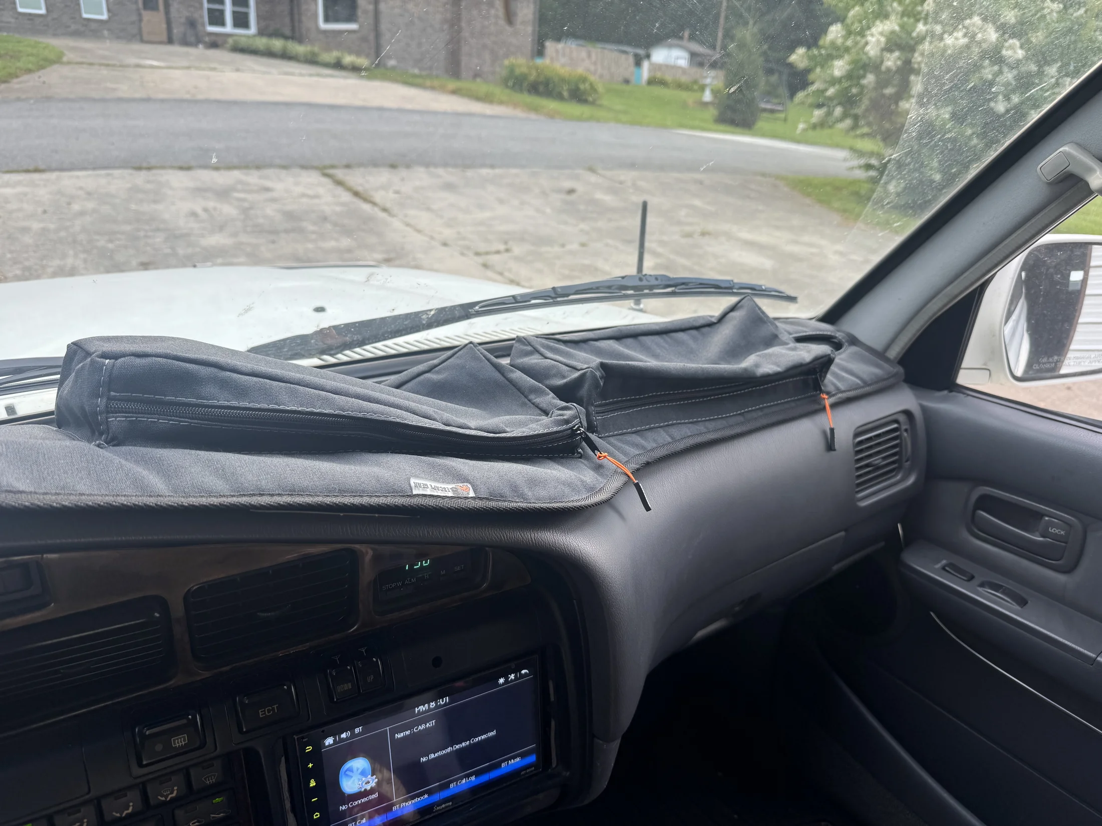

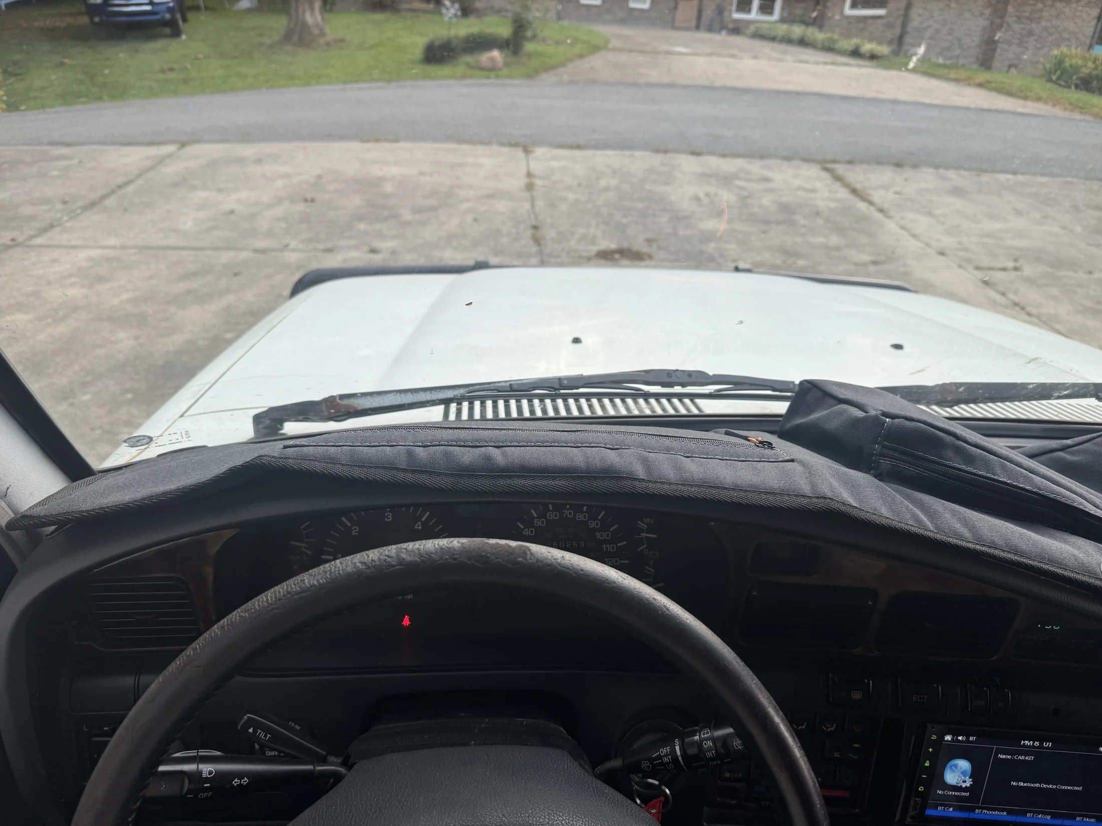

Good day, I fixed the cracks in my dash. It looks brand new and it was a relatively cheap and quick fix. For those of you who have cracked dashes, I can’t recommend Escape Gear enough. Great stuff and great customer service. My son chose “charcoal” to go with his blue cloth interior. Looks fantastic!

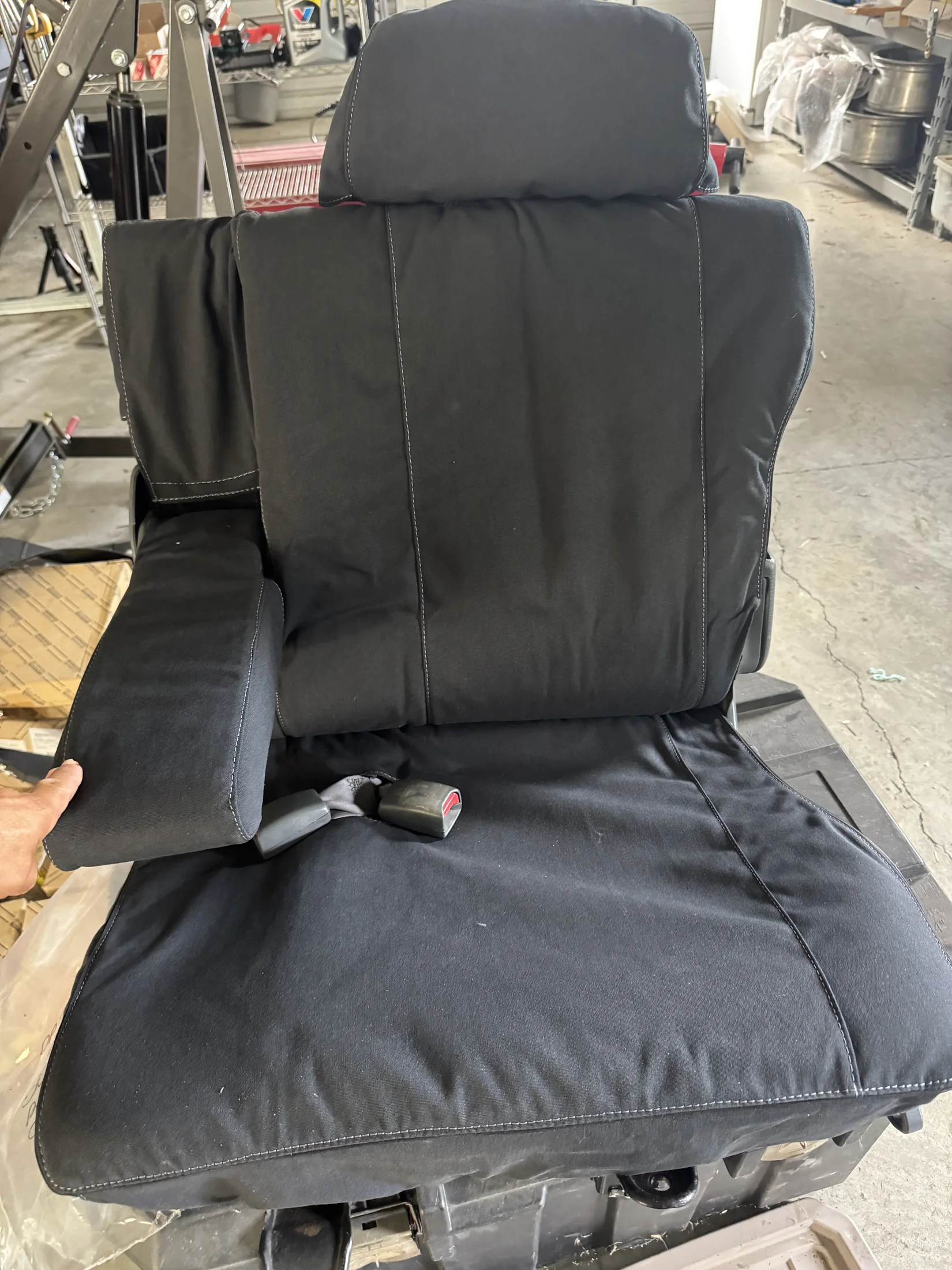

Next up are my seats. They’re cloth so I definitely want to protect the bolster area where it seems to wear holes. Still waiting on the third row. I removed the third row seats, but I’ll wrap them in the escape gear seat covers for more protection while in storage (lmao). I’m sure my son will want to install them when he starts toting his bros around.

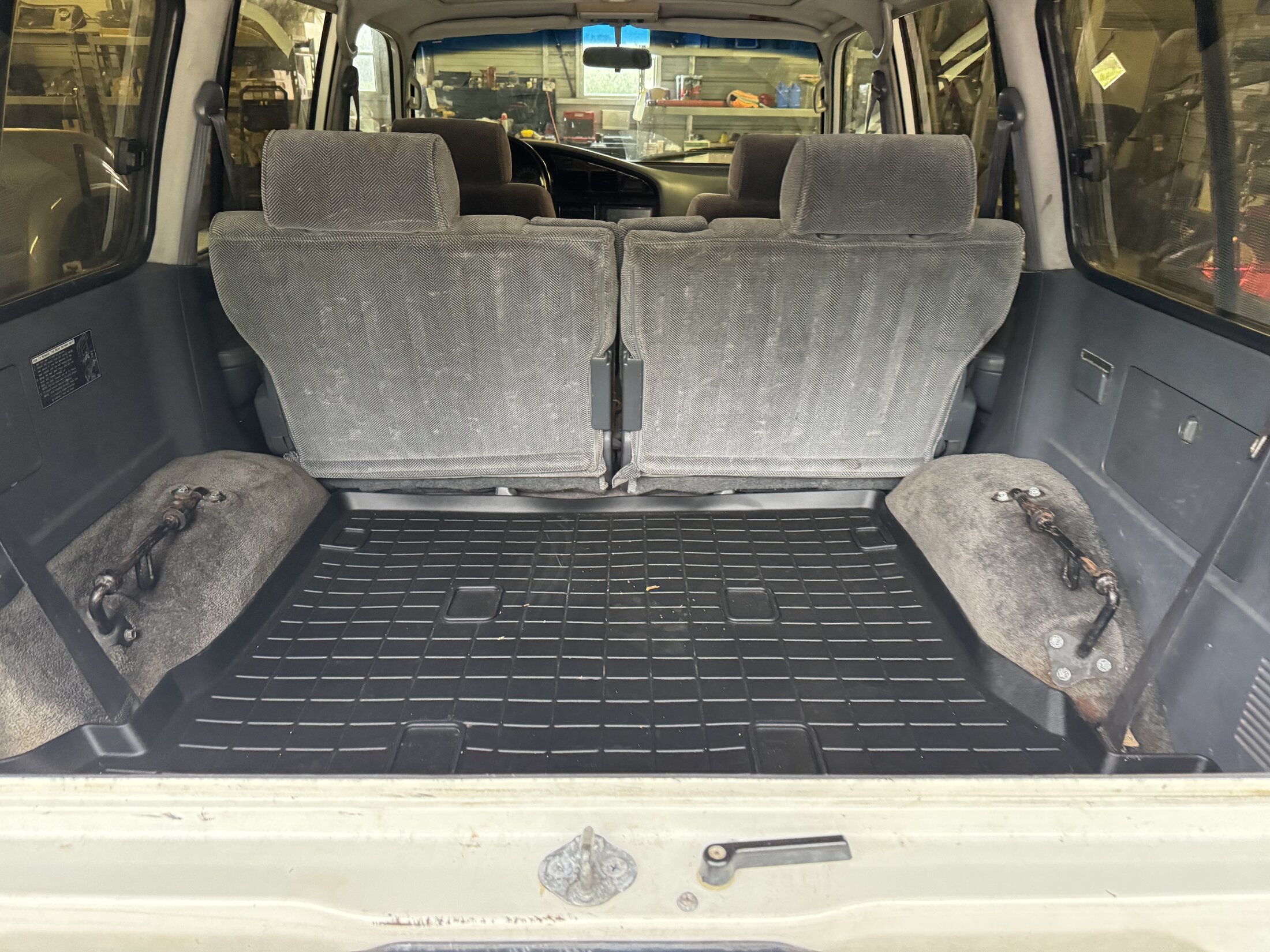

The second row of this cruiser has stripped seat anchor bolts, so I have to clean up the threads or run a tap through it. Gotta buy taps. Yes, I don’t have a single tap. M8-M14 is probably what I’ll buy. Matter of fact, my 94 cruiser also had missing second row seat bolts, though they were stripped like this one’s.
Anyone experience same the thing? Do people often cross thread these seat anchor bolts? FFS, it isn’t difficult. Idk.

Radiator bolt part # that holds the bottom brackets to the big rubber cushions.
9165160850​
9165160850​
Thanks brother. I found it a while back, but forgot to update my thread. I must’ve been smokin some good stuff that day. I stared at the parts diagram multiple times and somehow missed the part number every single time. I would have asked my wife to find it for me, but I’d never live it down. Lmao
