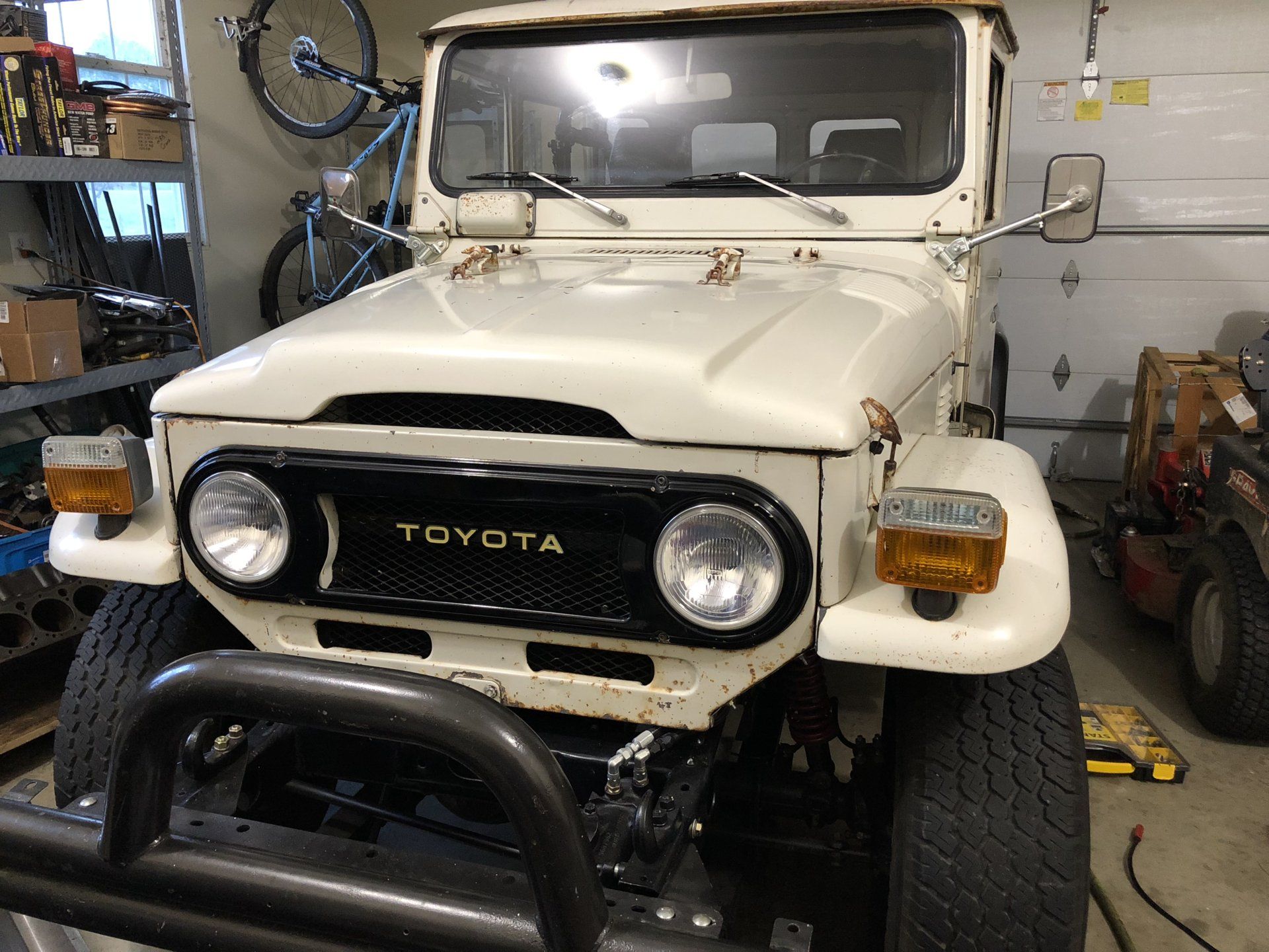

My truck says “Toyota” on the front again.

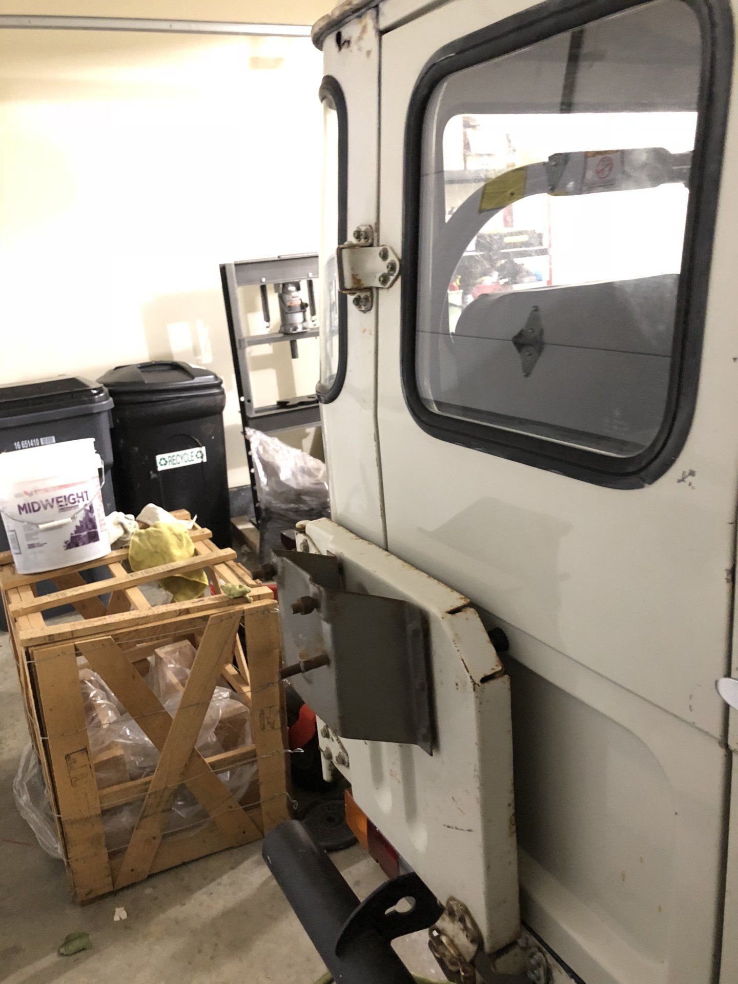

Lastly - I re-installed the spare tire carrier. Partially because I was tired of kicking it around my garage, and partially to prepare for what’s coming next.
Well now, you have an almost complete FJ40! That must feel pretty good, despite the minor issues.
