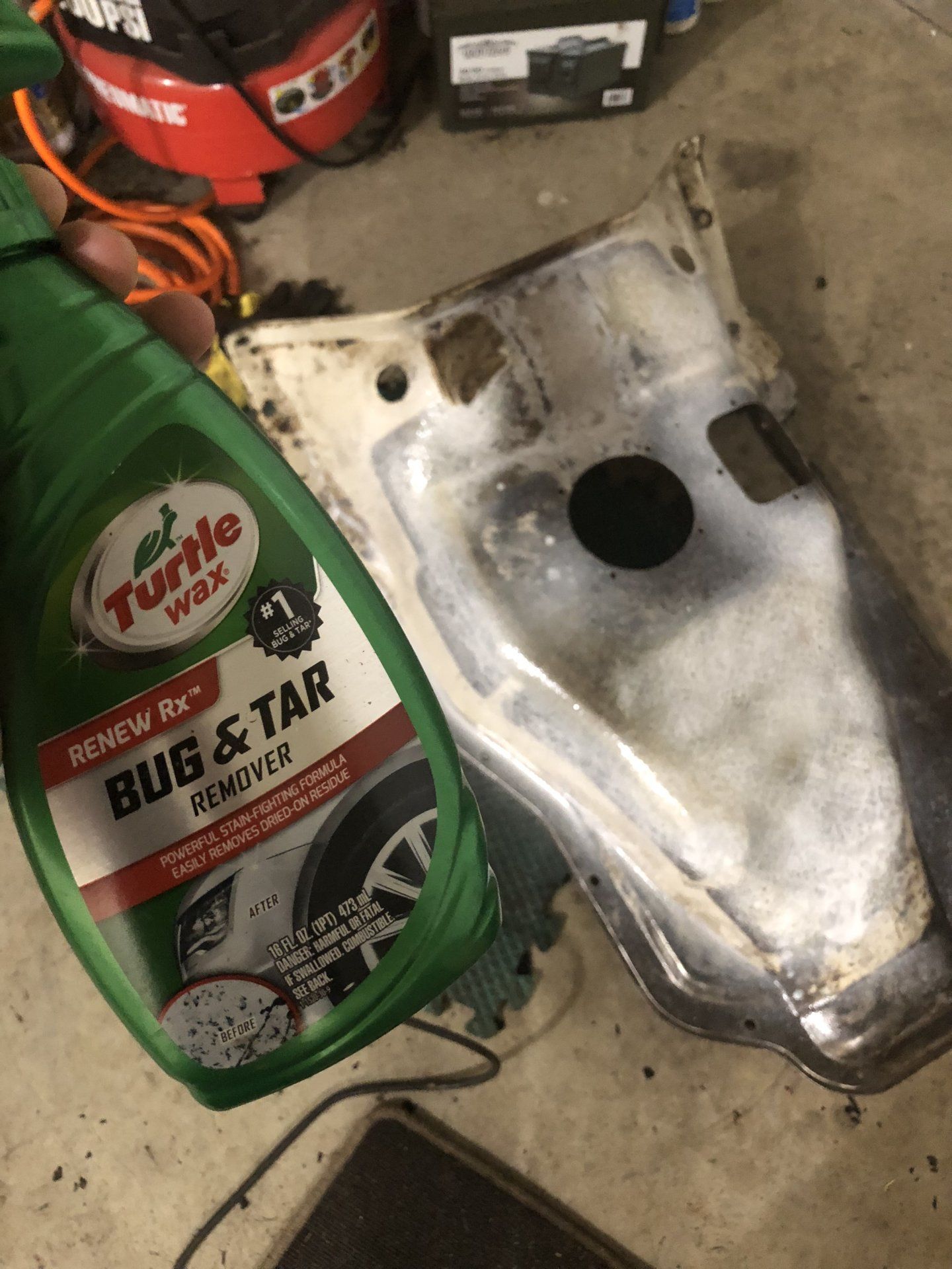

Saw someone using a Bug and Tar remover on the sound deadening/underliner gunk.
Nice progress!
That was me!
Worked like a charm just didn’t post over in this thread.

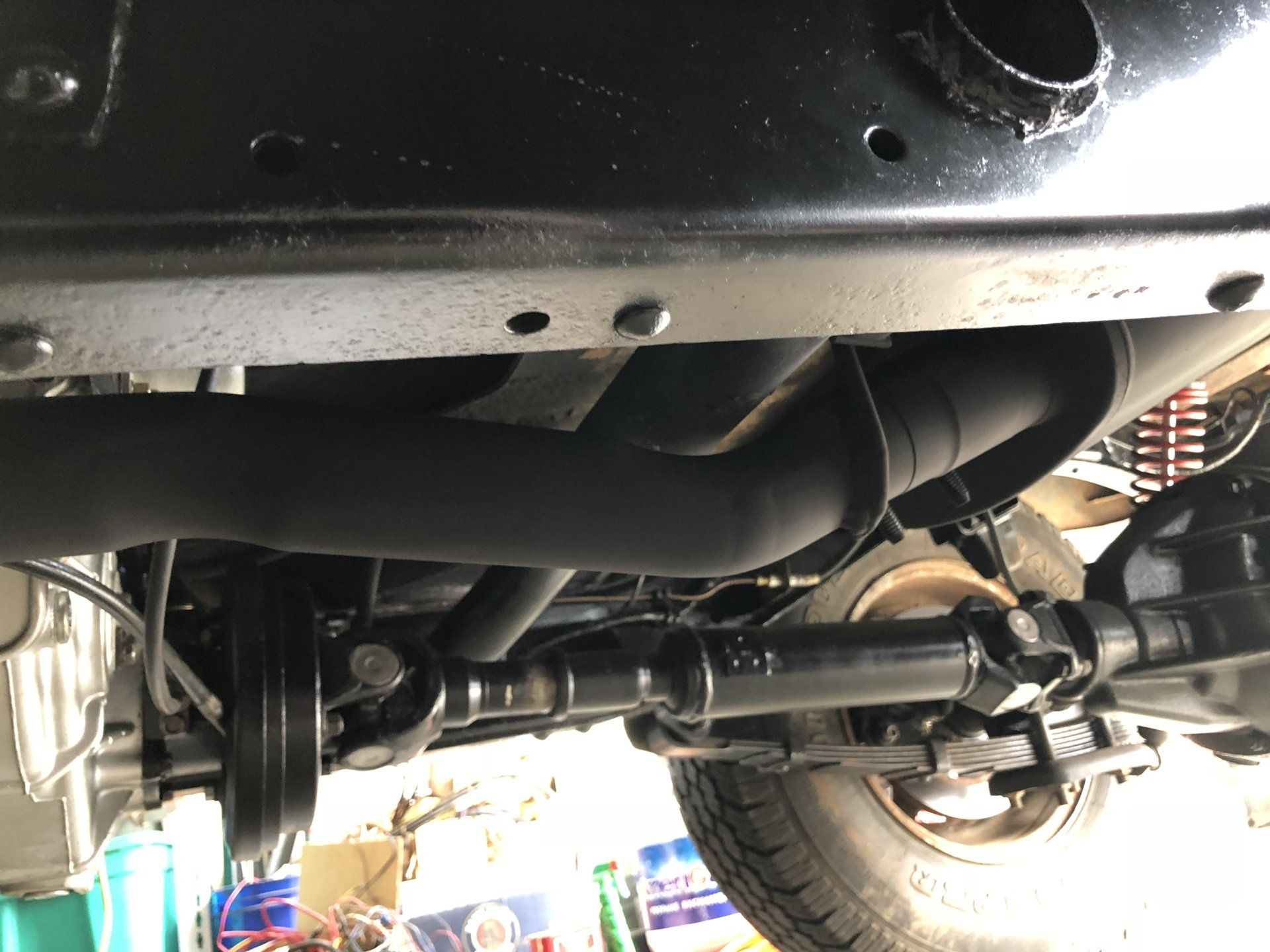

Got the truck back from the exhaust shop today - I’m not really sure if I should be laughing or crying...
On the plus side, it’s much quieter -
The installation looks very clean, as well. Unfortunately, the routing is a far cry from what we discussed...
The good:
I really like the execution of the “jog” around the oil filter - plenty of access to get the filter down and not dump oil all over the pipe.
The bad:
We’d discussed going up and over the torque tube, and it wound up going under, which puts it a touch below the frame rail...
Maybe going over just wound up not being an option (though I’ve seen this done) but, he then went outboard with it and through inside the rear shock mount (as opposed to down the frame rail as discussed)
This, in itself, is also no big deal except there’s no way I’d be able to mount the auxiliary tank again. I had been leaning away from putting the aux tank back in (it’s a bad design and probably unnecessary for my use) so again, probably a non-issue.
It exits behind the rear wheel, but we had also discussed a 45-degree turn-down and it goes straight out...
We’d also discussed a second flange near the muffler so I could drop the middle section of pipe out if need be for maintenance/if I crushed it. It wound up one solid, welded run.
In short - it’s not bad at all, it’s just also not what we discussed...I’m not sure it’s bad enough to ask them to do it over, though I feel like I’m letting them get away with murder...

While it's not what you asked for, the guy did a nice, clean job on the exhaust. Everything else is looking really nice!:clap:
Long range tanks are over-rated unless you are into expedition travel or live in CA and go across the border for cheap gas. I had one and took it out to save weight (about 150 - 170 pounds - full). You probably won't miss it.
"Clunking" could be from the rear end as part of normal wear and tear. Either a worn locker or too much backlash. Also worth considering - excessively worn carrier bearings that are allowing the carrier to move laterally when load is applied. The last item will definitely cause a clunk but can be easily checked by pulling the rear cover and using a bar to see if the carrier can be moved side to side (it shouldn't)
Back to the exhaust, there is definitely room to do it the way you wanted. IMHO, I would ask him to make the change and kill two birds with one stone; move the pipe over the tube and add a flange for servicing. There's PLENTY of room to go over the torque tube, in fact, there's room to go down both sides of the engine and transmission AND over the tube. While I no longer have the tube in it's original location, you can see the remnants on the D/S frame rail.
Not the best picture, but he can see there is plenty of room to get it right and stay above the bottom of the frame rail.
Yes, I’m nit-picking because for the amount of off-road this truck will likely see, the chances of my exhaust being crushed and the need for an aux tank are nearly non existent. Really - it’s a nice clean exhaust run, and I’m happy with the sound.
My only complaint is that we discussed a plan and he didn’t stick to it. I want to complain for that reason alone but I think I’ll just live with it. It’s not a hill I’m willing to die on....
