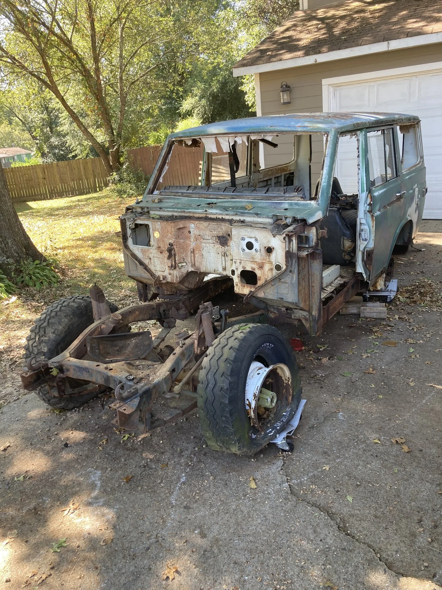

Matt (@DirtDauberGarage) and I went in on a parts 55 to assist with restoring our own 55's. (Mine is not-so-cleverly named Moose). We divided up the parts we needed and then sold or gave away the parts we did not need.
And this is what we ended up with:

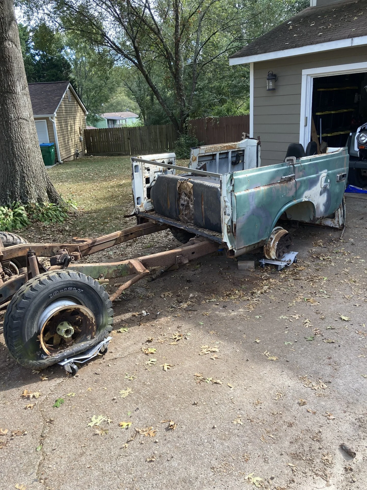

It felt like a shame to drop the rest off at the recycler. As Matt and I were saying our goodbye's to the "carcass", Matt says " You said you wanted an off road trailer. That's what you should do with the remains". I loved the idea. In fact I was so excited I nearly showed emotion. After compiling myself, I started cutting and ended up with this:

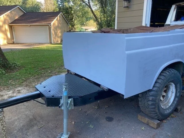

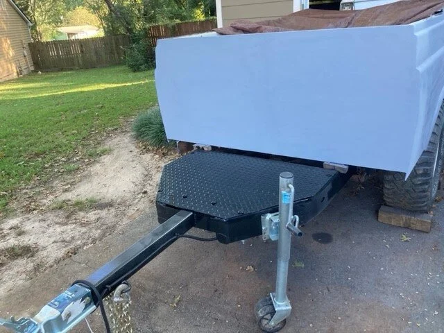

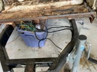

The frame is in really good condition so I began cutting, bending and welding to make the tongue area. I used 4x4 steel and 5,000 lb posi-lock couple and a heavy duty trailer jack. All hardward is also grade 8. Also began wiring for the trailer lights. I plan to wire into the OEM rear lights.

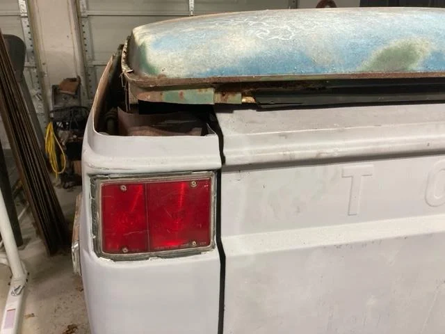

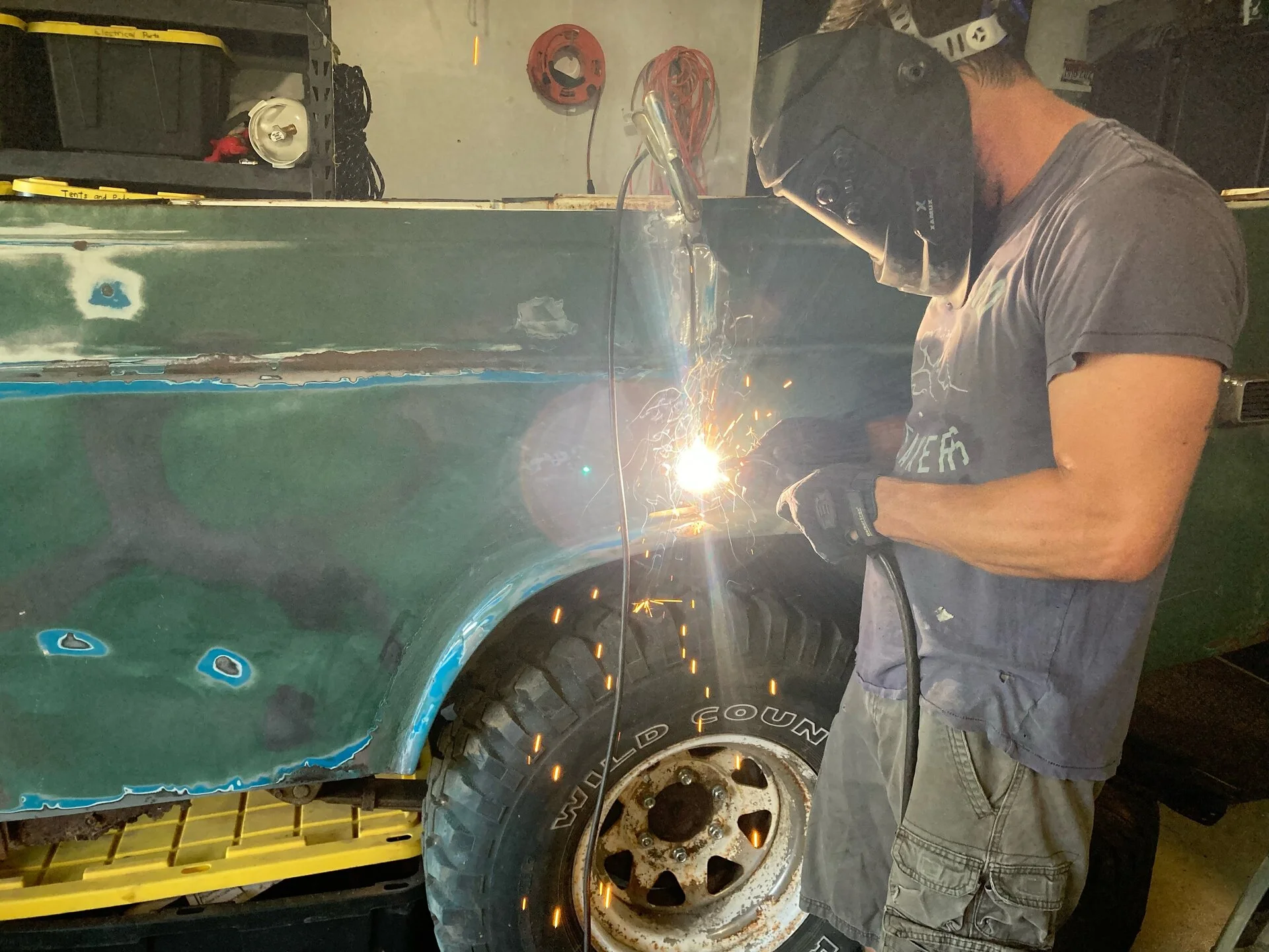

Next comes the hours of welding to seal the rear doors to the rest of the body and sand down the entire body and prep for primer:

I got a piece of steel for the front part of the body and welded it on and some plate steel for the tongue area:
On top of this plate steel I will put a locking box and a mount for a propane tank. Making some great progress as I move around the exterior.

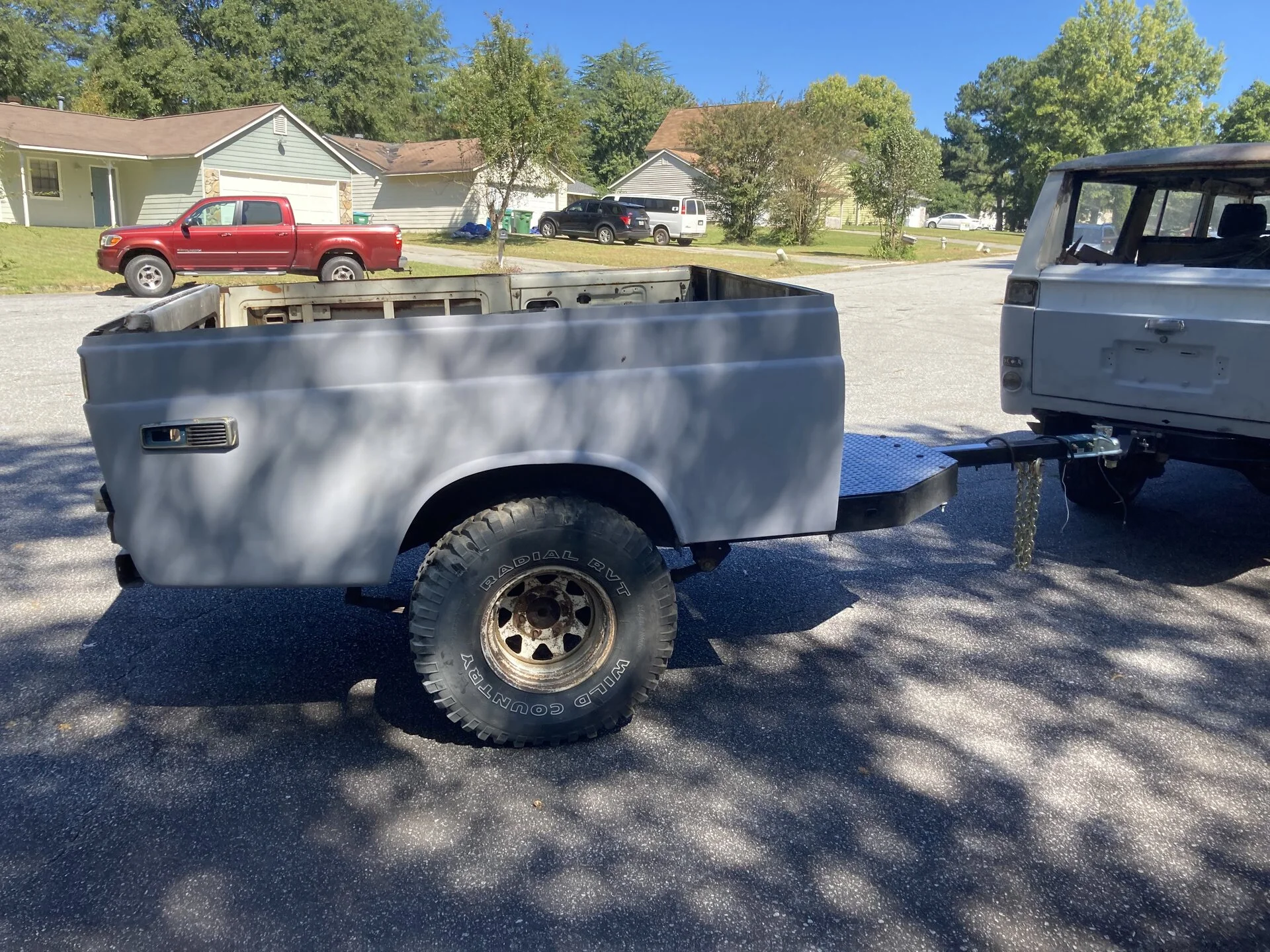

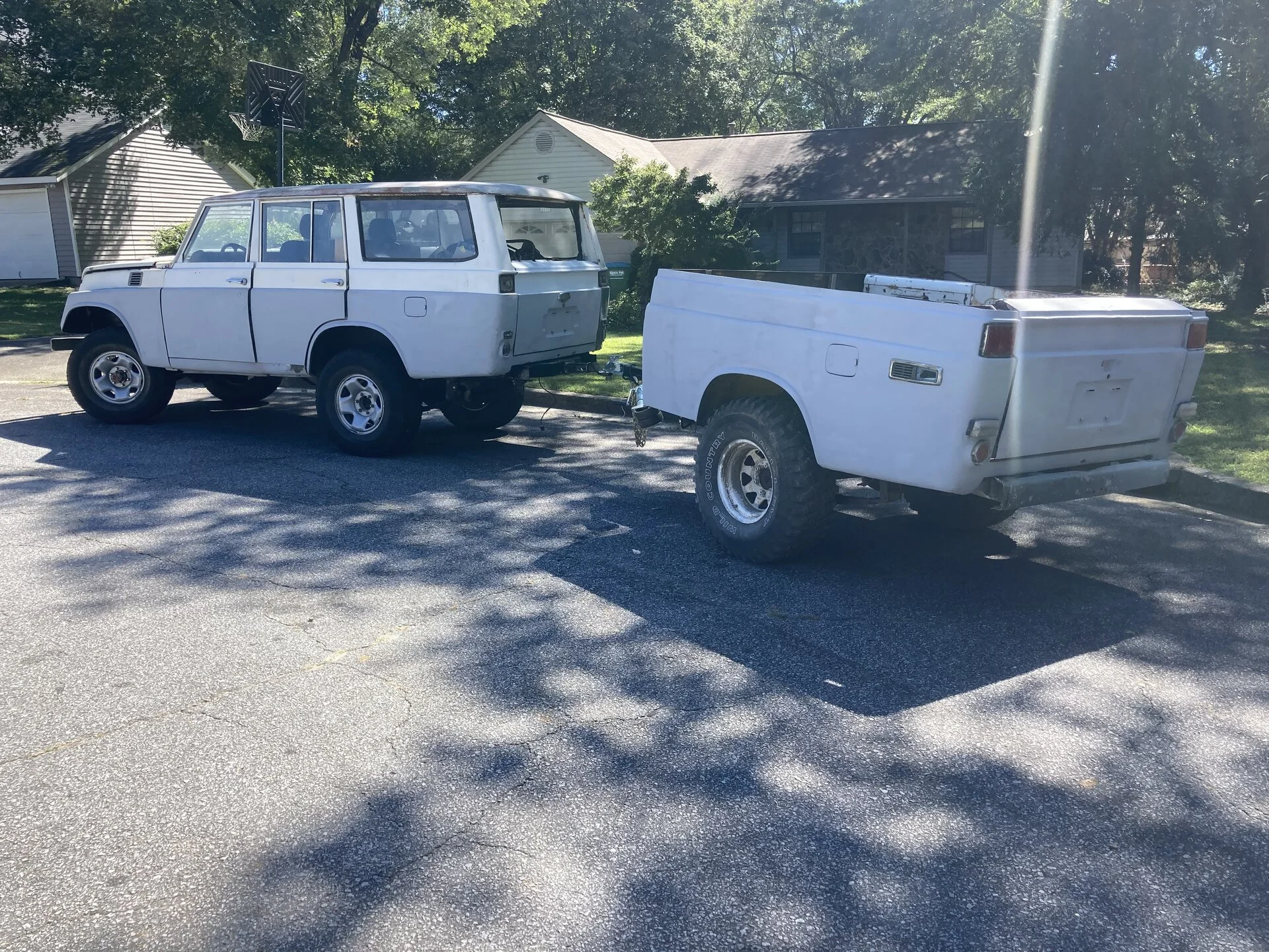

I have "finished" the exterior body work so. The rear tail gate is pretty rough so I did not spend a lot of time on it, mostly just patched the bullet holes, rust holes but left the dents alone for the most part.

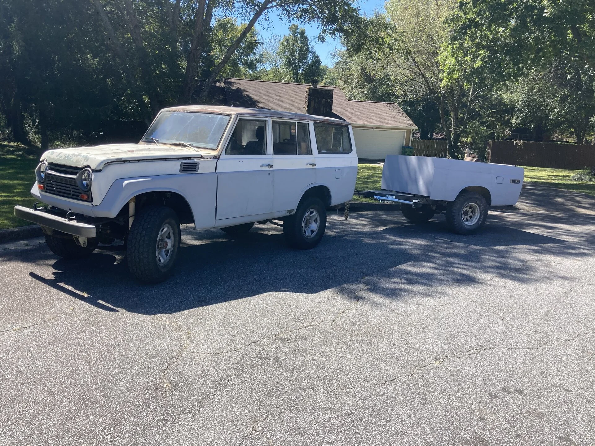

Thought I would put calf behind Moose and see how they look together:
Next is to complete the wiring for the lights and then begin working on the interior. Got to spend some time on Moose too.

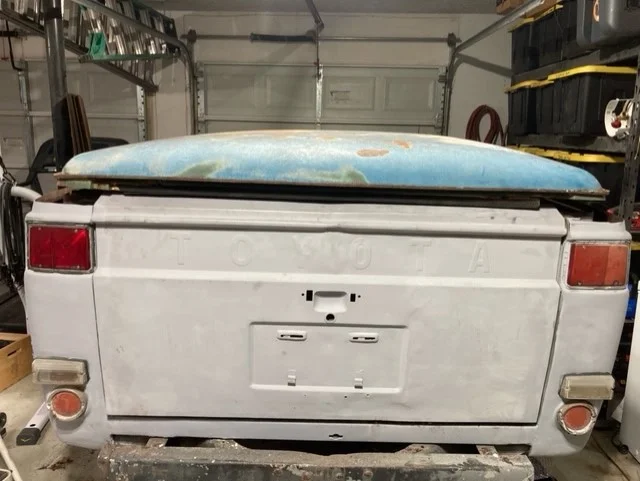

I completed the electrical wiring a few weeks ago so that the taillights are connected into the trailer wire pigtail. Very straight forward. Now its time to work on mounting the OEM top to the trailer. I had not realized that the top is smaller than the body. About 4" narrower. I guess that makes sense, but I was not expecting it as I was lining it up. I knew I would have to shorten it and committed to that but now having to widen it 4 inches is a bit much. I think any other type of retro-fit would look goofy. I was already reluctant to cut up a good condition 55 roof. Decisions decisions... I'll probably spend too many hours just staring at it in the garage figuring out what to do. But always willing to take suggestions:

How does a 40 Series cap measure out…closer?
That is an interesting idea. I'm not sure what the difference is. But now I am curious. The width of the 55 top is 58" from gutter eges.
40 Series top is 64” wide at the rear and 57.25” at the front. Total length is 82”.
Taper starts where the rear edge of the front doors meet the leading edge of the hardtop side panels. Not sure on that measurement.
The 40 top being that much wider is surprising. Although the amount of taper would make this trailer top a little awkward. Thanks for the dimensions though.

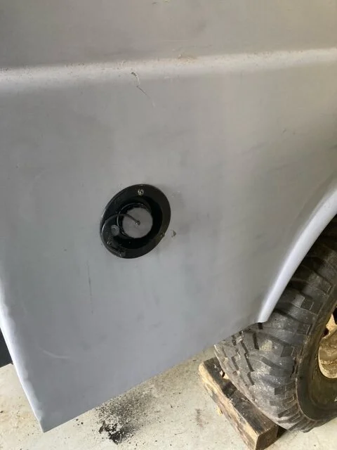

Water tank: I got a 7 gallon RV water tank that fit perfectly on the floor board at the front of the trailer without having to cut into the metal. Added a water fill port on the driver side of the trailer as well. The tank will be connected to a pump that I am installing on the frame rail.

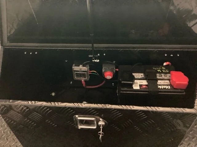

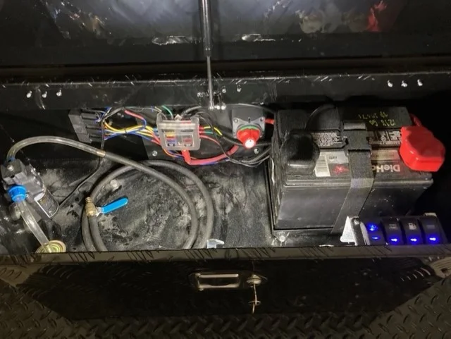

Tongue tool box: I added a locking tool box on the tongue area. Inside I installed a battery and got a piece of 1/2 thick abs sheet and put in a battery cut off switch and fuse box. I ran wiring to inside of the trailer to install an aux power and USB ports. Next will be to build a switch panel that will control the water pump, the fuel transfer pump and exterior lights.

Water port:

Tool box/ power station:
What seems like small updates took a lot of work to get to this point. First was finishing up (minus some small adjustments, securing wiring and cleaning the dust out) the toolbox. I have the switch panel wired up that controls the water pump, the fuel transfer pump and lights inside the toolbox all of which are already installed as well. With one switch to be used for something else down the road:

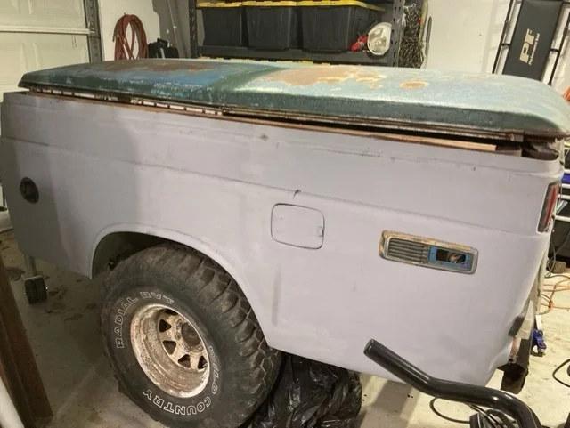

I also shortened the OEM top to be the needed length of the trailer. Lots of measuring, welding and grinding. Have some filler on to make sure it is smooth. Next will be the endless hours of sanding on the top for primer. Also need to install the hinges and gas struts.
